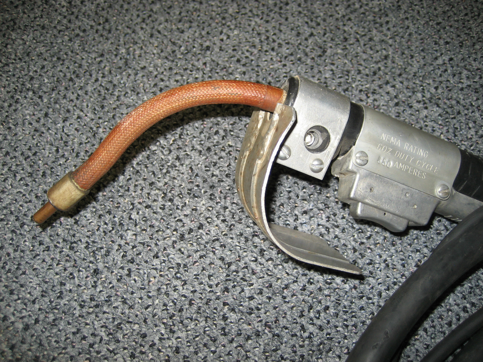

Are you running self shielded flux core with a regular Mig gun? If so you'd be better off to remove the nozzle, and protect the diffuser some how.
Here is what a dedicated shelf shielded flux core gun looks like.

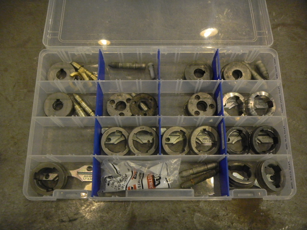

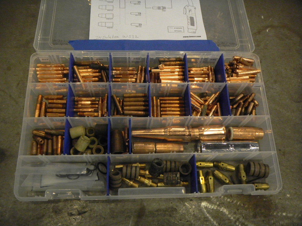

I change contact tips like Arc weld says when they get ovaled out.

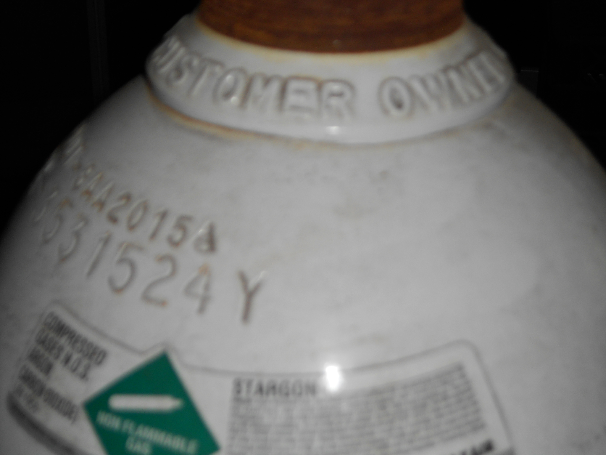

The bottle in the pic shows the type of gas.
