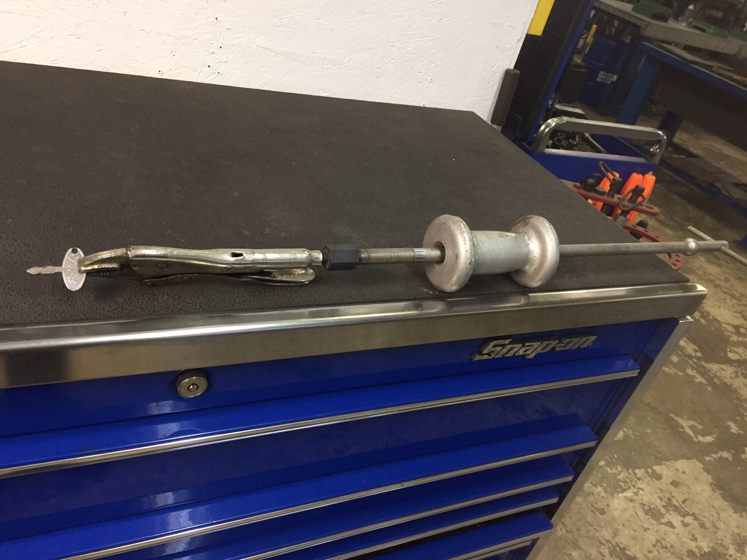

Regarding your stuck key:
Penetrating oil, vice grips and a slide puller worked for me on an old truck mount (piggyback) forklift I bought.

Thanks I will give that a try.
