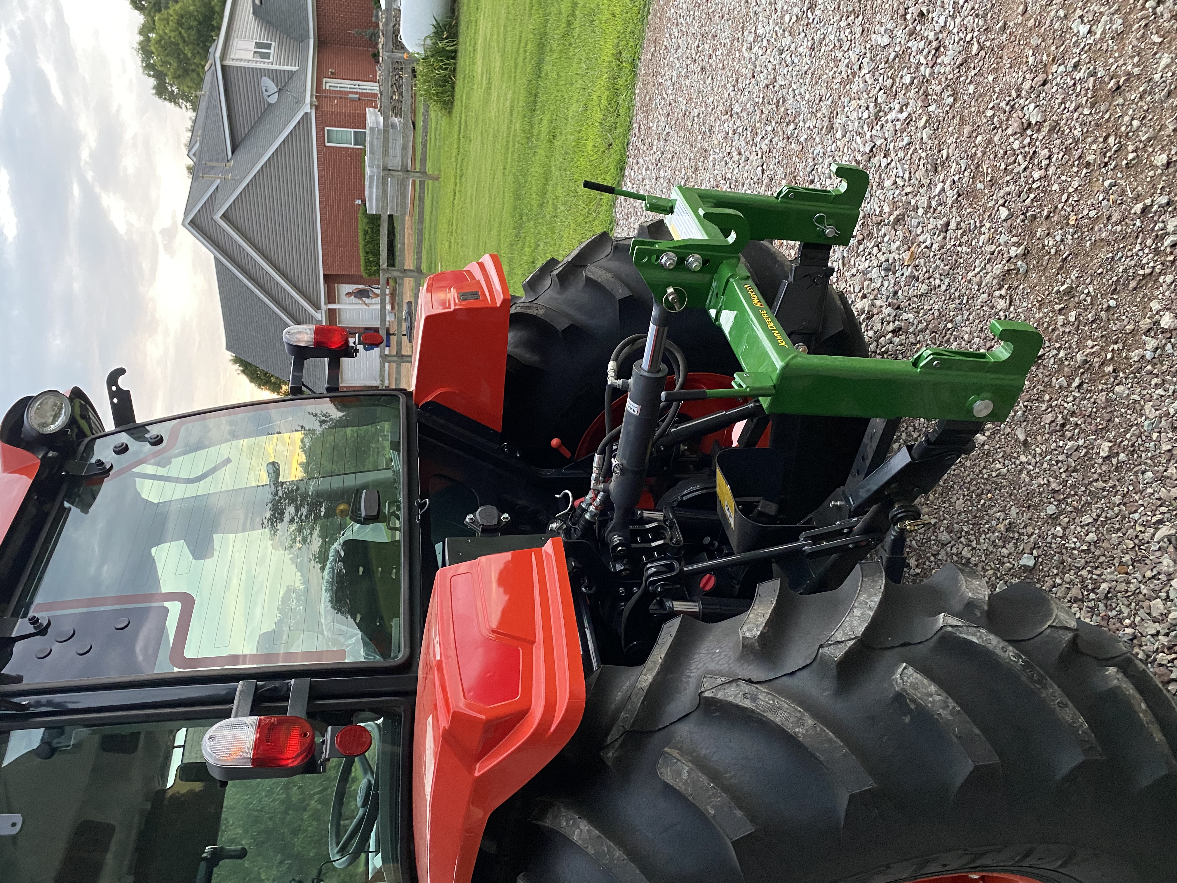

Is there a quick hitch that will fit cat 1 implements that will fit on a cat 2 tractor. My Imatch is only 1-3/8 wide where the lift arms fit and my new holland tractors have cat 2 lift arms that have 1-3/4 wide lift bushings. I don't want a cat 2 width quick hitch as the cat 1 quick hitch will fit all of the cat 1-2 implements as well as the cat 1 only stuff. I have looked around but haven't found anything.

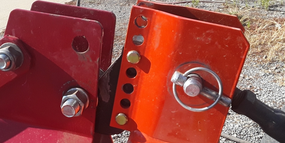

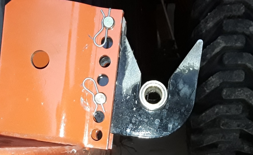

EA49D914-187F-416B-81E0-E94399ECE51F.jpegI have extendable lift arm ends so they were easy to take off. I used a cat 1 to 2 bushing clamped in my vice and was able to rig up my ball ends on the bushing to hold them square. I ground some off each side with a 7 grinder.
Used cat 1 to 2 lift arm bushings and installed as normal.

Some cat 1 quick hitches will have enough space between the mounting ears for a cat 2 lift arm.

View attachment 666546I have extendable lift arm ends so they were easy to take off. I used a cat 1 to 2 bushing clamped in my vice and was able to rig up my ball ends on the bushing to hold them square. I ground some off each side with a 7 grinder.
Thanks, both tractors have the extendable lift arms so I can do the same, I just hate to grind on the tractor lift arms if i can find one that will fit.
This is what I am looking for, do you know whose is like this?

Just to be clear, you are only grinding each side of the ball itself, not on the arm. Grind them flat and parallel, you don't have to take much off.
I could not find a cat 1 quick hitch from any of the usual suspects with enough clearance to fit a cat 2 ball.
I have to give it to John Deere on this one, my 5105 has cat 2 lift arm balls that are narrow enough to fit a cat one quick hitch.

when I rough measured both the NH t4020 and Workmaster 55 both them are 1-3/4" through the ball. the Imatch that came with me JD4320 is only 1-3/8 wide so i'd have to take 3/8" of the ball, that just seems like a lot, I was hoping someone made one with a little wider slot.

The lift arms may be designed to have replaceable balls, if so get cat 1 balls for lift arms.
