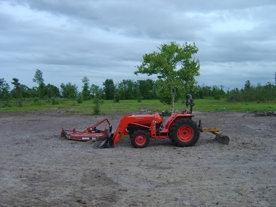

I have lots of broken tree limbs from hurricane damage, plus I just had a section of my property cleared out by a big trackhoe. Now, I have big pieces of tree trunks, stumps, 4 ft logs and lots of smaller stuff mixed in with dried up mud on a very rough, uneven piece of ground. The idea is to scrape out the wood stuff without dragging too much of the dirt (which I plan to smooth out).
I have access to a 3ph landscape rake. Will the tines on that rake handle the big stuff?
If not, does anybody make a 3ph rake with big metal tines maybe six inches apart that can drag heavy stuff?
Thanks in advance for sharing your knowledge and/or experience.

Looks like you have a box blade. I use the rippers on mine as a rake with the box rolled forward to minimize dirt collection. Large items like stumps get the chain. If you have lots of large material that you want to keep clean as you stack it into the burn pile then it may be time for a grapple.
