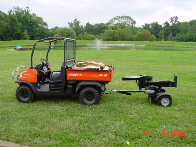

Here is my RTV with about 900 pounds of wood in the back and towing my log splitter. It had no problem at all pulling this load out of the woods and up a few fairly steep hills. I can honestly say that I couldn't hardly tell that I had any load on it.

Dargo,
Nice yard!!! No roof on your machine?
Hmmm. I might be overloading my box. I keep my tailgate down and put 3 ranks of wood in it. Using 16" logs, I put 18 of them in. What do you think, that's about 1500-1800#? /forums/images/graemlins/shocked.gif They stack to about 1/2 way up the cage. (2.5' from bottom of box) I noticed my steering feels different but haven't had any problems hauling/dumping.
