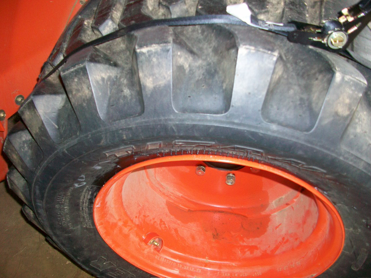

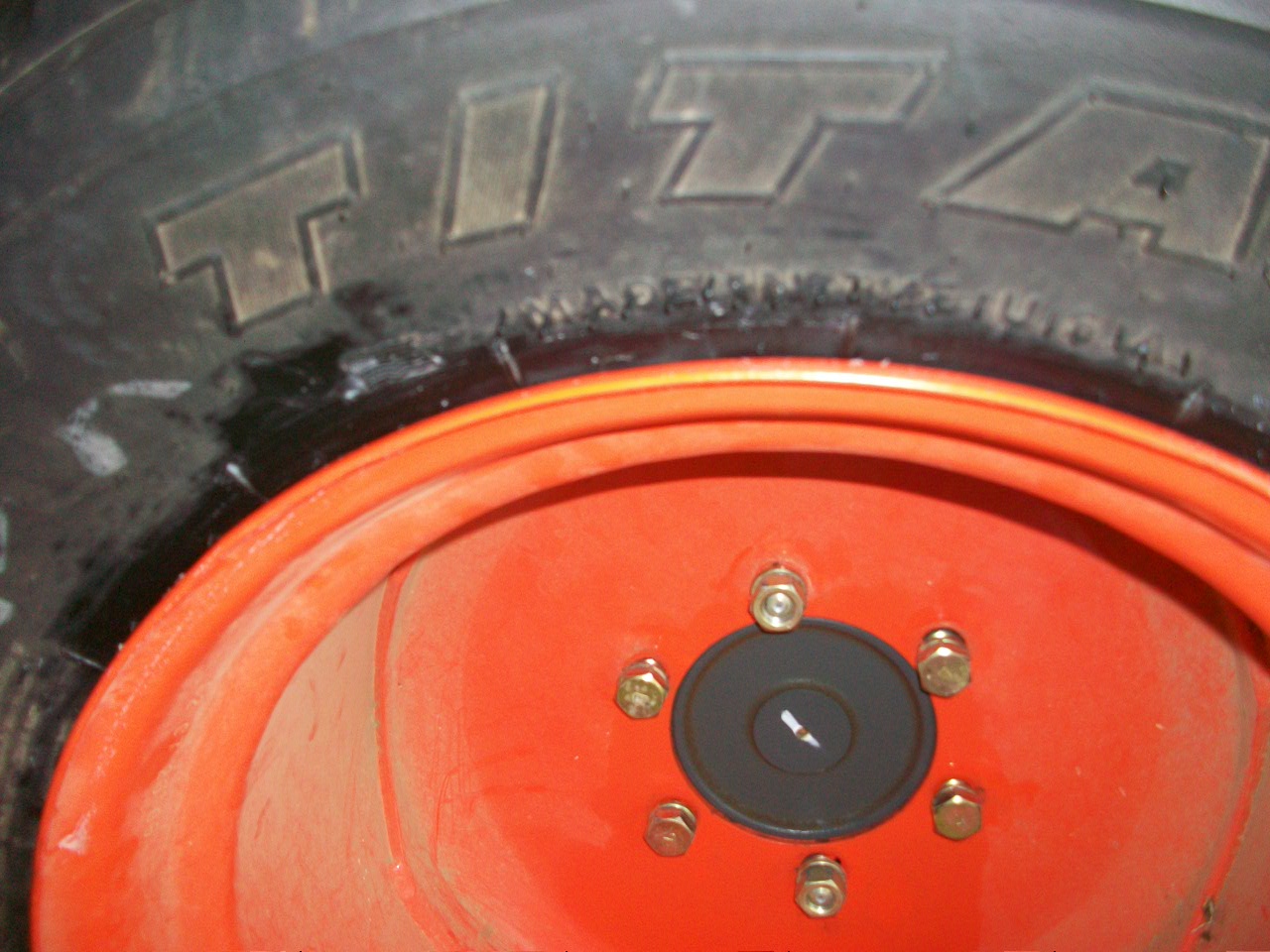

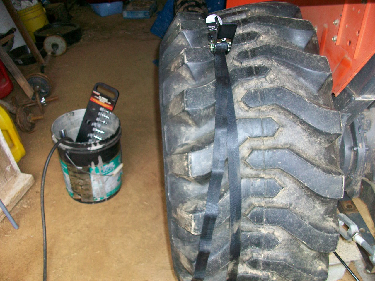

My rear tire went flat it has been leaking a little bit meaning every month or so I would need to add some air to it. Well this week it went all the way flat and the bead broke. I have attached a few pics but I can not get it pumped up. Will the bead sealant work or should I continue to try and get the wheel off. I have the bolts lost but need a few hints on how to get it off.

I have had the same thing happen to all of my tractors except the Kubota so far. I used the same technique you are attempting, it just appears you don't have the right size/power strap as you need more compression to move the sidewalls out.
You will need a pretty high volume tire compressor.

Just thinking out loud here, before you call the tire guy...if you have a compressor of any size here is what I would try....get someone to help you and find where between the wheel and the tire the most air is escaping when you try to fill it...then have the person helping you use a plastic garbage bag or something like that to hold over the area where the most air is escaping and hold it down tight and then give it as much air as you can ..it might just be enough to snap a the tire back to seal against the wheel..it worked for me once .

R4 industrial tires have an awfully tough side wall. Using a strap or chain will be hit or miss whether you will succeed. If you have a local truck tire dealer around take it to them. The last one I tried myself I spent over an hour trying it by myself and even with the help of my brother in law did not succeed. I finally gave up and took it to the local truck tire center. They used a beat blaster, and within minutes I was on my way home. Cost me ten dollars cash. The hour I wasted trying it myself cost me a lot more than that. If you absolutely can't get it off the tractor, then there are mobile tire services that can come out and fix it on-site.

Put a ratchet strap around the tire and tighten it down so the outside balloons. Use an air compressor and fill er up. This should seat the tire.
/ Rear tire needs air #11
And don't forget to take out the valve stem. You can get more air in faster and relieve the pressure faster to take the ratchet strap off after the bead catches.

From the looks of your picture your strap is towards the out side of the tire. Always worked best for me to put the strap in the middle of the tread, rachett the tar out of it and than apply air. With the strap towards the out side I bet you'll never get it tight enough to make a difference. Might also need a bigger strap. I use 2" or bigger.

if you arent setup for, or have experience in mounting/dismounting large tires, your way better off letting someone who has the tools to do it right. R4 tires have a pretty tough bead to seat, not usually something you are going to seat w/a ratchet strap, especially that 'lil guy you got there. ive mounted thousands of tires from lawn mower to 12ft tall loader and haul truck tires; they are never fun, especially without a bead blaster
