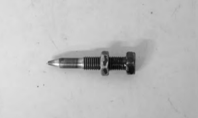

It almost sounds like the problem is the brakes are being engaged when they shouldn't be. The brakes need hydraulic pressure to disengage them so is it a brake related valve/solenoid that is bad? If that is the case, the rear brakes would engage and you would get the warning that the F/R wheels are not turning at the same speed. The early Toolcats had brakes that you could manually disengage by screwing in special bolts to press against the springs. It would be interesting what would happen if you had those bolts installed in the rear.
