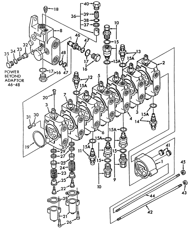

It appears I have blown and o-ring or some other bypass spool because the backhoe is not as strong as it has been. It will not load up the engine when I put it in a bind like it should. The loader is still as strong as ever. Any ideas where to look first?

Sorry, thought my signature would explain that but maybe it doesn't show up-it's a Ford 555D 4x4 extendahoe w/ 4in1 bucket. The machine is in good shape and this is something that has recently come light while I had it rented out on a job.

The main relief valve is in the loader valve. Since the loader is fine, I would assume the relief is ok.
As for the BH, if only one function is affected, look into a linkage problem (valve won't move fully), or a cylinder issue (bad piston seal) or a circuit relief valve that's NG.
If all functions are weak, then one of the many valves in the outlet end cap has failed. That's the cap on the lefts side of the valve stack. It has an unloader valve, and a back pressure regulator valve. Probably the unloader has stuck open.

All functions are affected including the outriggers so I'm going to the unloader valve you spoke of. Thanks and I'll let you know how it goes. BTW, I have a shop manual specific for an older backhoe (555) and I'll look to see how similar/different they may be in this regard like I've done numerous times before.
