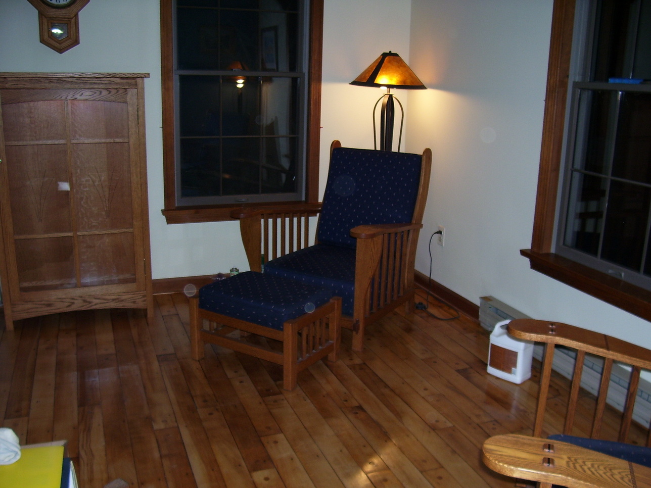

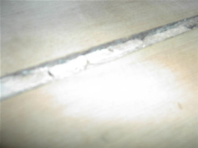

I'm in the process of refinishing the pine floors in our 130+ yr old house, and i need some help.
There are some good gaps between some of the planks. There is some type of filler between the planks...... which appears to be plaster. The same plaster in the walls, which, on the walls is mixed with horsehair. There are alot of areas where the plaster (or whatever it is) has chipped and fallenout of the cracks. Last year i did a small room with hand sanders, working on my hands and knees. No more of that ! Now i'm about to do the diningroom, and have purchased a used orbital floor sander from a rental place. I need to match the plaster that is in the floor before i urethane it. In the room i did last year, i used plain ole joint compound. It doesn't look bad, as there were only a few spots that needed to be filled. However... there is much more to fill in the diningroom, and i think the joint compound trick will look too "white" for that much patching.
I'm hoping someone here has gone through this..... or maybe has been a professional floor refinisher ! I'm thinking about trying wood putty. I know that could be stained with a tiny brush to darken it up a bit if needed. I'm using a clear urethane, and not staining the floors at all, so they will have a natural golden brown color.
Can anyone offer me good advice ?

Oh..... i almost forgot. I meant to post a couple pictures of the floor, if it'll help .

my farm house was built in 1740 - it has WIDE flooring (smallest board is 22").. commonly referred to as pumpkin pine. the flooring project was the first phase in restoration (this is my 3rd flooring job, but the first with pine - all others were either maple or oak).
i used the large belt sanders in combination with the small orbital for corners. in my situation, the floors were NEVER sanded, but they had been painted. most (but not all) of the cracks were filled with plaster. during my restoration i used the plaster (i found it matched the existing sections perfectly once i applied urethane). i found it easy to blend up my plaster.. making it a thicker consistency than you would use for walls. once i had it a thick consistency, i used a rolling pin (and my hands) to create 2+ feet tubular sections that i wedged into the cracks. use a putty knife and moist sponge to get the desired, final look.
if you're trying to match existing 'chinking', or create the look of what you had before, i suggest using plaster. i don't know how joint compound will shrink/expand once you apply the urethane. and putty will be expensive..

I think you have hit the nail on the head with my problem. I am looking to have it match the plaster that is there already. My floors have never been sanded either. We are terribly lucky that our house was unbelievably "untouched" when we bought it..... to where it still had the original "two holer" in the corner of the barn. Imagine how close husbands and wives must have been back then ! Some of the floors have been painted, and some were covered with a linoleum type of flooring that is (thankfully) not glued down, but lays over what looks to be some type of a tarpaper (???). I will end up doing all the floors over time, which is why i decided to buy a floor sander instead of renting one each time i do a room (i can always sell it when i'm done). The plaster mix you used...... is it something i will find at the Depot? Or some sort of specialty store? Would i be correct to assume it comes in a bag, and i add water to it?

i used standard plaster mix (in a bag) from home depot (may have purchased @ the local hardware store). just added water - less water than you would normally use on the walls. you'll have to practice to get the appropriate consistency.. you want it to be thick enough to roll it into small sections.
if memory serves correctly, i mixed small batches at first because it seemed harden quickly. take a small bucket, add 2 cups of plaster, and a little bit of water @ at time (read that: probably less than 1/8 cup). once you have it mixed up (you want it to resemble dough), use your hands. take a handfull and roll it between your hands until it's shaped like a pencil. then use your fingers to press it into the cracks. use a putty knife and sponge to make it flush with your floor.
