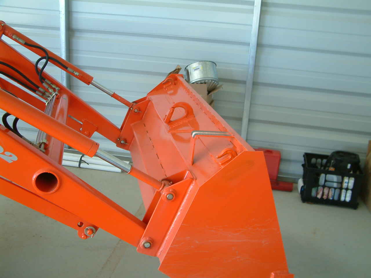

I used 2x2x1/8 angle on the LA402 on my Kubota B7800 and welded 3 hooks to that. Works for me.
