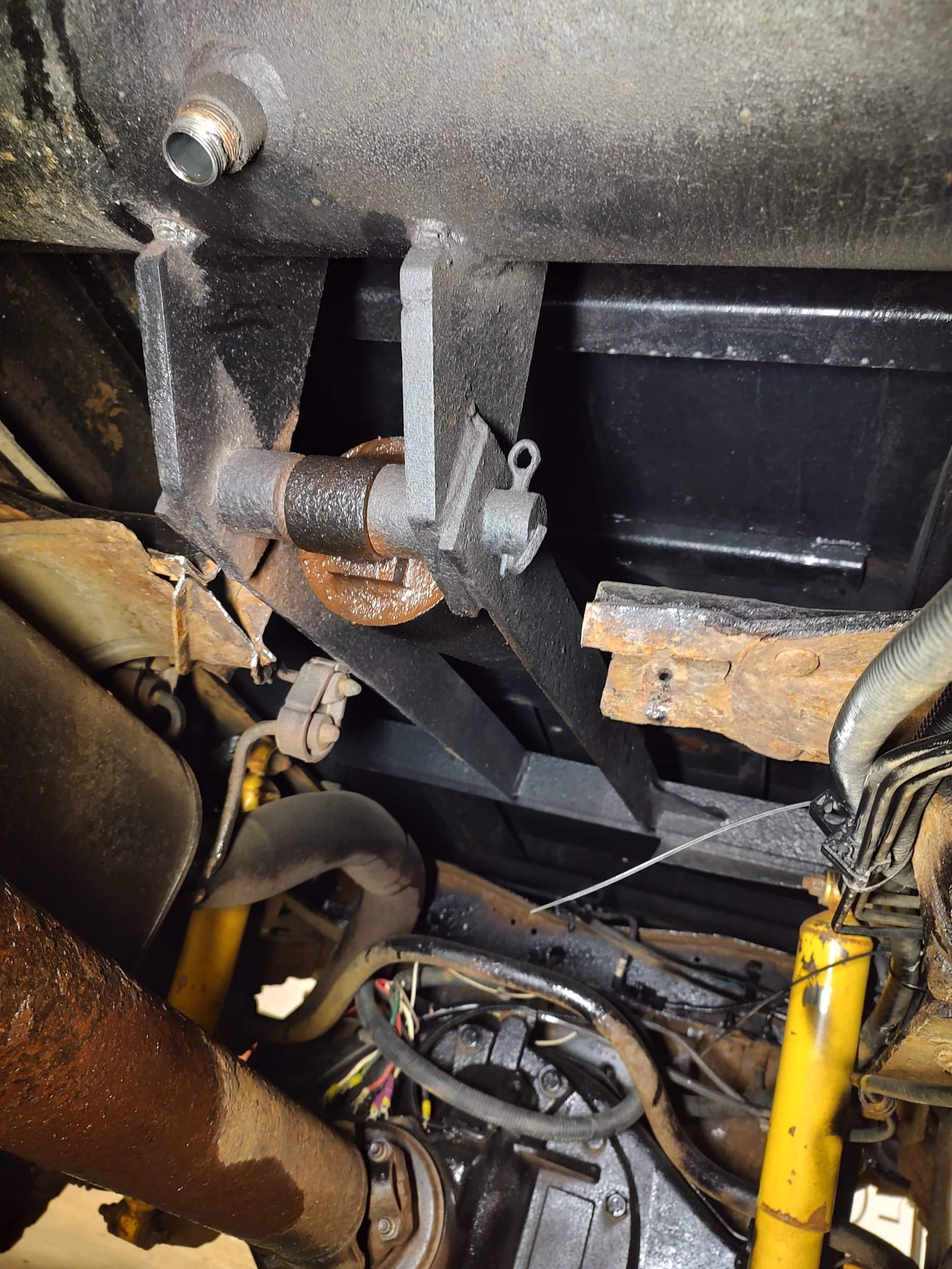

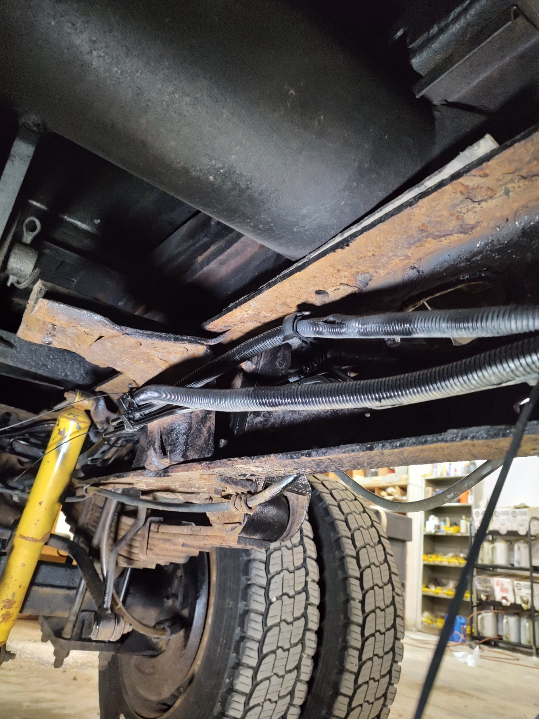

My latest project involved removing a flatbed from a 2005 F450 and putting on a used dump bed they purchased.
Last Monday....I got the flat bed removed...which was wired (lights and trailer plug) in a whether tight box. I wrote on a tablet wire colors and where they all went and left the box wired to the truck so I only needed to rewire lights and trailer plug when nee bed was on.
The owner I don't like text me that night and said don't worry bout coming in because he was gonna clean and paint the frame. Well all he did was a 2-rattle can job...lol. Totally removed all the wiring to the truck box and just thought I'd figure it out 🤬
Anyway....I digressed. Rather than let me install the bed....de decided he wanted the glory of doing it himself. And in doing so....he cut out the cross member that ties the frame rails together right at the front spring perches.
This kinda irritated me that he wanted to take over the project.....but now it's at a point I don't want to touch the truck for safety/liability reasons.
See, I'm a contractor. And buddy's partner that I don't like makes that known every chance he gets. And if something happens I don't want it coming back on me for working on this truck since I'm the contracted "professional".
My gut tells me to just walk away from this project....but I thought about a waiver. Have them sign a waiver releasing me of any liability regarding this truck/frame/cross member. Because I don't know just how structurally important it is. Probably something I would do if it was a beater wood hauling truck or something.
But I worry a waiver is an admission to knowing there was a safety concern...that would now be documented....and wouldn't be worth the paper it's written on.
Thoughts?

LD1 - I have a 2003 F450 dump (similar). In my opinion, that crossmember is a vitally important piece to the structure of the truck. It braces the frame rails and connects the two, sharing the load so to speak. Even more importantly, it resists the rotation of each rail when a load is placed on the chassis due to the outboard spring perches. Those spring perches are cast too. I can see them cracking under extreme torsional loading.
On the liability end, I really can't say. Seems to me the only way to not be responsible for the disaster that will happen is to stop working for them immediately and document why in an email. Have a frank conversation with your buddy too, because he is directly in the crosshairs if the worst happens.

Dufus could have just raised the stature of the bed, if it was too low. What will happen is they will have a wet load. Raise the bed and it don't move to slide out. The fronts of the springs will spread outwards to hit the tires. I've fixed that situation before. I'd stay away or bolt another cross member in. I guess automakers randomly throw extra cross members in because they are all about saving money? No, what you end up with is what you absolutely have to have.
