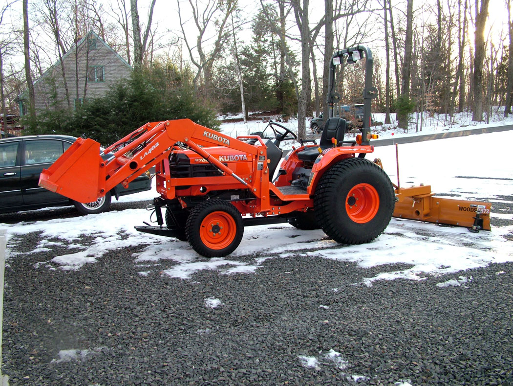

I have been plowing my driveway for the past 2 winters with the fel and a 5' rear blade on a B7800. It is taking me way too long with this setup. My driveway is dirt/gravel and about 600' long, steep in spots. I'm frustrated that I scrape up so much of the driveway until it freezes. We had an 18" snowfall on Monday and I spent 7 hours yesterday trying to get it clean without destroying the driveway itself.

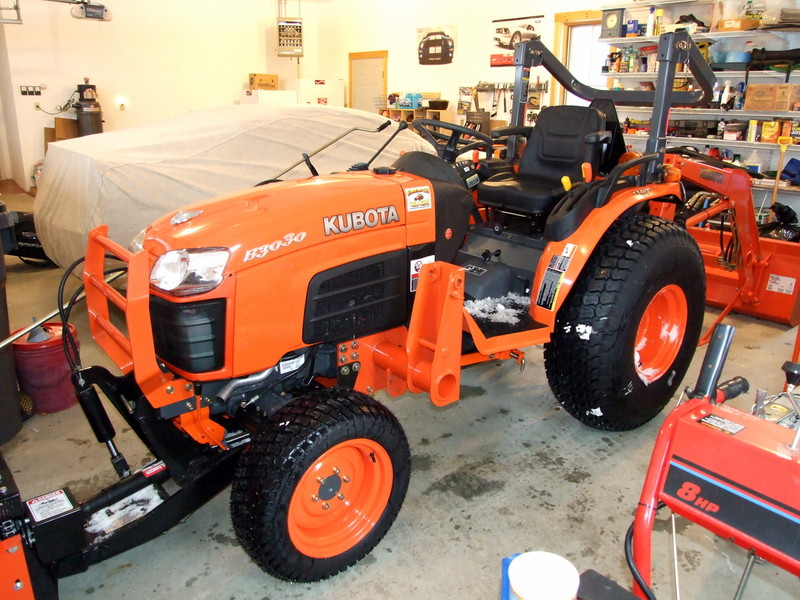

In this picture, you can see the difference in the sub frame on the B7800. It is pretty heavy, and quite different than the one on the B3030 in the other picture.
