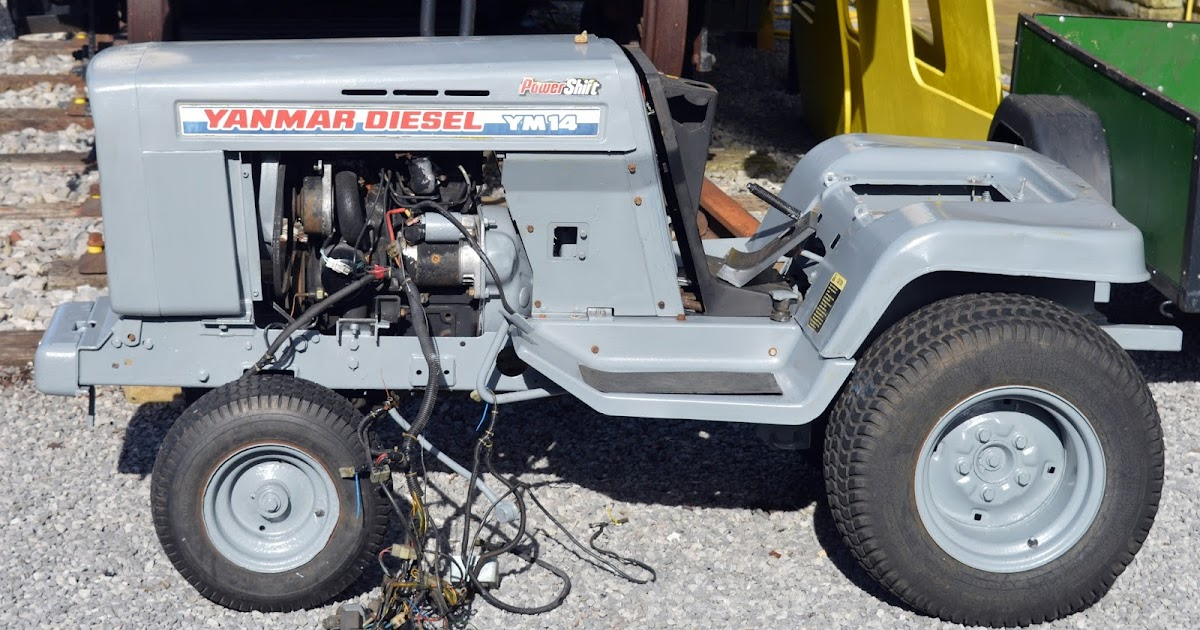

Mahindra 1526, Yanmar 186D

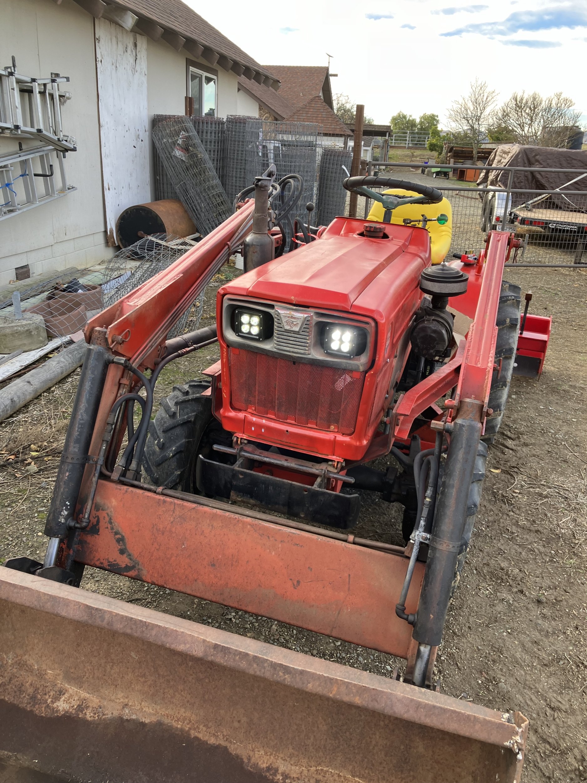

I had no lights, harness or switch. Thanks to HF and ATV LED spotlights I found a solution. If you are a purist/restorer read no further.
ATV spot lights worked in the space. Pulling the hood off made life easier.
Wiring harness is way too big, so if you have wiring-don’t bother.
I like the results and it is probably better than OEM.

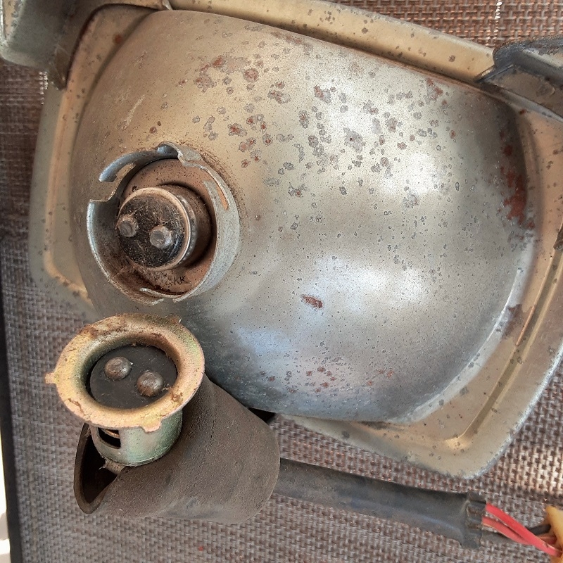

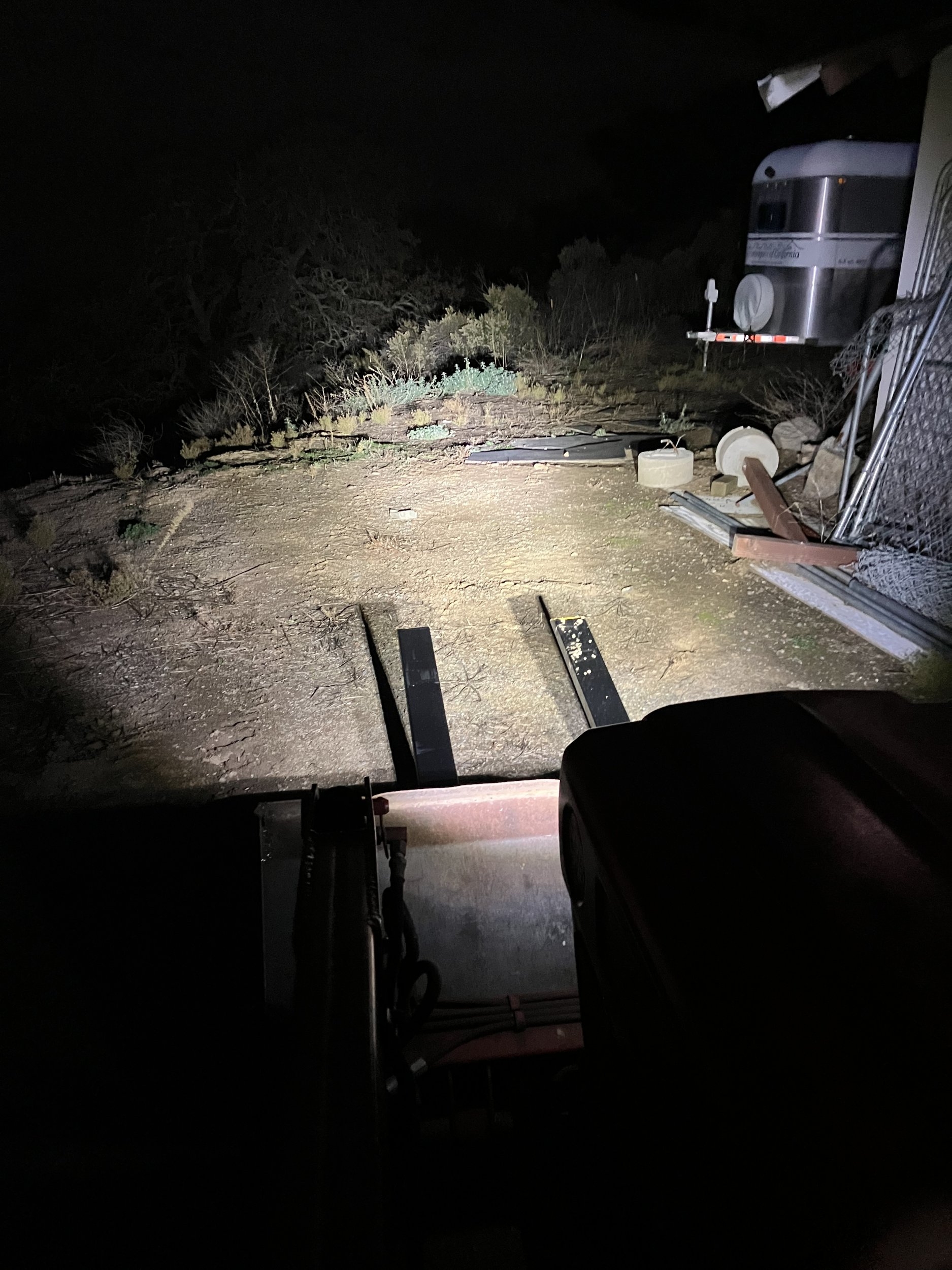

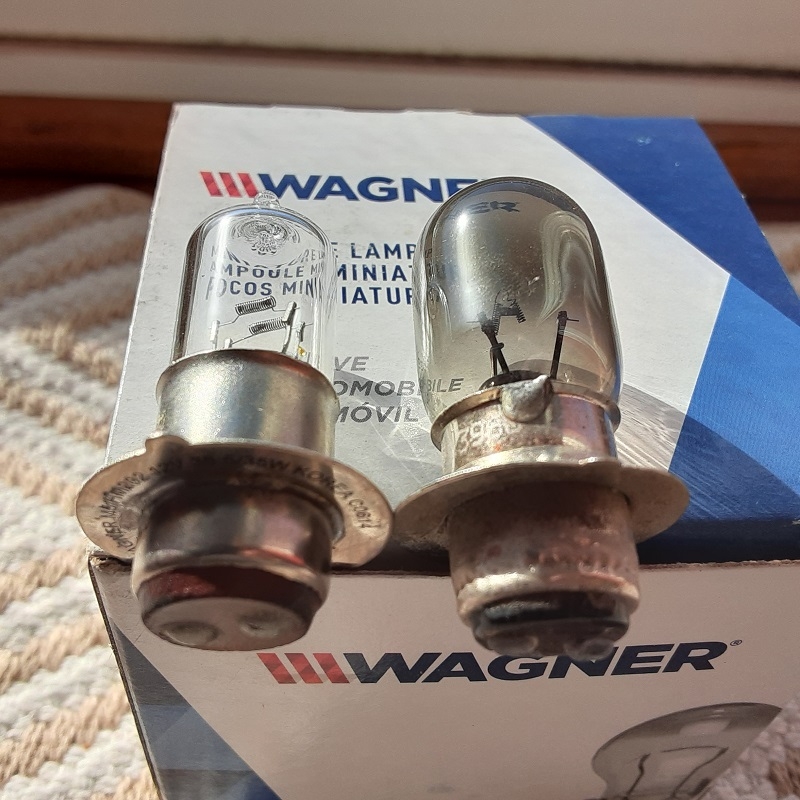

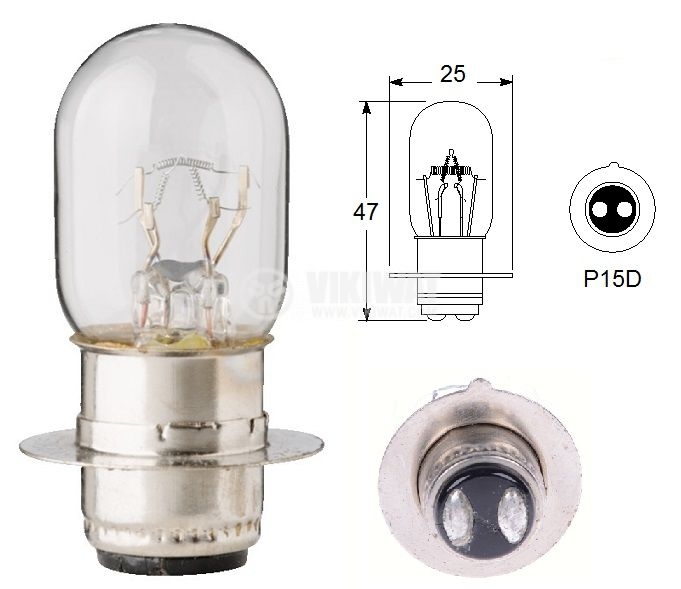

I'm more the purist and restorer, yet those silly Stanley P15D25 bulbs are so wimpy to cast any reliable light, even when the machines were new.
Doing a slew of research, mostly on Honda ATVs and on the snowmobile forums using the same headlamps in the 70s and 80s, I found a super really nice halogen replacement.
These are about 4X brighter over the original, and a tad less than the LEDs you put on.

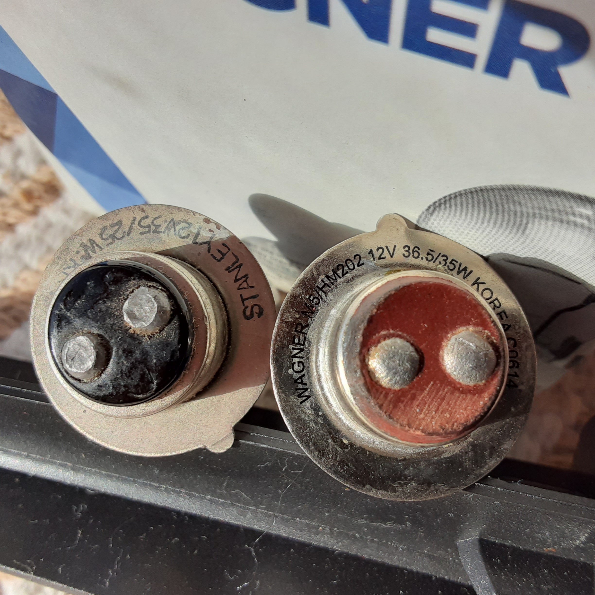

The OE original bulb,
The halogen bulb, HM202,

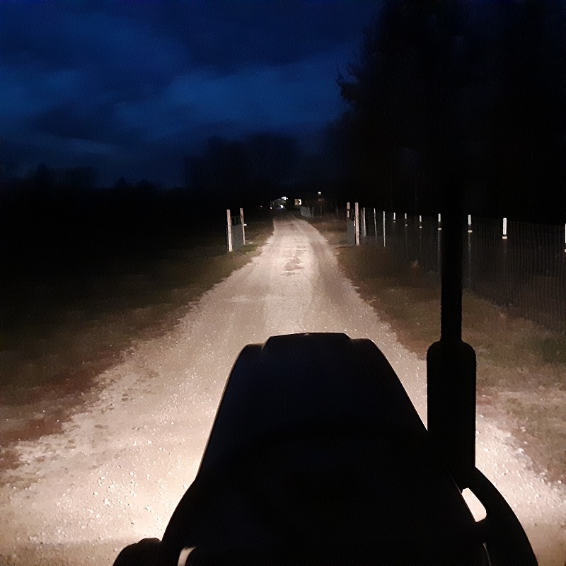

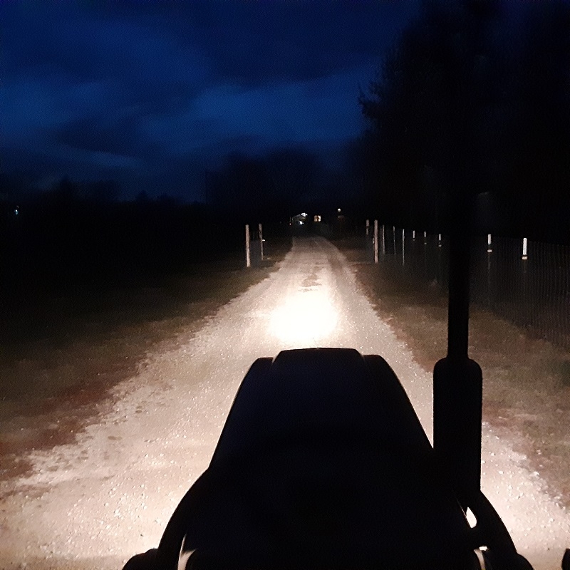

low beam HM202, just over 300ft distance and illuminating reflective items over 500ft away beyond the road.
HM202, high beam, well beyond 550ft of the entire driveway.

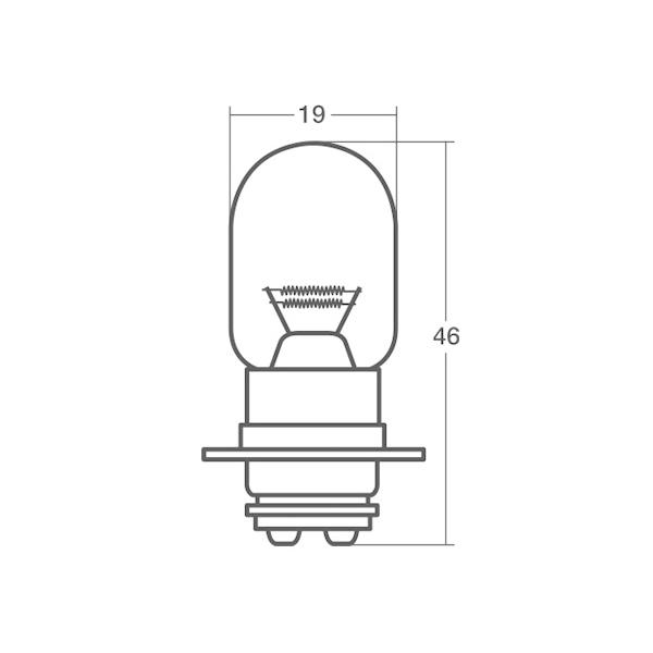

This is the best price on the web for the HM202, ROCKAUTO.COM. :love:
  • 12v 35/36.5w
  • OEM Part #'s: Arctic Cat 0409-005 Honda 34901-GJ1-003 Polaris 4032088 Suzuki 09471-12138 Yamaha 5UM-84314-E0-00 Yamaha 5VM-84314-00-00
  • Common bulb for early 70s Japanese motorcycles
Stanley HM202 Halogen 12V 35/36.5W.
OEM ReplacementArctic Cat 0409-005, Honda 34901-GJ1-003, PU K10-1117, Polaris 4030055, Polaris 4032088, Suzuki 09471-12093, Suzuki 09471-12138, Yamaha 1A2-84714-41-00, Yamaha 2GN-84314-00-XX, Yamaha 2GN-84314-00-00, Yamaha 5VM-84314-00-00
This part fits: (click the plus signs to expand)​
Data info on the HM202 Halogen,

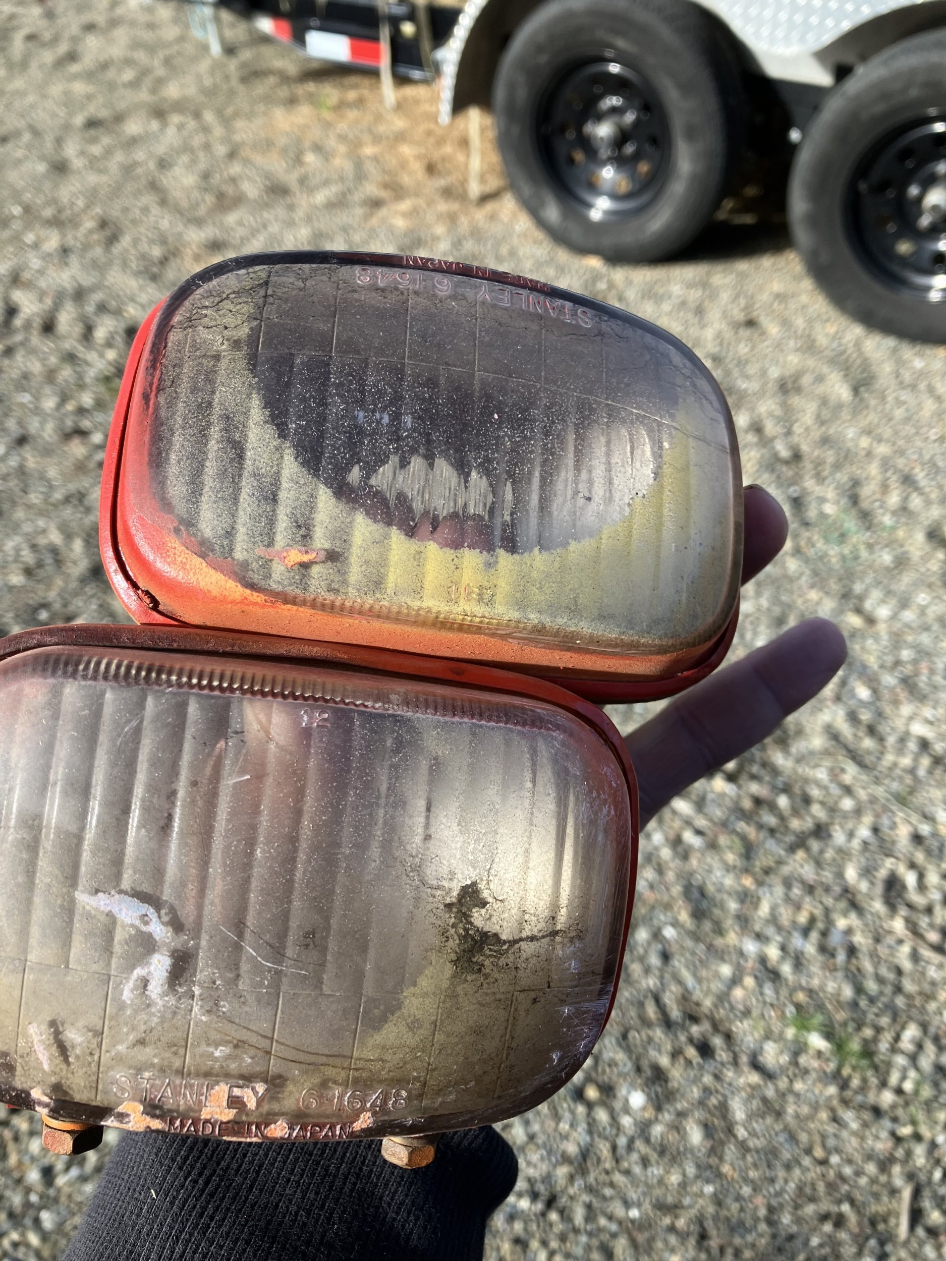

Another reason I went with my direction. Overspray on the inside of the lenses.
Once the canopy on the ROPS is done, I'll add on those H-F LED spots. The YM2610 then would have a Deere look to it.
Those are LED spots, do looking long distance out is not effective, yet all around the tractor really near would be totally lit.
