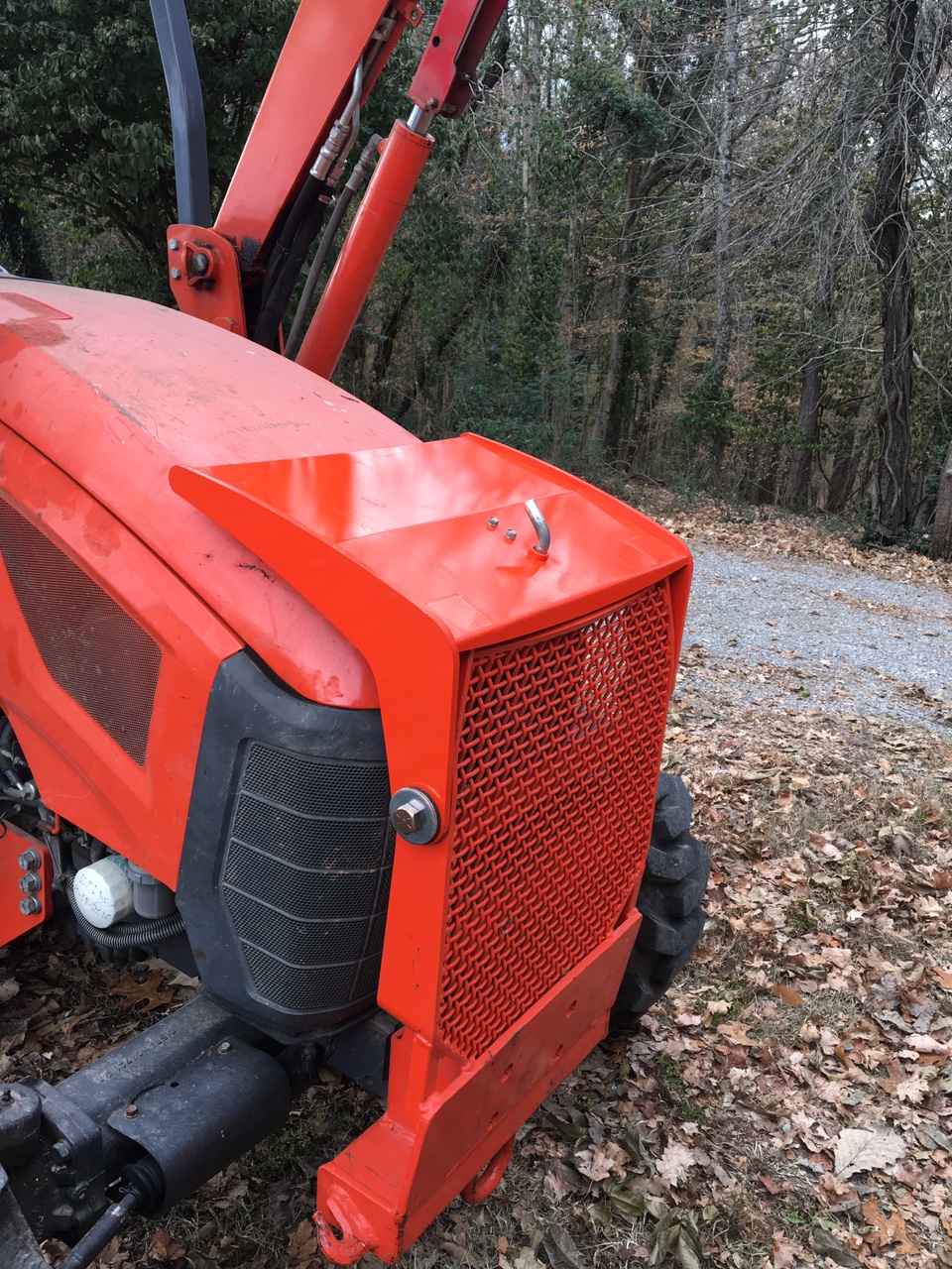

View attachment 651206. @#$% - darn, that IS a shame. I was on TBN more than two years before I bought my grapple. So, I had this grill guard modified prior to the grapple purchase. The right type of expanded metal replacement might not look bad, at all.

oosik and Smokeydog, are you comfortable with the size of the guard you have? I was planning to make one that would run from bottom of the Kubota guard to about level with hood and about two inches wider than Kubota guard on each side. will bolt to the Kubota guard most likely. Started out thinking expanded metal but have not found a very heavy grade of it and thinking about using 1/8 inch sheet metal up to the lights and there expanded metal. That would be about 36 inches tall and think 28 wide.

Yes and they have prevented damage. Lower 1/2” plate and 3/8” wall tubing is not too heavy for some of bush hogging I do. Also had to do with what was in the scrap pile. Like having a front bumper for protection. I have improved 6 different guards and like the M59 the best with the factory bonnet protector. That’s AR steel quarry screen used on it.
My lights are up on the 4pt ROPS which helps.
Expanded metal or thin metal gains a lot of strength by multiple attachments like tack welding. Bolting is more of a challenge. Know not everybody welds.
