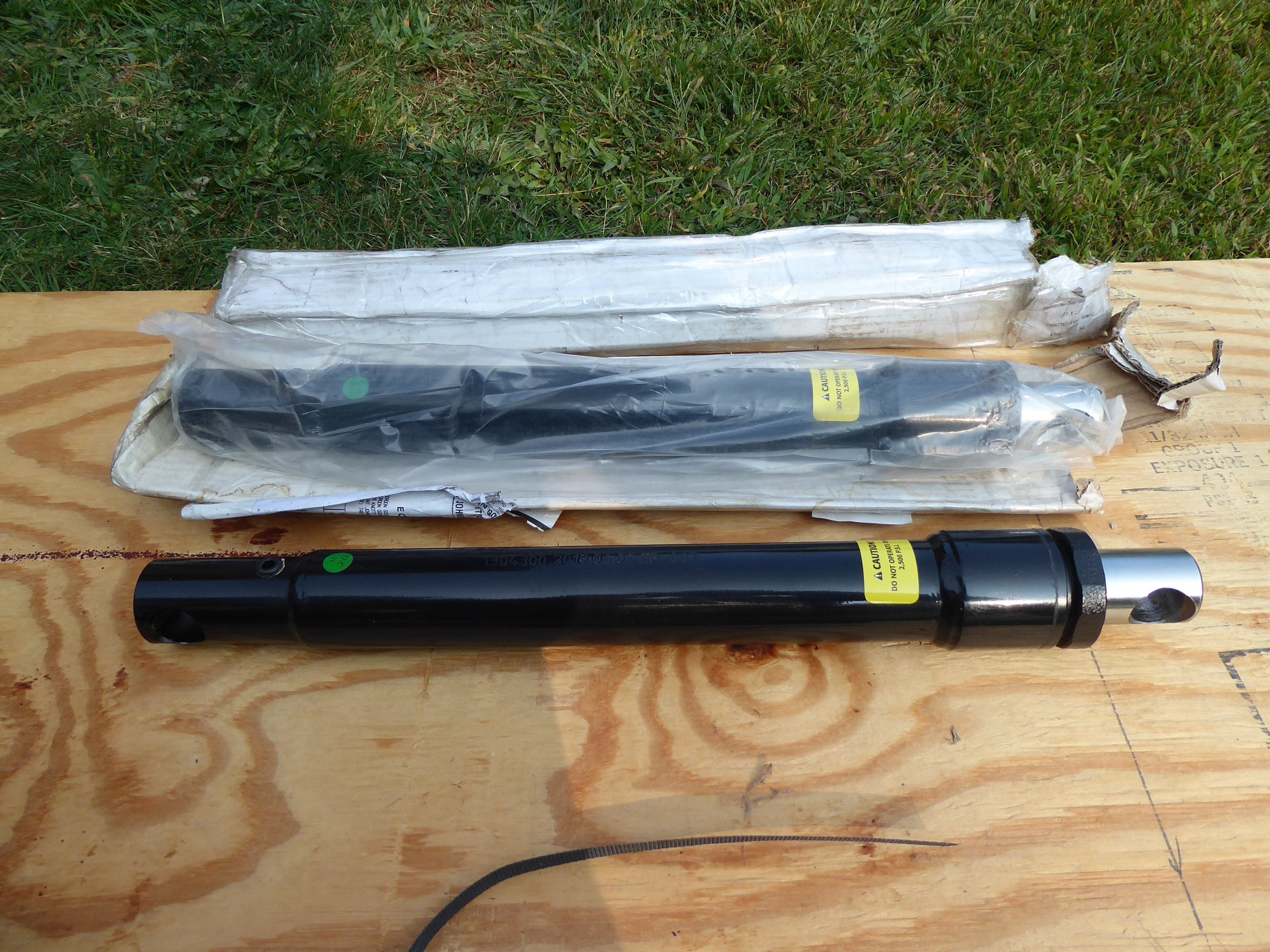

I got the new RCPW (Replacement Commercial Parts Warehouse) cylinders via FEDX today. This is what they look like. I can assure you that reflection along the side is not a rub or scratch. Just something with the lighting and my camera lens I guess. It will be a while before I get them on the plow and hopefully quite a while before I need to plow. I will try to remember to report back then.

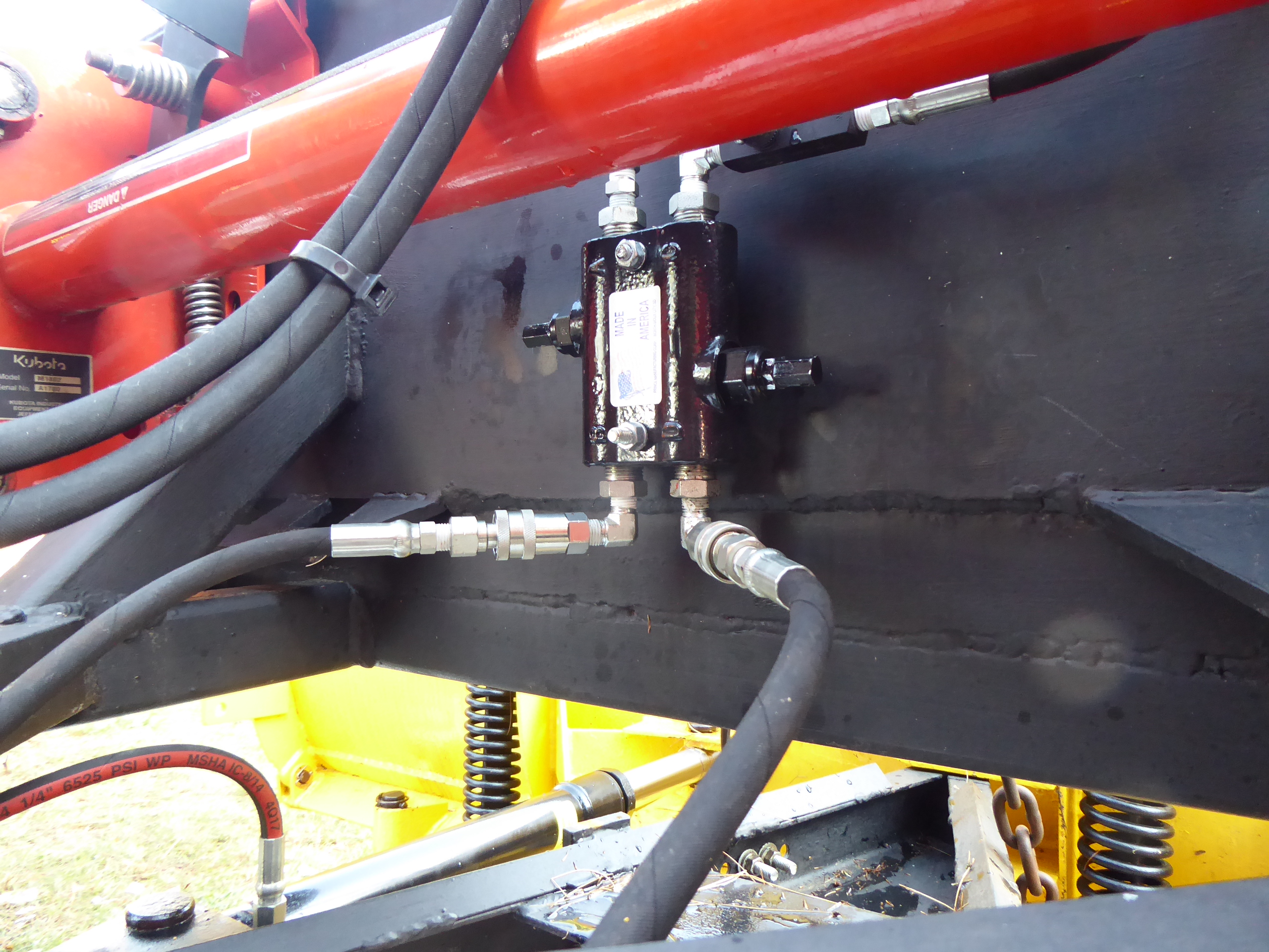

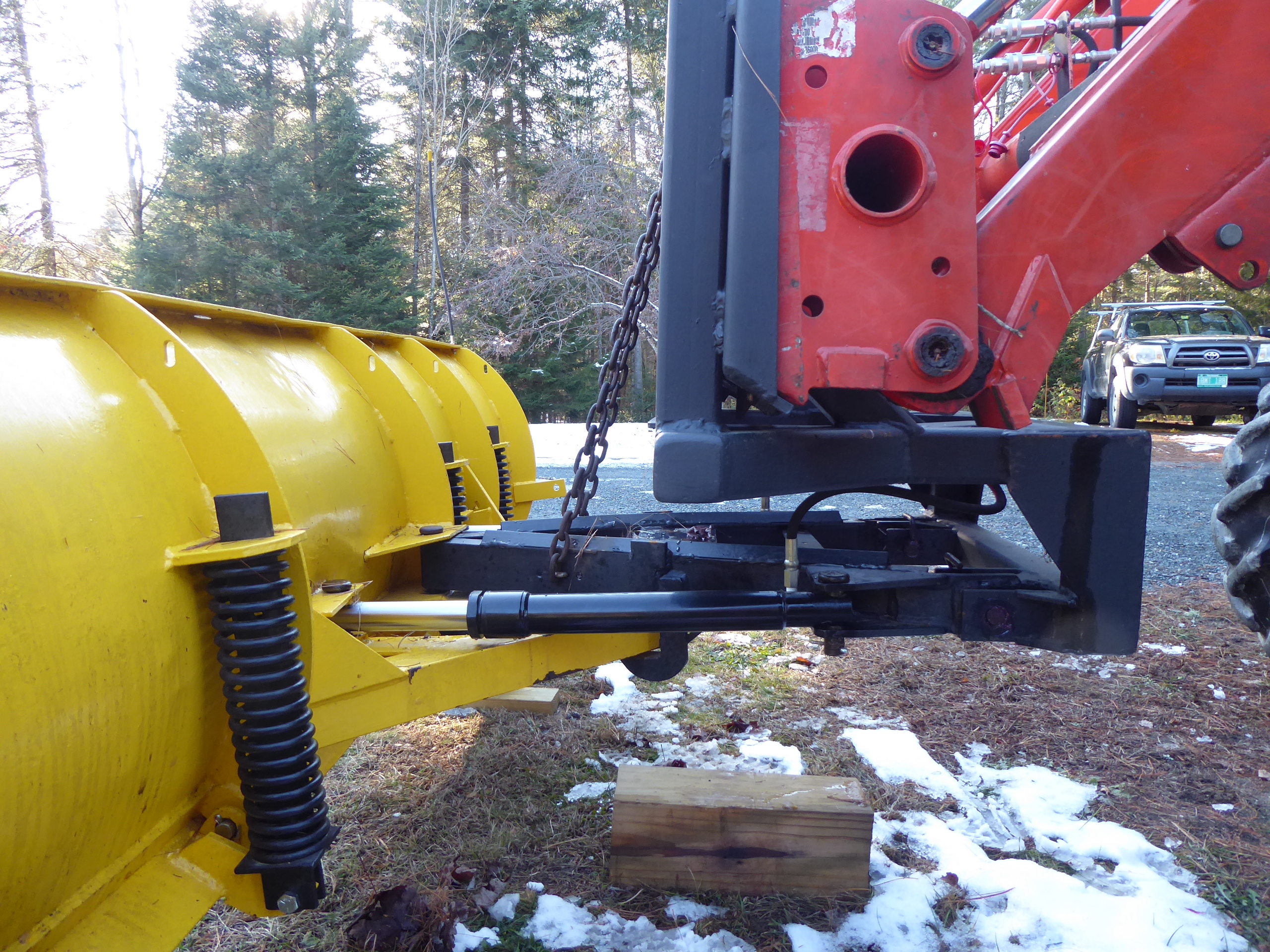

Since the time is getting close I thought I better get these cylinders on the plow. There were no gotcha's or surprises. They fit like they should and operated like they should. They are spec'ed for 2500 psi. I double checked the cross-over relief valve settings at 2200 psi with the tractor hydraulic capable of 3000 psi. All worked fine. So now we need some snow.
