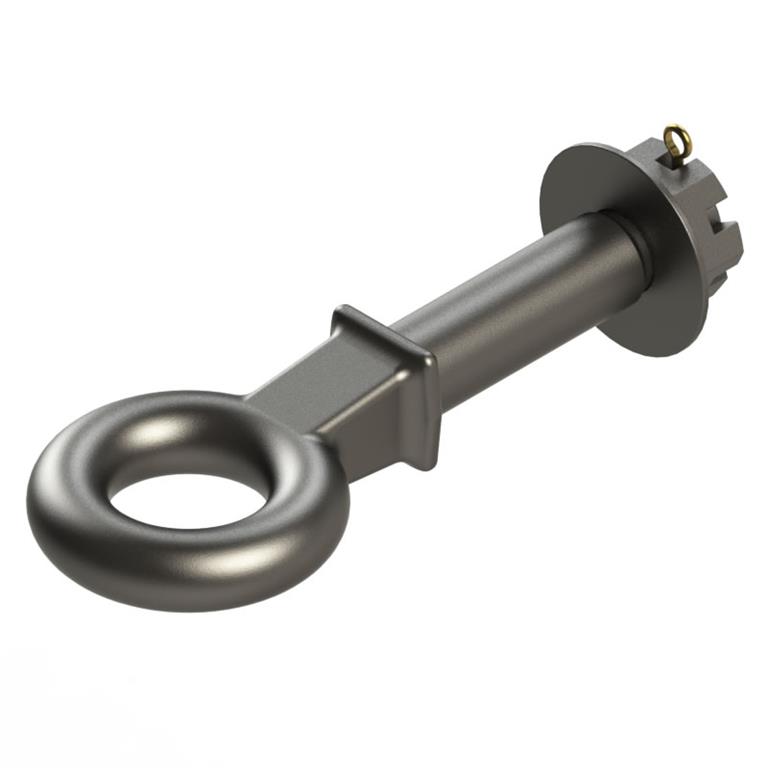

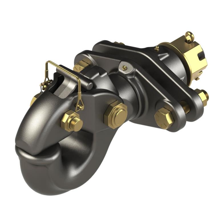

A couple of pictures:
A swivel pintle hook. The second one would make for an easy bolt on, weld on drawbar swivel fabrication.
/ "Reverse clevis hitch"? Anyone ever tried? #18
View attachment 498273View attachment 498274
To me a rotating pintle hook suits all your needs and you may can have a mount for the pintle hook modified to bolt to the draw bar and you pin to it with no modification to your implements.
