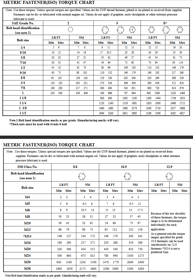

Hello all, I am looking to tighten the loader bolts on the RK24. I was wondering if anyone has seen anything on how tight they need to be. Thanks for any help.

Pages 33 & 34 from the FEL operators manual on rktractors.com...
   / RK24 FEL Loader Bolts #3
He beat me to it. The FEL bolts that hold the arms to the frame are M16x2.4x45 class 10.9 bolts. 230-280 lb-ft.

Wow Thanks so much. Would you folks put any kind of lock tight on the bolts.
Lastride
   / RK24 FEL Loader Bolts #5
Lastride
Nope. We don't do it at the Tractor Assembly Centers, I wouldn't do it at home either.
   / RK24 FEL Loader Bolts #6
In my opinion, blue thread locker is never a bad thing to do. Now red thread locker, I only use when I never ever under any conceived thoughts would be removing the bolt, or whatever. Thread inserts are one such thing that comes to mind where I would use red thread locker.
My 2 cents worth, consider it worth what you paid for the opinion!
