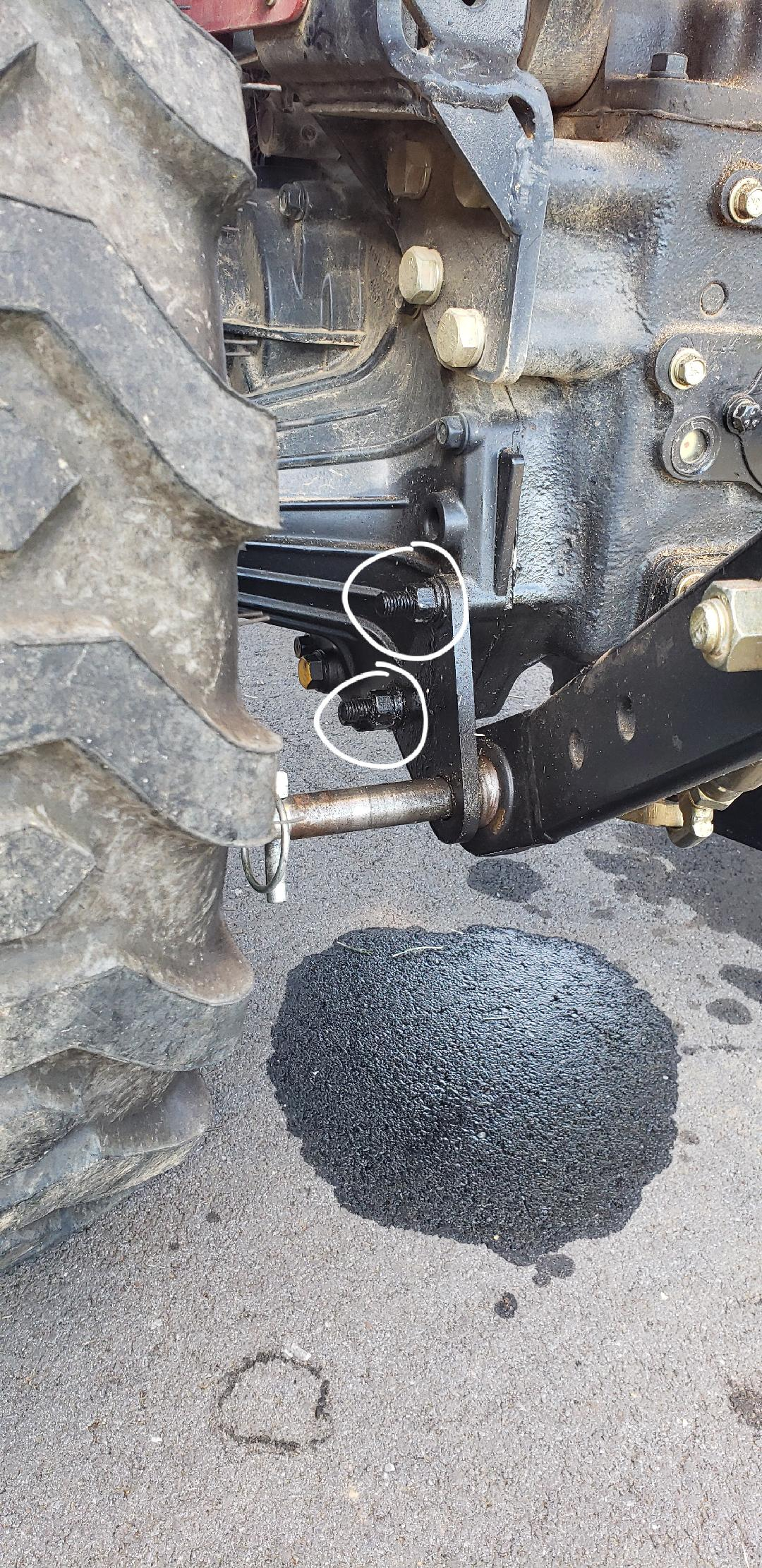

RK24
Noticed earlier this week that I had developed a hydraulic leak on the right rear final drive housing. It wasn稚 until operating in dusty conditions that I noticed the dirt sticking in that area. I checked and sure enough there was a small film of hyd oil on the bottom of the final drive assembly. I cleaned with brake cleaner and checked the drain bolt to make sure it was tight (it was). After cleaning the oil off I ran it for about 15 min and rechecked it. Sure enough a film of oil again.
After cleaning it off I left it for a few days to see if it leaked without running. Found a small oil spot under the tractor. It appeared that the leak was coming from the rear portion of the final drive. Just behind the bracket holding the lower 3pt draft arms on. Put a 17mm on the nuts and they were loose. Took about 3/4 of a turn in each to snug up. Checked the left side and one was about a 1/4 turn out on the upper stud. The lower was tight.
I checked oil level and ran it for a couple days around the property. Leak seems to be fixed. And it saved me a trip to RK. Just wanted to share this to encourage others to check those before they develop a leak as well.

Hi there, I had the EXACT problem with a leak in my RK24. I checked the bolts and sure enough, they were very loose. Wiped it clean and still dry 3 days later. You saved us a trip to the dealer too. Thanks!
