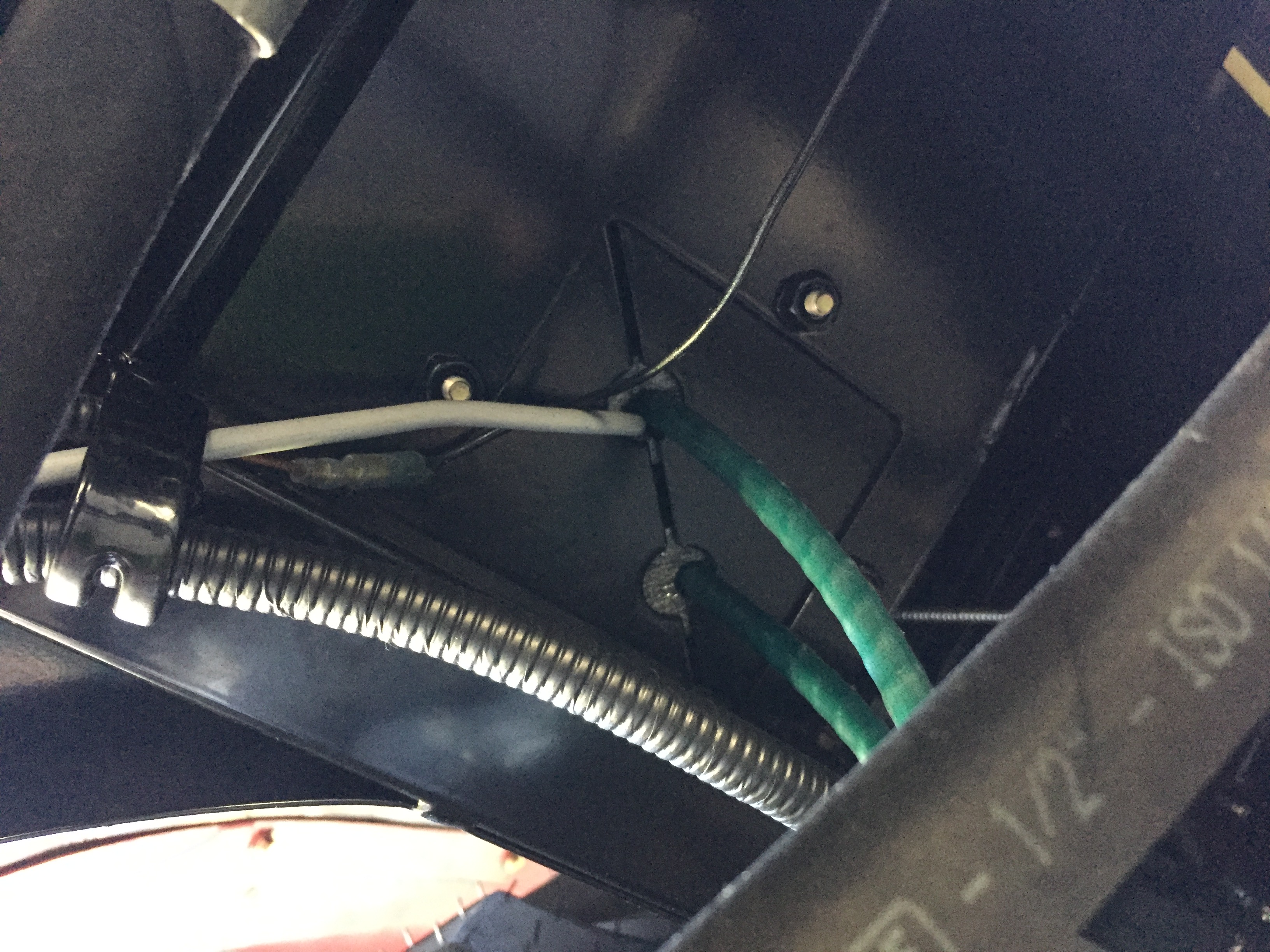

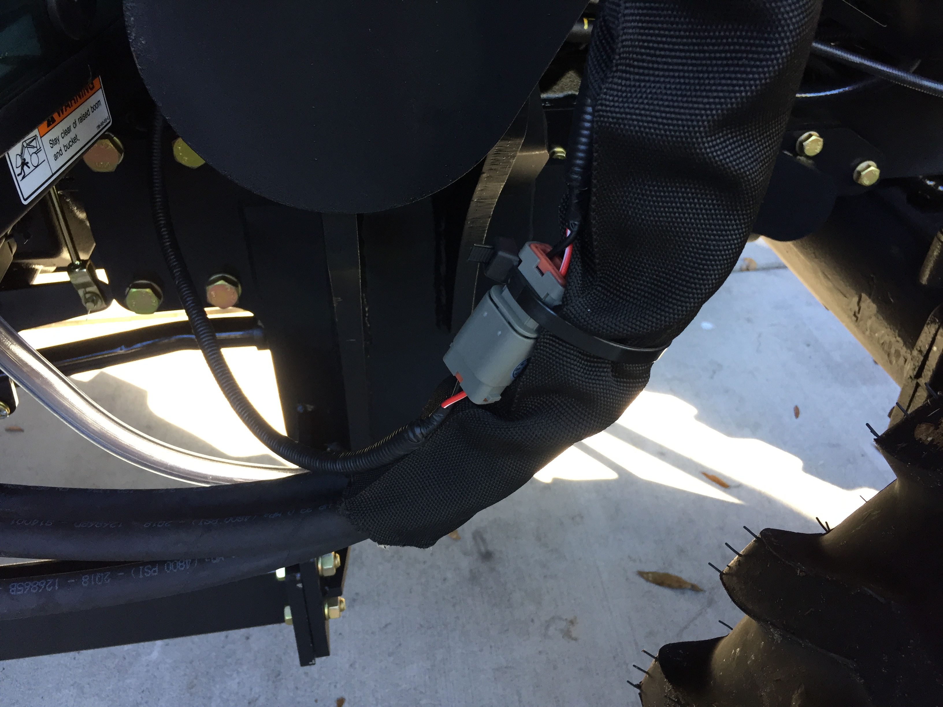

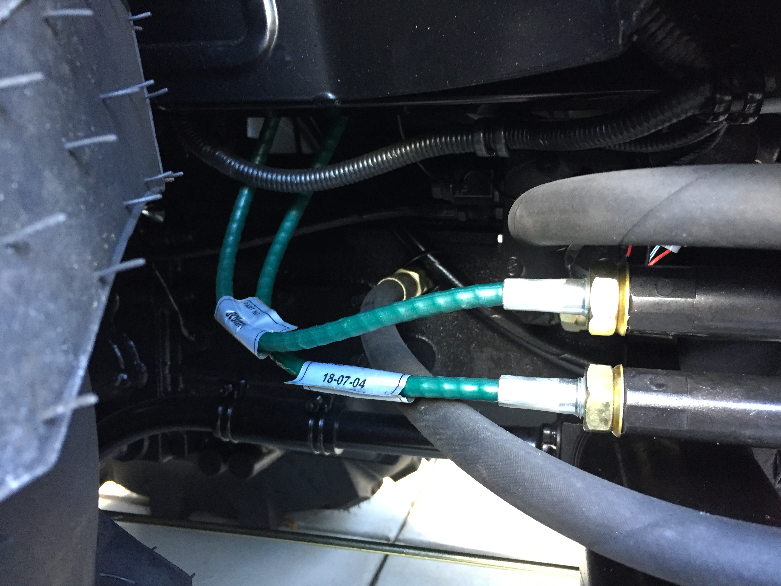

I was not satisfied with the location of the 3rd function wiring harness as it was installed at the factory, so I re-routed it to better protect it. In case anyone else's looks similar to mine, below are some before & after pics to show how I fixed the issue.
As installed by the factory, the grey wire that routes to the loader handle button had a lot of slack, and part of it was actually resting on top of the hydraulic filter. To me, the logical place for this wire is with the other wires of the tractor's electrical harness that are tucked neatly out of the way. Maybe that's the way this unit is typically installed. I know a new tech installed mine, so it could possibly just be a one-off.
Anyway, here's a pic showing the wire in question. Part of it has grey insulation on it. The grey insulation switches to a black corrugated protector where the wire plugs into the part of the 3rd function harness that travels up the actual loader. You can see where the grey wire droops down toward the hydraulic filter.
Here's a shot showing the wire as it enters the compartment at the base of the loader handle. Some of the slack was zip tied at the factory to the loader cable as can be seen in this pic.

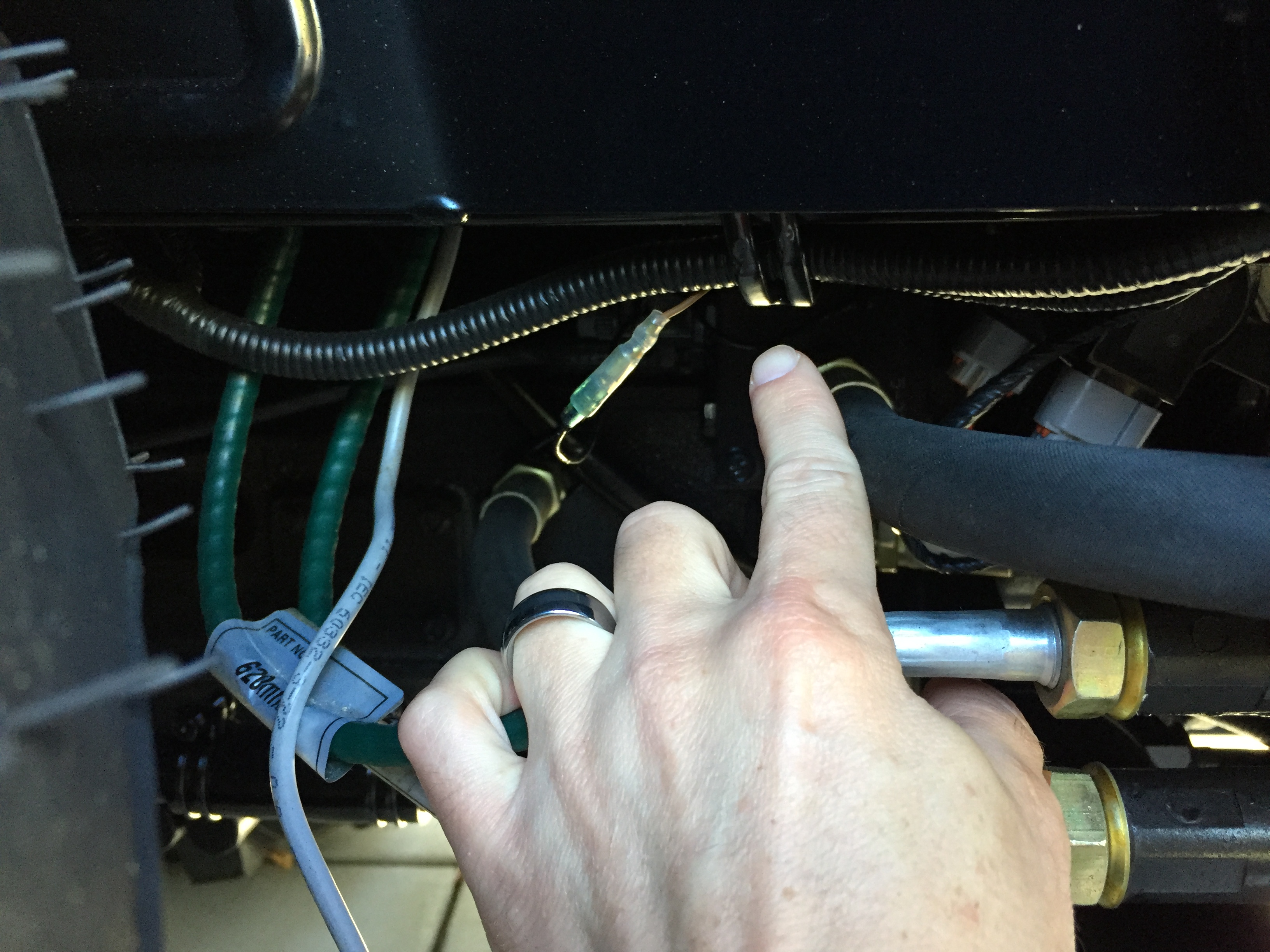

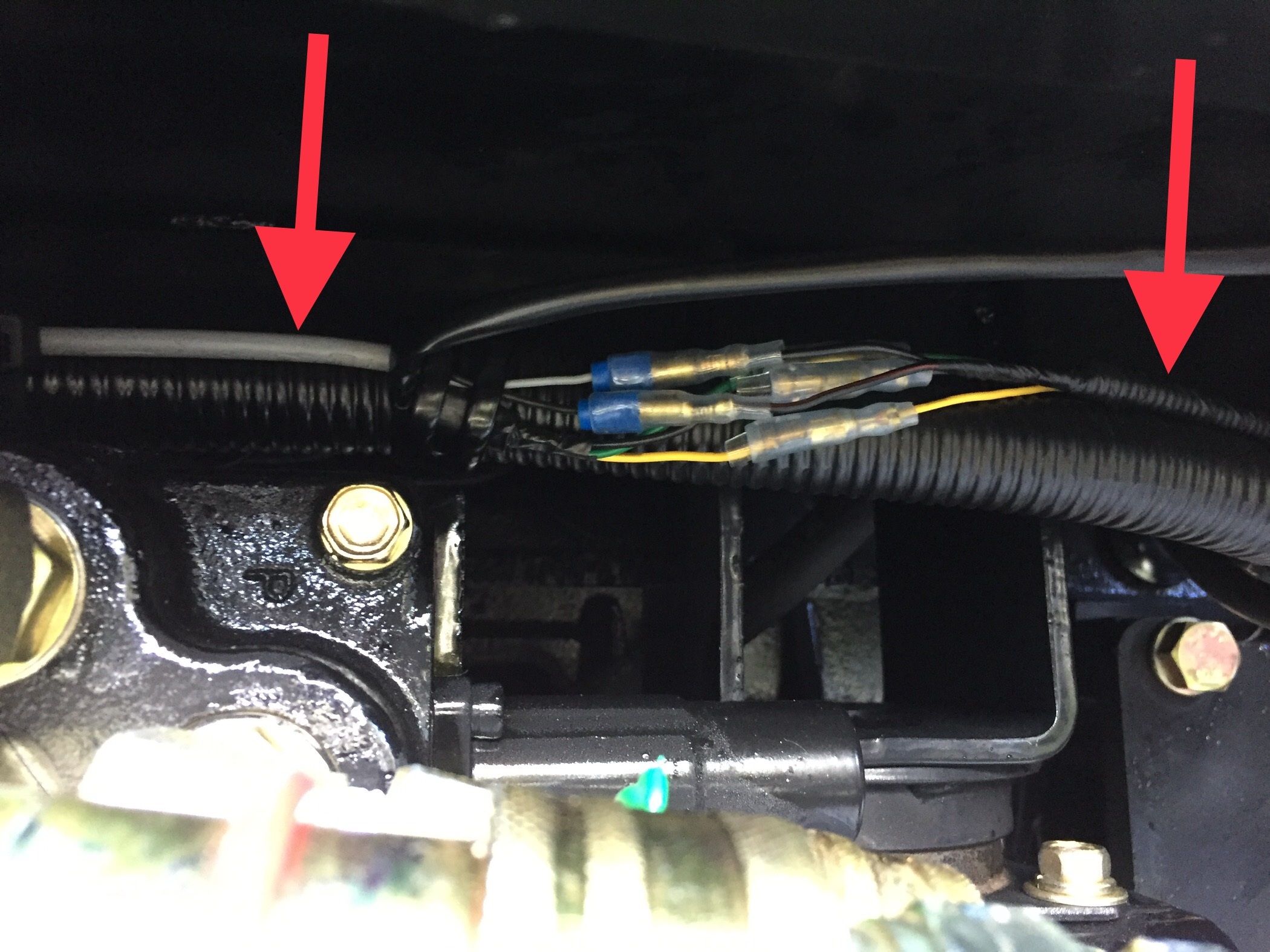

This next pic shows my finger pointing to where the wire should have been installed. The black tab can be bent down temporarily to accept the wire. There are two or three of these tabs you have to bend down.

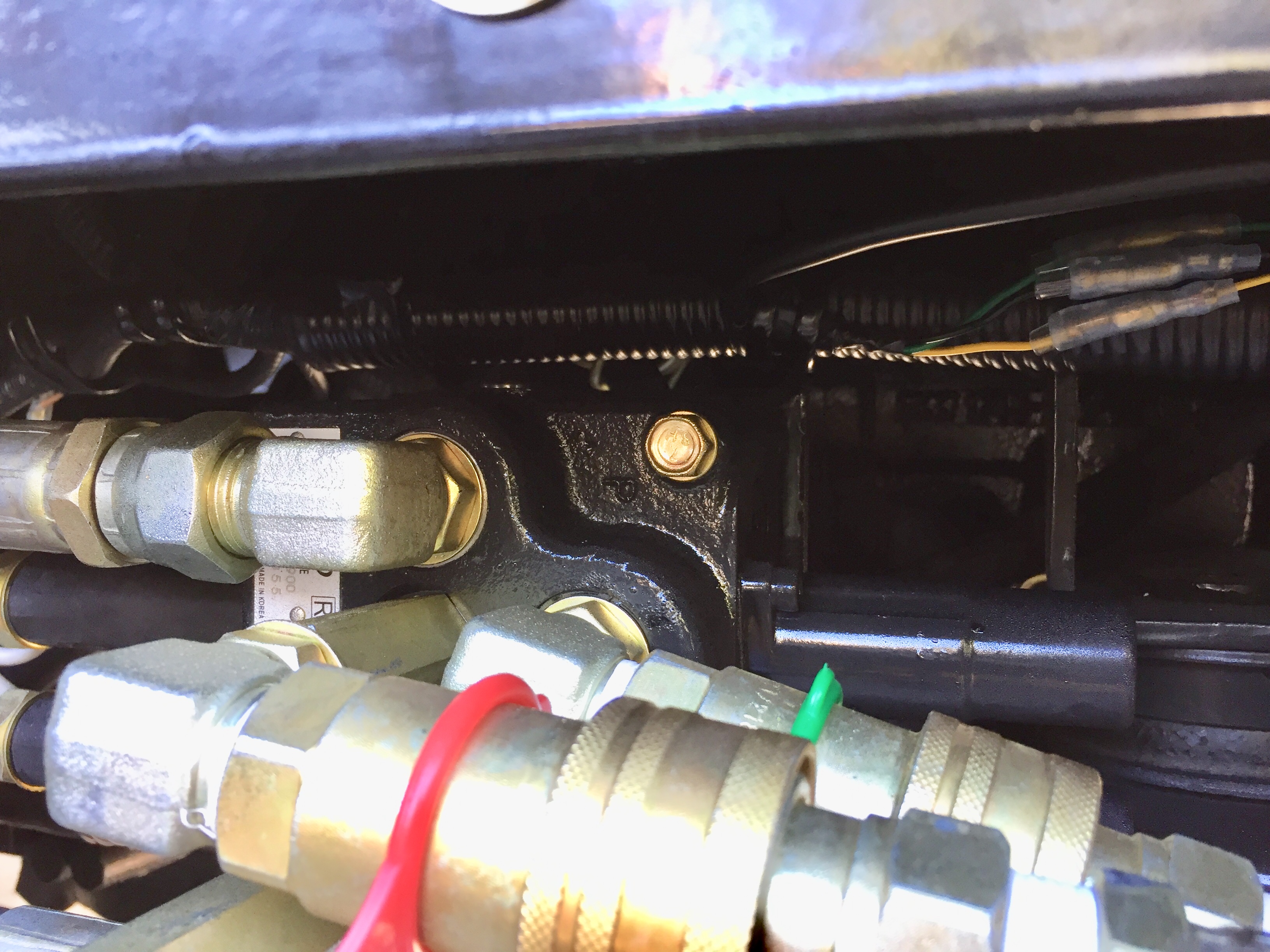

A pic showing the factory harness location as it travels above the loader hydraulic valve. This is where I relocated the 3rd function wire.
A pic showing the two ends of the third function harness where the grey insulated wire plugs into the black corrugated wire. You just unplug these two connections and place your wires into the main harness route, folding the flexible tabs securely back when you're done.

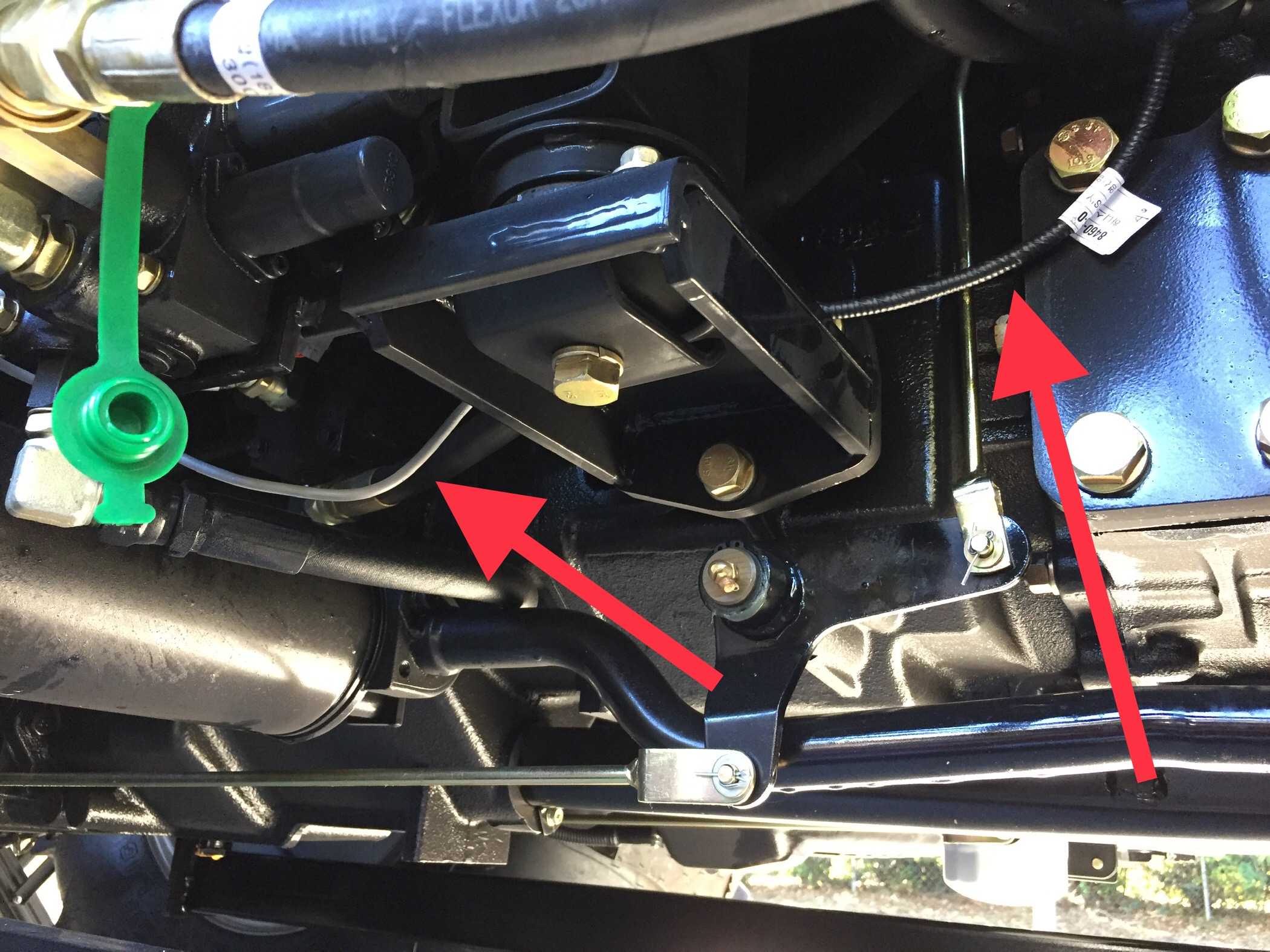

Here's some after shots.

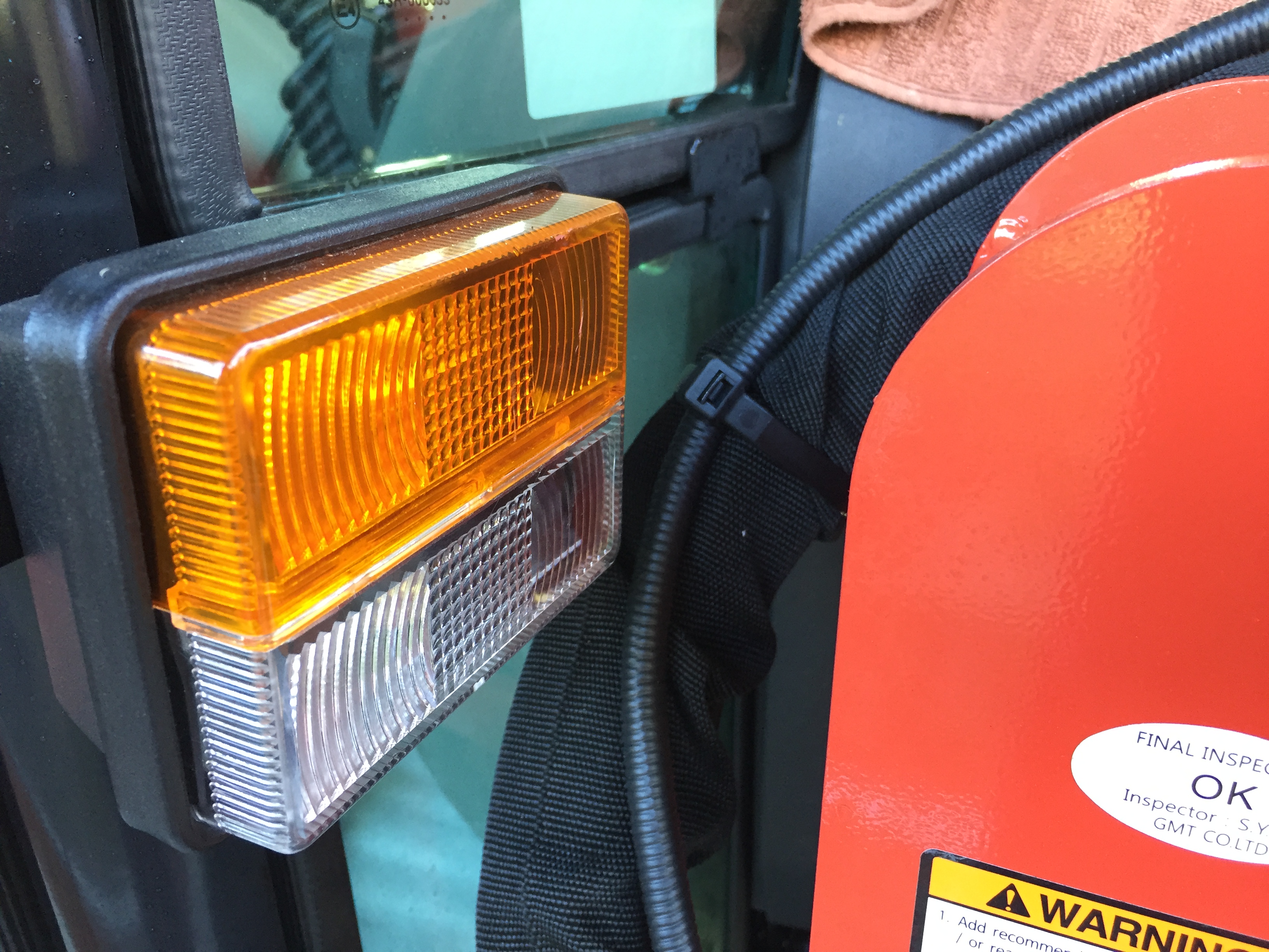

This pic shows the 3rd function harness toward the front of the tractor cab.
Red Arrow - wires to loader handle, after being relocated
Green Arrow - wires to battery
Blue Arrow - wires to 3rd function valve
This one shows the relocated wire just above the loader valve, instead of drooping below it and laying across the hydraulic filter as originally installed.

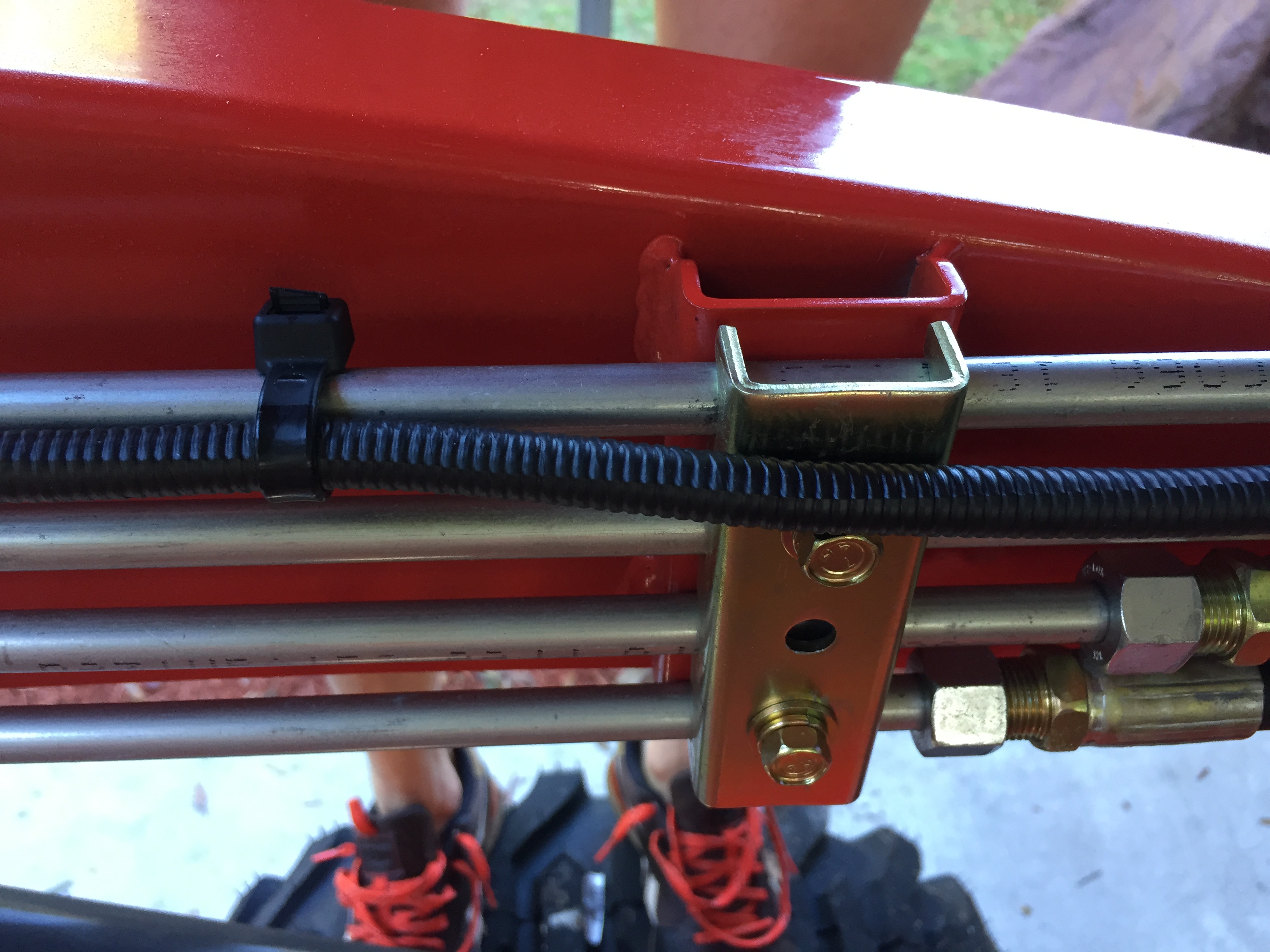

Finally, just some randoms of zip ties I added to the wiring that travels up the loader to better secure the harness.

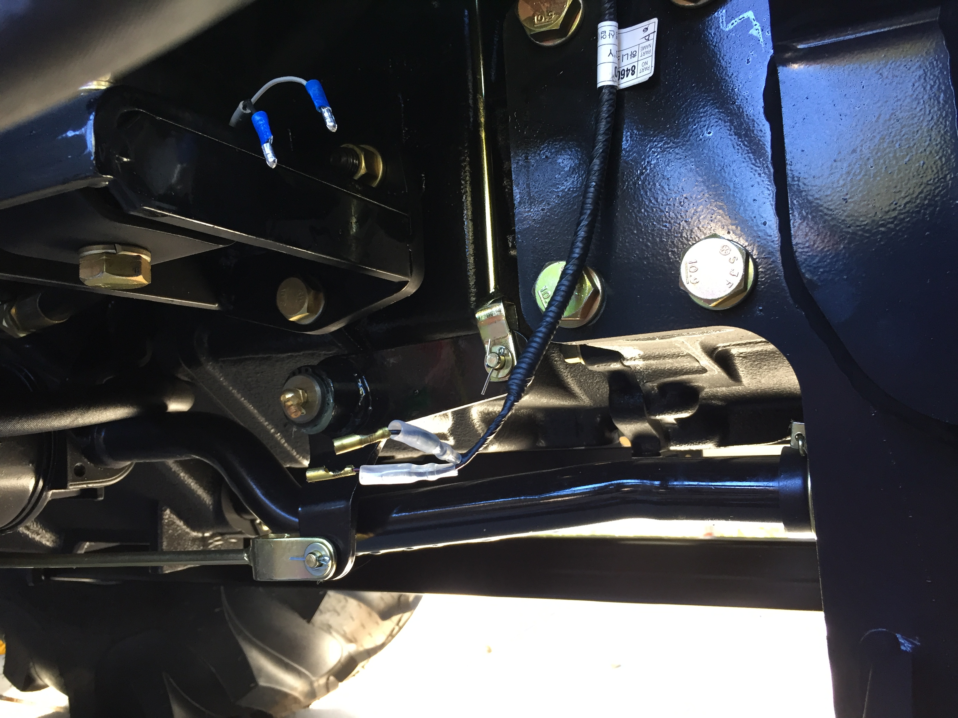

It seems odd that the female bullet connectors are OEM grade (can tell by the connector and the shield) while the male connectors (blue) look like hardware-store crimp ons that were not crimped too artfully. You might want to double check or redo those since they don't look right at all. Looks like someone mashed them with pliers instead of using a crimper.
   / RK55 - 3rd Function Valve Wiring Harness Location
The blue plastic slid right off the male terminals as I unplugged them, so I would agree with your crimping assessment. They appear more mashed than crimped.

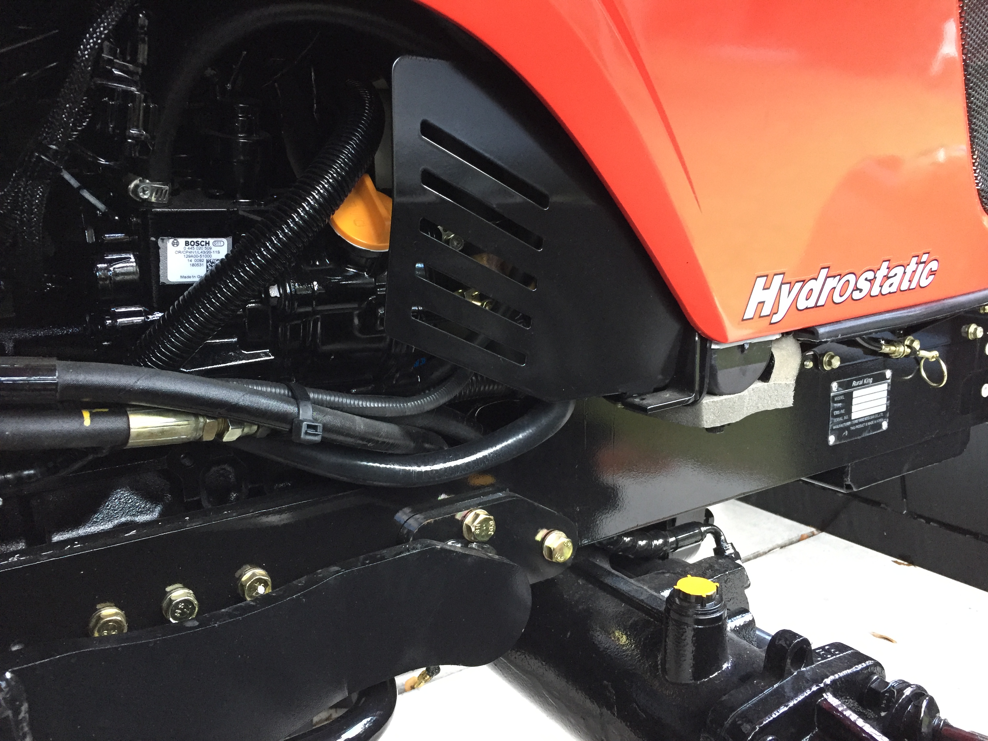

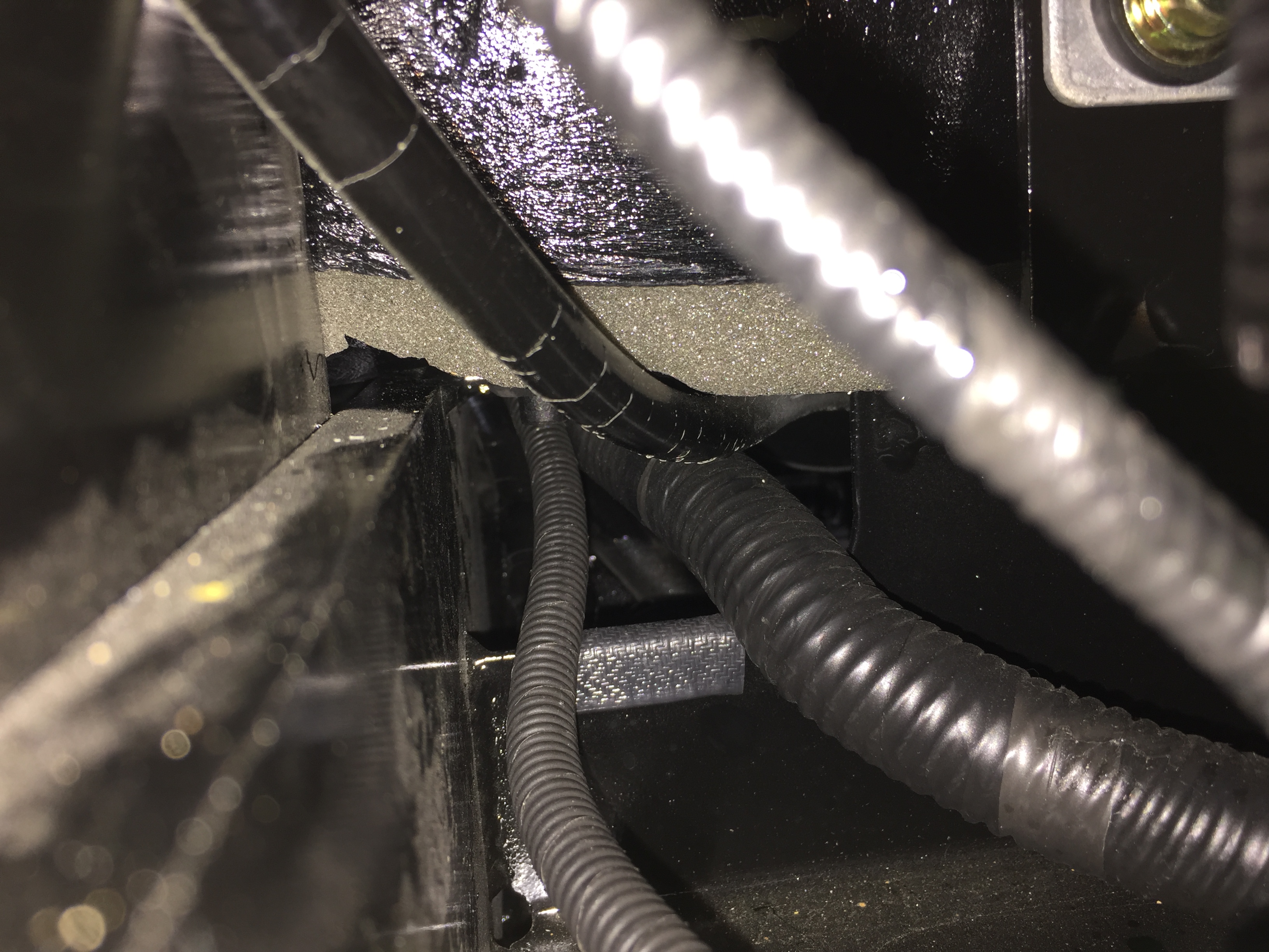

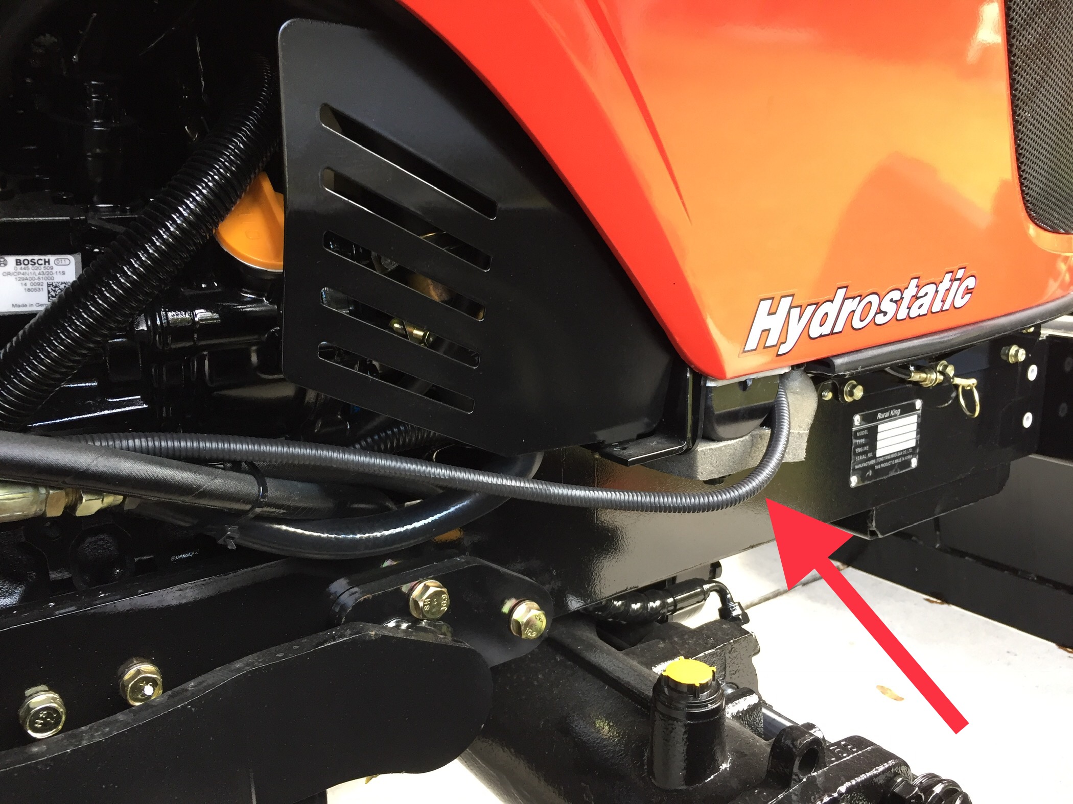

Finished this project today. There was another area at the front of the tractor where the installer took a shortcut instead of following the existing wiring harness route, as shown below.
I detached the 3rd function wires from the battery, backed the harness out, and re-routed them along the existing wires that travel to the engine bay.
There is a rectangular cutout at the rear of the engine bay to allow for wire routing. The small black corrugated wire in the next pic is the 3rd function harness. It does take some patience to get the 3rd function harness through that opening, but it is not too bad.
Here is the final result looking from the outside of the tractor. I am not sure why my installer had such an aversion to routing the 3rd function harness with the existing tractor harness, but it looks good now.
After shot.
