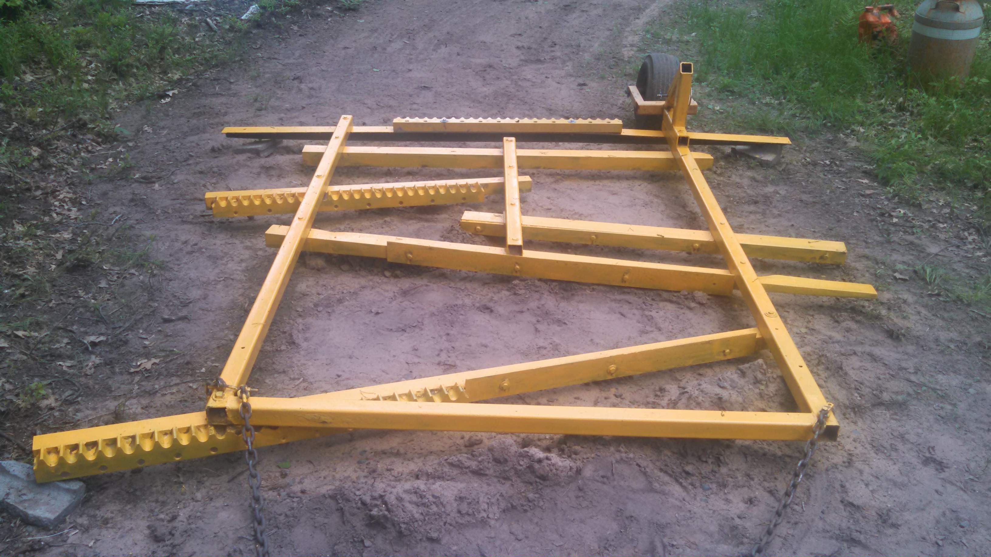

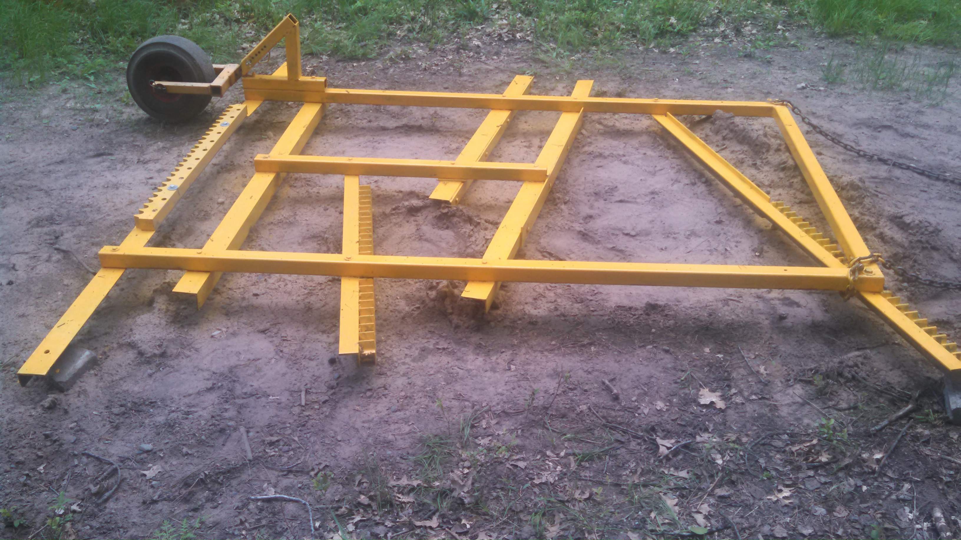

I was doing a little work on my road drag, so I thought I would mark up the dimensions in case anyone wanted to make one of their own. I slapped on a coat of paint so it would show up better in the photos. For some reason my PDF of the dimensions wouldn't upload, so I scanned the pages as JPEGs, but the quality is poorer.
This thing was really easy to build, and I made it about 15 years ago when steel was less expensive. Nonetheless, I would do it again today because this thing works so well. It leaves the road silky smooth on a single pass. I will try to do a video later and post that.
So here are the plans. You can make one that is 8 feet wide or one that is 6 feet wide (multiply the dimensions by .75). You will be amazed how well this works!

:welcome:, and :thumbsup::thumbsup: Having used a similar though far less sophisticated device this is impressive, to say the least. IMO, what stands out is the multiple crossbars, shear angle (improves cutting action), and that there is nothing to trap excess material to then be dumped in the wrong place.
Thanks for sharing the construction details, from one who wouldn't be surprised at how efficient and effective this is. ;) The tail-wheel has me thinking about how to upgrade the one we're passing around and considering improvements to. Then again, I just might just want to jump ahead to this well developed design. I just know it's a winner.
Btw, 15 years, already? Airbiscuit, where have you been all this time? :)

We maintained 3 miles of heavily used gravel road with a very similar design for about 10 years and simply pulled it along with an old Willis Jeep.
Ours was about 8' wide and 8' long and used only 3 'blades' and it worked like a charm, in fact the city's Caterpillar grader is not able to do a better job.
Our 3 'blades' were angled such as to even out the side drag to keep it pulling straight. We tried to have the angle of the center blade equal to the sum of the front and rear blade otherwise the drag would go the way of greater resistance.. (like 2@ 15 deg and the other @ 30deg).
When we did grade the surface was just as slick as fresh paved road surface but naturally after a few weeks washboard would return. Worst was our hills as automatic transmissions would shift all at about the same place starting the wash board all over again. Each shift would create a mini dig that amplified with subsequent uses.
As airbiskuit did, our 'blades' were offset so as to allow the overflow to be caught by the next blade. With our last blade being at a slight left angle the overflow would spill off to our left side which in turn created our crown when flattened out.
I recently made a small version (about 6' X 6') for a a small CUT and it works like a champ.
NB, I.m not wanting to upstage Airbiskit but rather to support what I know to be a great functional project. Those drags work so well that our city copied ours and used it for years until a scrapper collected it one midnight for the scrap value. City grader ($250K) still can't match the efficiency of our drag. I would go as far as to suggest a well planned drag will outperform a costlier box blade.

You're right about things getting washboardy after a dry spell. This drag works best after a rain. I also have a pony grader which is nice to "set" the crown in the spring, but it hates leaves (and we have a lot), that leave big clumps and clods. This road drag seems to be able to roll them around and dribble them out bit by bit. I very seldom get clumps.
I uploaded a better formatted "Blueprint" (a couple of the dimensions moved). Is it apparent that the black numbers are the bolt hole locations, and the numbers in the yellow boxes are the angle iron lengths, and the numbers in the orange boxes are the square tubing (frame) lengths)?
