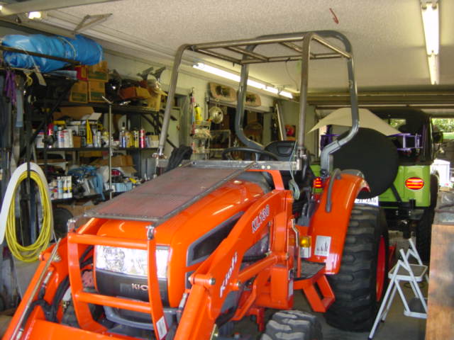

Am thinking about weilding supports to my ROP, then attaching a canopy to the supports for shade. What do you think ?

Good looking bolt-on brackets are simple to make and theres are no change of damaging the ROPS. Besides with brackets, they are movable, removable and adjustable. Gives you a chance to be creative.
   / ROP #4
That's more or less what I did, works great. Some folks get antsy about welding on your ROPS, but you'd have to be pretty bad to damage the one on a Kioti, it's a very heavy wall tubing.

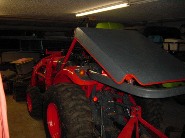

Redrocker, your photo is aptly named.:) That's a nice setup, two ??s.
1) Does your canopy frame detach from the ROPs easily? for folding ROPS if needed(I need to for garage access).
2) What's the cage/shelf over the hood for? Tool portage?
   / ROP #6
After bouncing a log off my hood, I decided to add a little protection.
Here's how you get it in the garage, pull the two front pins and fold it back.
