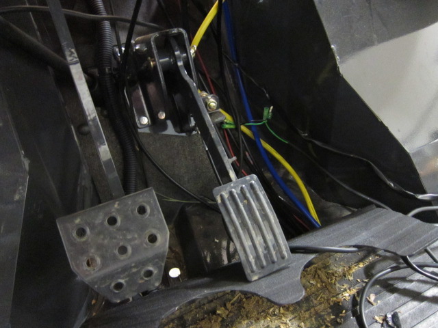

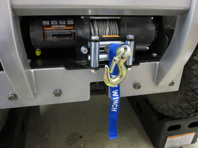

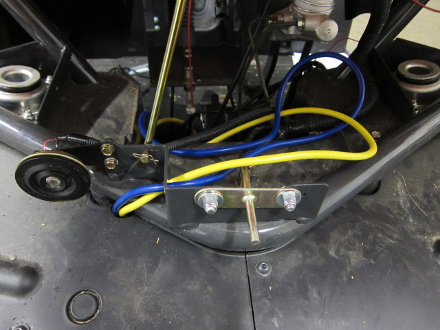

I have just about finished the install. Here are three pics showing how I did the routing and the installed KFI winch. (I still have to route the control wiring and put wire ties on everything.) I just did not see any other way to get the power wires out of the winch cubby area to the floor wiring troughs.

In the lower left corner of this pic....that round plug comes out and the wiring will go right down through there
Looks like your method works but I would be a little concerned about chafing. I didn't understand which section of wire you were running, I thought you meant getting them through the tunnel and to the battery.

What I did is run the wires through the floor channel under the rubber floor mat, followed them up next to the gas and brake peddles next to the other factorcy wires. Then along side the tube frame thats under the hood and went to the winch cubby hole. No drilling.

That's how the factory kit is to get the wire under the hood. With the factory kit you just take a socket and knock that 1" or so diameter ring out. You wires will go straight down to the winch.:thumbsup:

I will add that the the power cables can take a little persuasion to to get through the floor channels. There are other factory wires run through them and its a little tight. I used a metal coat hanger and fished the wires through. Now, you really have to look for them when they pop out below the battery, because theres alot going on down in that area.

OK, that works! I have put the power wires in a 3/4 inch split flex wire conduit too, so that should prevent any chance of chafing (I think I would do that even if I ran them over to the 1 inch plug.) That plug just looked like it was too far out under the hood. Here is a pic of the finished routing.

Nothing wrong with that install at all. Looks great. Thats where my wires go, except one on each side of that tube support right down behind the black plastic cladding.
