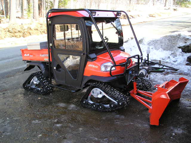

This is a RTV I converted to a snow groomer. The acessories include:
Tracks
4-way semi-U grooming blade with integral frame,power up & down with float, power tilt
4 hydraulic rear mounted remotes
4000lb winch on receiver mounts for front & rear mounting
Brush cage with limb risers & body side bars
Pintle hitch
I will be pulling a 5'W x 10'L drag for x-country skiing.

Nice looking rig. I would be interested to know about how much just the tracks set you back? Where did you get them?

I don't know for sure what kind of tracks those are. They look very similar to the Tatou tracks I run on mine. I can go through anything with my Tatou's. You can find them or a dealer at e-totou.com. They will run you about $3500.00 give or take a little. The RTV is very heavy so you need to get the right tracks otherwise you will have some failures soomer than later.
The tracks are the best accessory I have ever purchased. I turns your machine into a wonderful snow machine. You can pull more than every with a let of tracks. If you are thinking of getting a set just do it. You will love your new machine.
