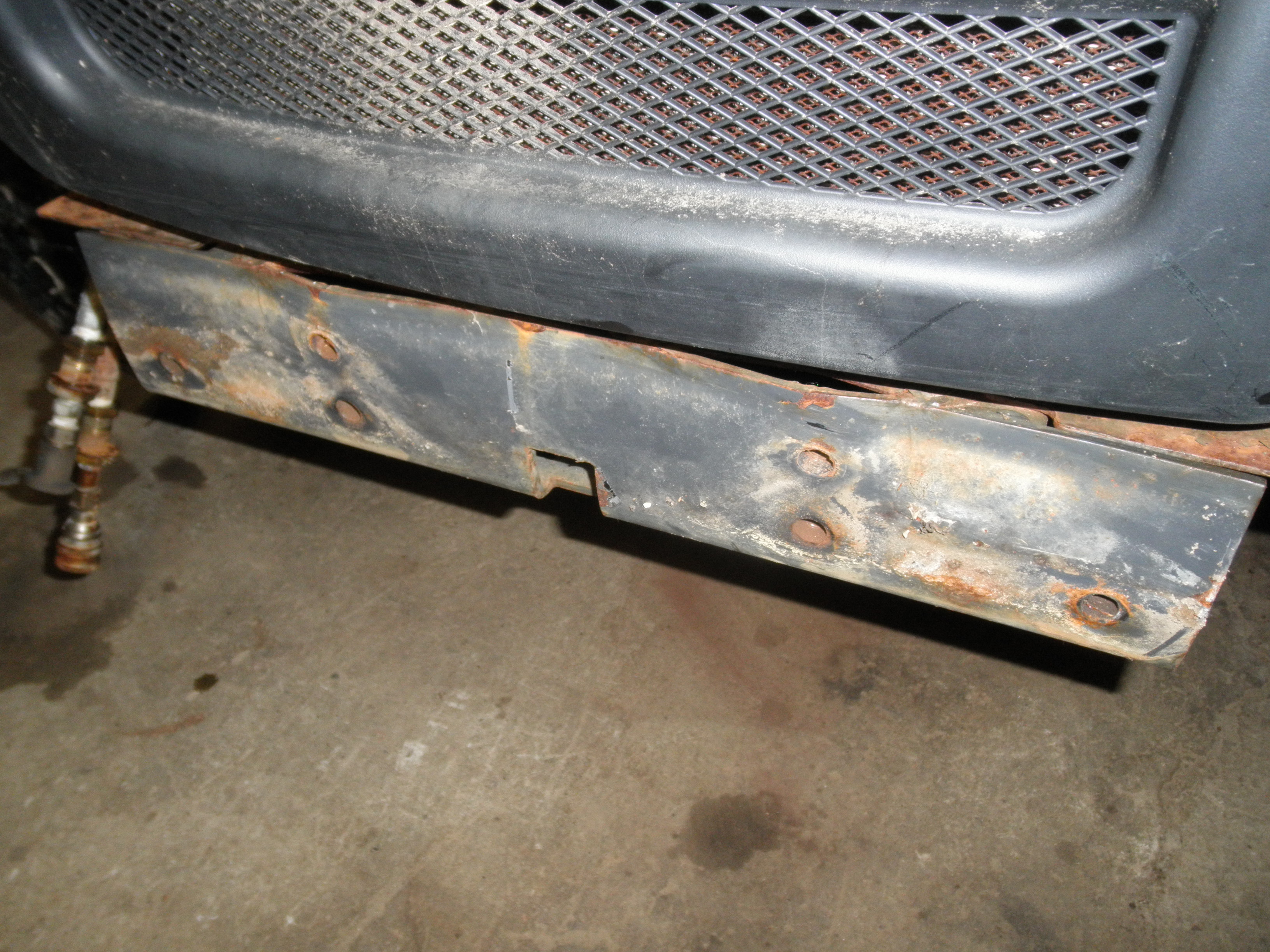

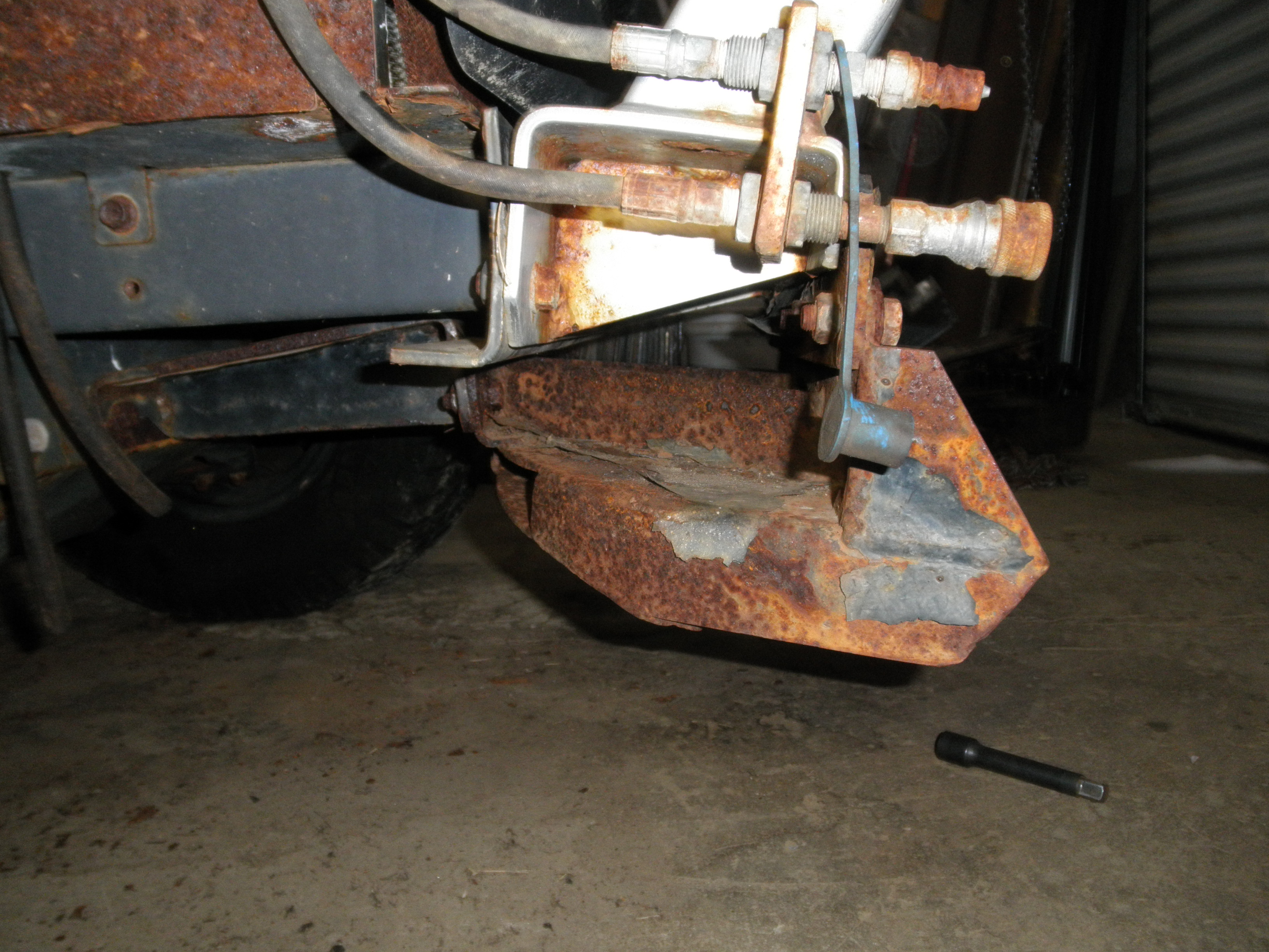

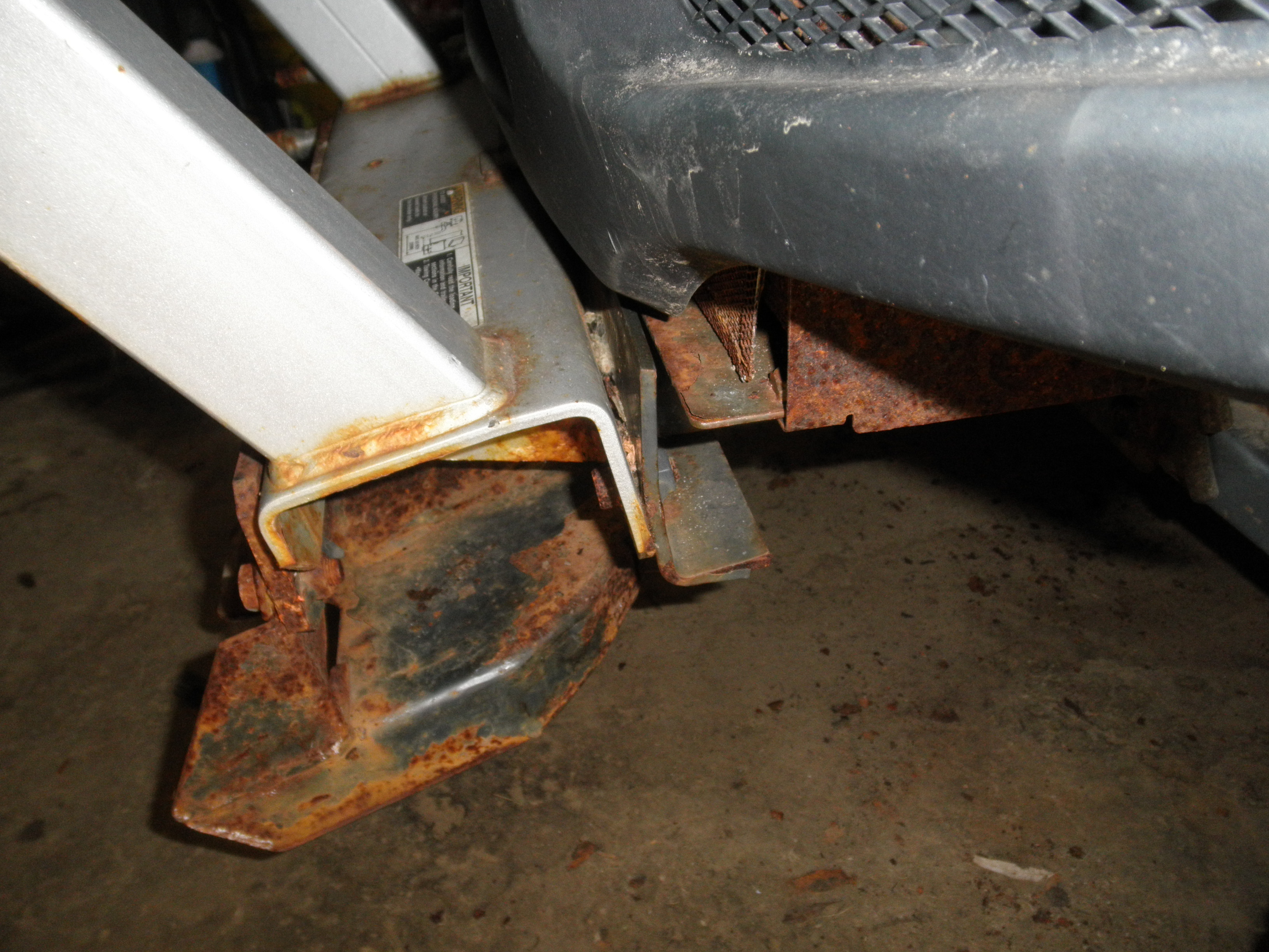

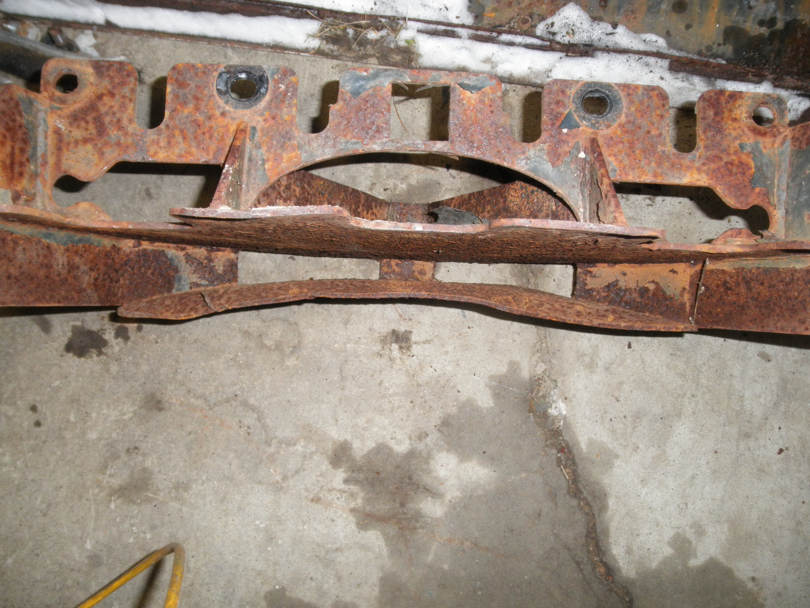

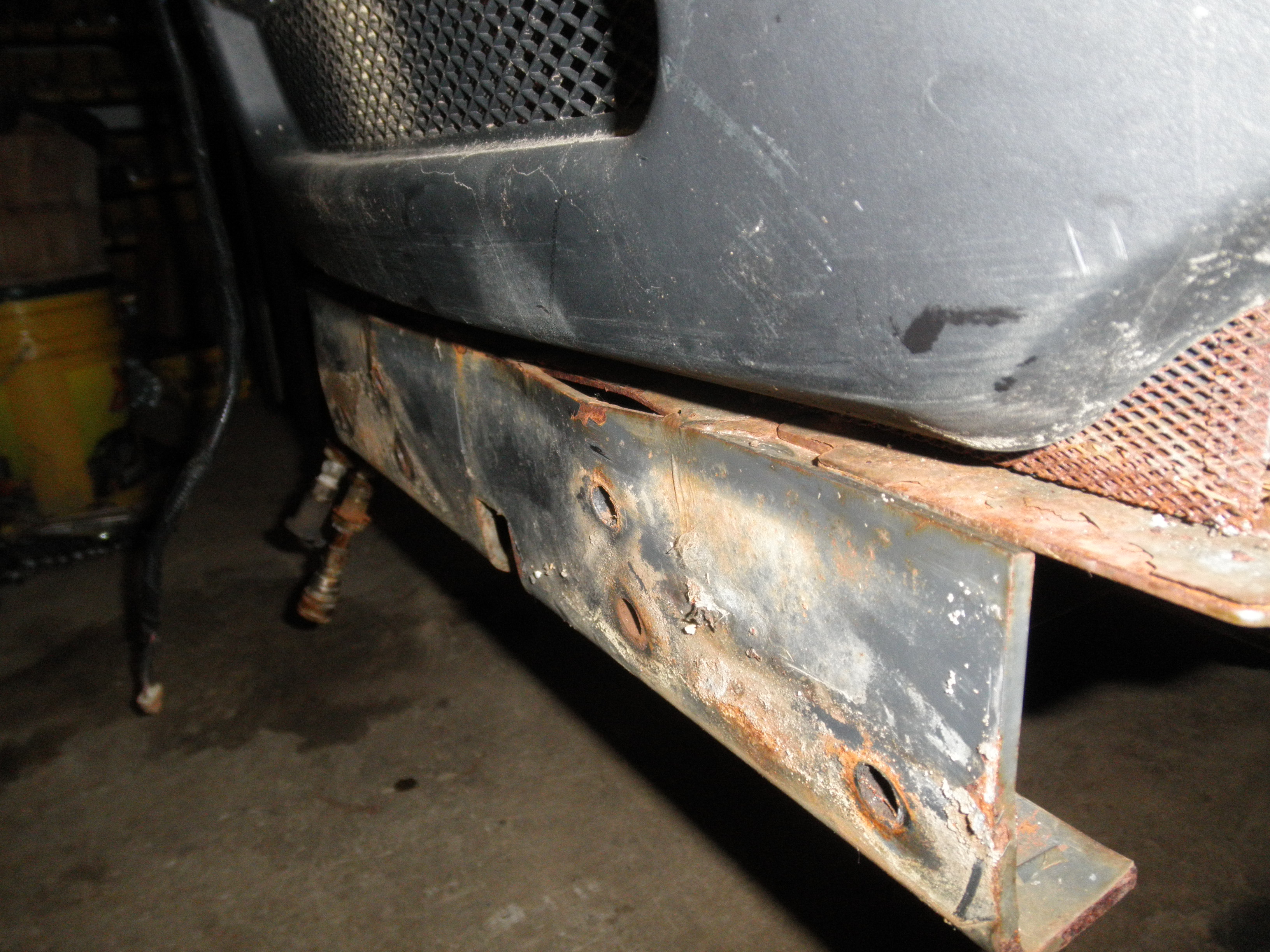

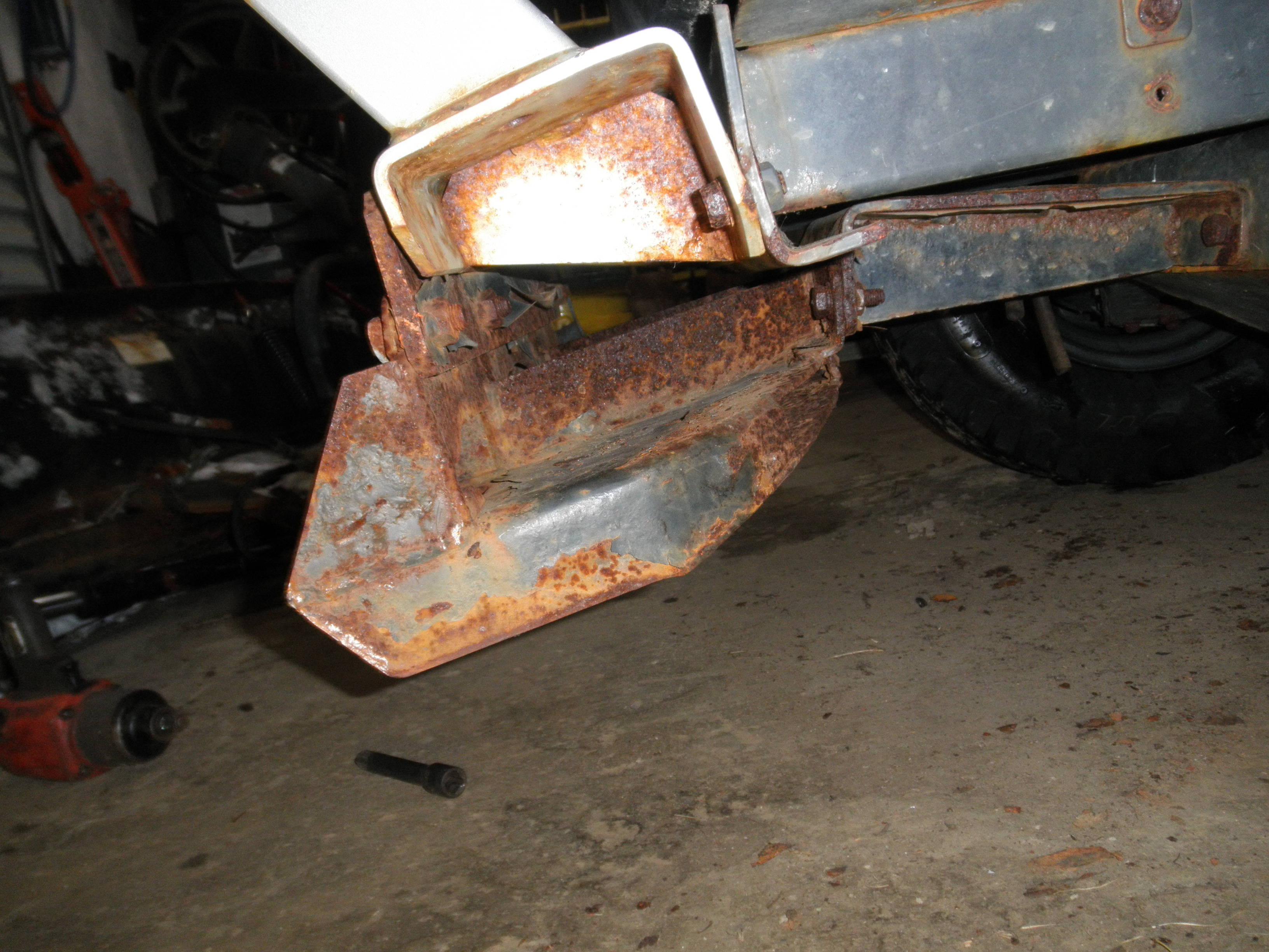

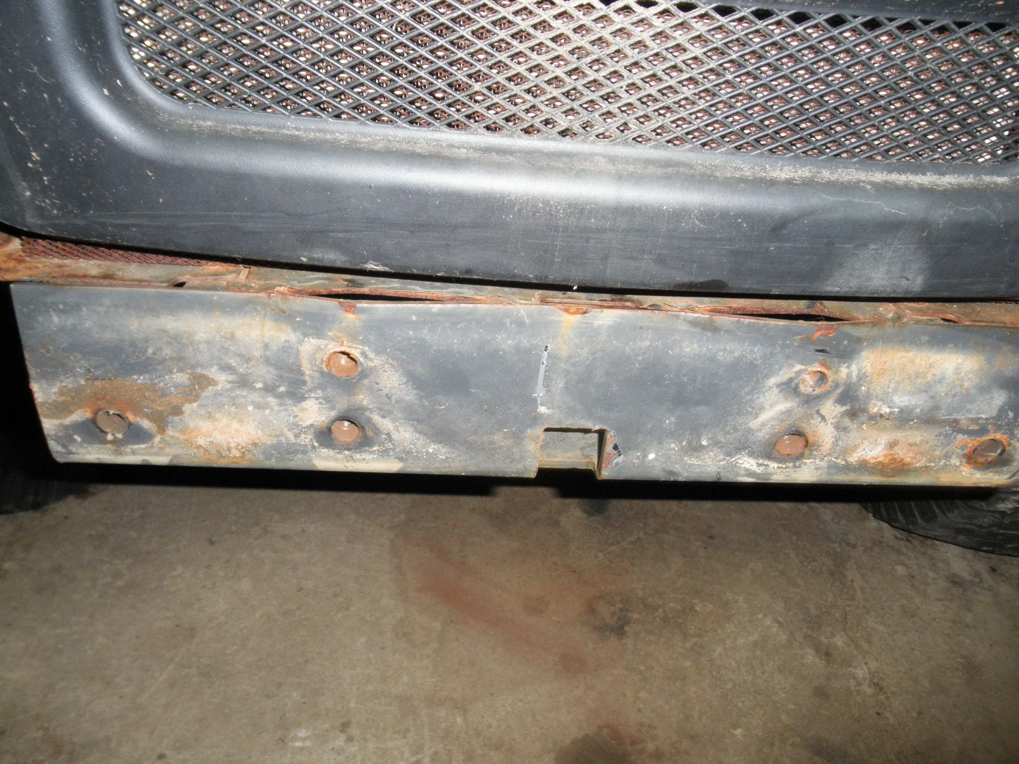

Just bought a 2009 RTV1100 from an auction with a curtis plow. Would anyone have a copy of any documentation [owners manual] for the plow? The mounting plate wouldn't allow the plow to mount up, looks like it could have been jacked up using the center of the plate. I removed it and pushed it back out using a spreader on the pora-power, now it will accept the plow. It also looks like the plow pulled down on the mount and grill guard. Any one else have this problem and what is a good fix?

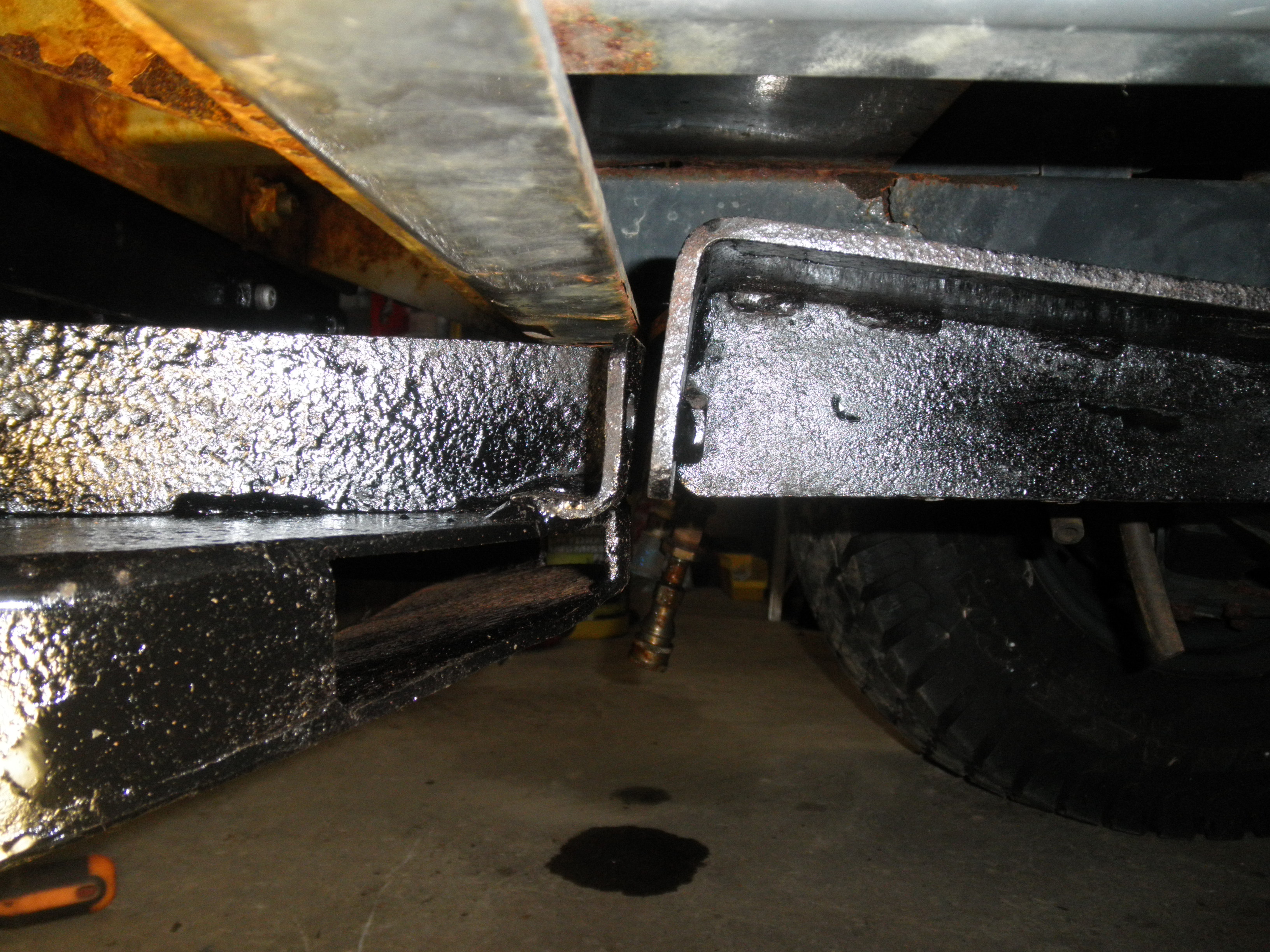

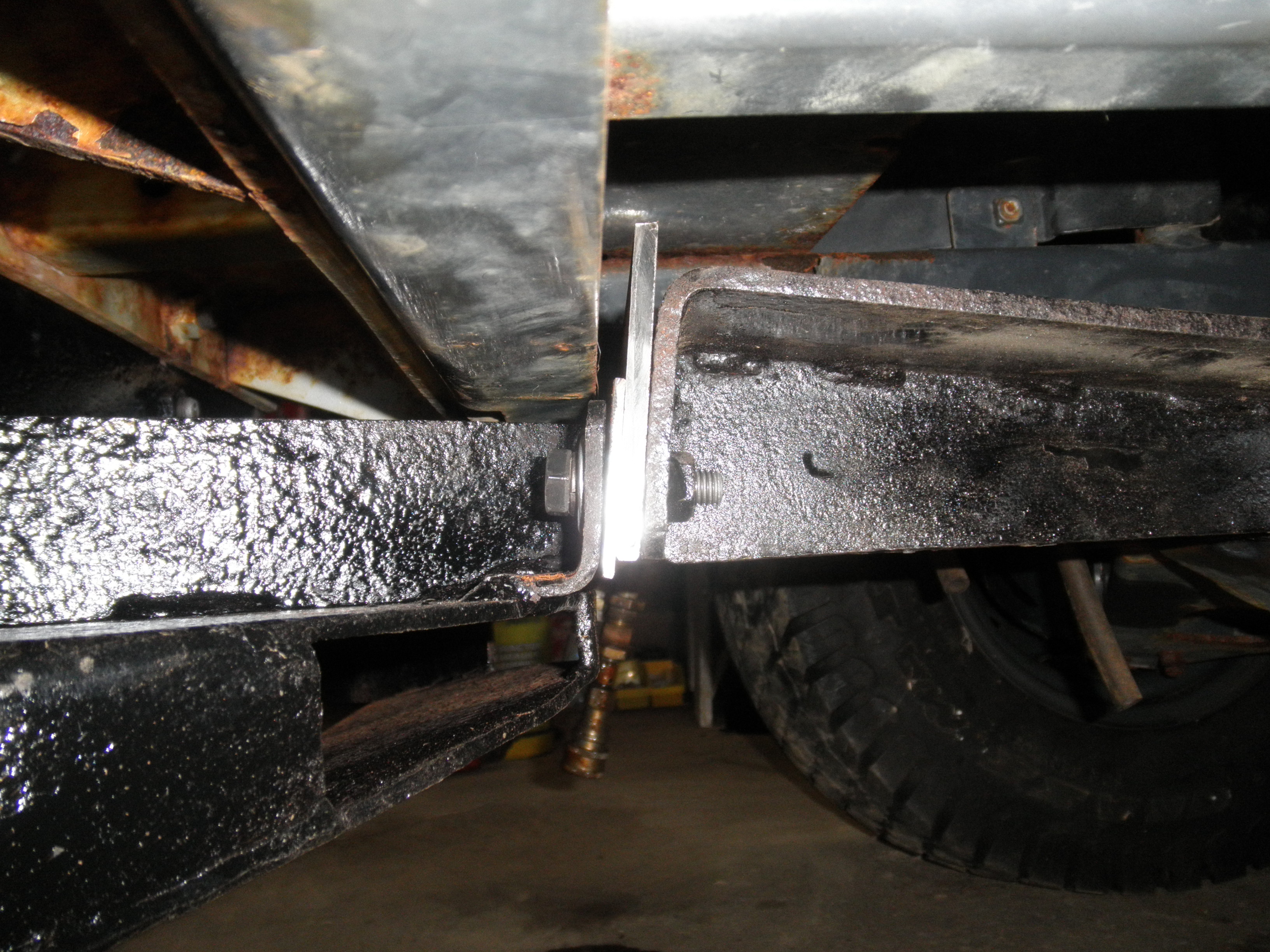

I think I know why the guard and frame was pulled out. After beating the frame and guard back in I put it back together and found that there was a gap underneath. I guess that a part must not have been right and when it was assembled it pulled the front down and deformed everything. I made up a spacer and although it is not perfect it works for now. I still would like to find the instructions for the plow.
