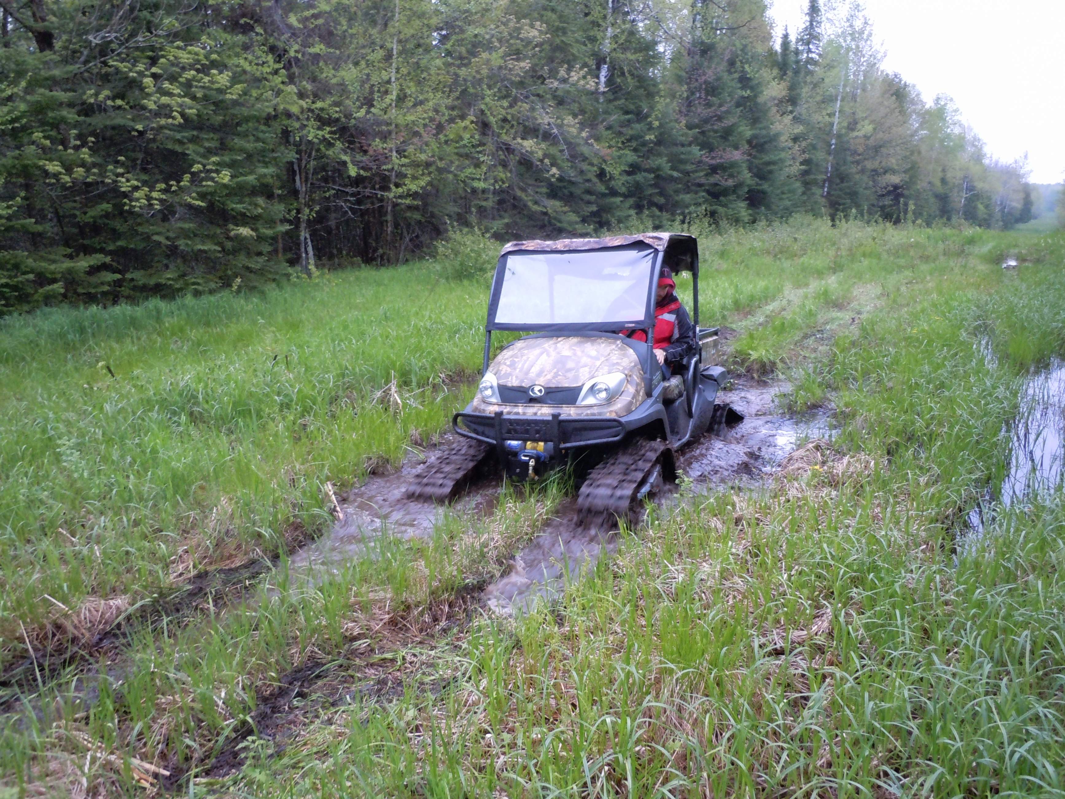

Well it's late but I finally go around to doing more videos. Took these before I switch back to tires for the summer. It's the only water/mud I could find right now but as deep and slick as some of it was these tracks will go through it all. My final opinion on tracks for the rtv 500 with utility use in mind is 2 thumbs up:thumbsup::thumbsup:

Not excited about the speed. I knew it would be slow and that is why I'm putting the tires on for the summer. I'm happy that nothing seems to stop it. I was worried that the 500 wouldn't have enough power to keep it going or that it would sink out of sight as it weighs almost a ton with the tracks and two people. That said, as any 500 owner knows it's like trying to climb a hill in H, you can't, it needs to be in low but when it is it never bogs down.
I've been in 2-3' of powder snow, 2' water/mud and it just keeps going. I'm not into trail riding, if I was I would have bought a razor. This works great for getting firewood in the winter and spring, running around in the spring for maple syrup and pulling my ice house on the lake. From what I've read about trail grooming the cat is the only way to go unless like me you just groom a few acres of trails. I could see why you would not have liked the 900 if you put on some miles.

Didn't get it stuck yet. We did go back and forth about 6 times on the same trail. 4 wheelers rut it up in that low land area and the tracks did add to the ruts but mostly they pushed the water out and made it drier:mad:
One could probably get this stuck if the ruts were so bad that the underside would get hung up in the center but I couldn't find anything that deep, maybe a jeep or logging trail. I know that for sure the 4 wheelers will not have the clearance to make this trail now that I've been through:laughing:
