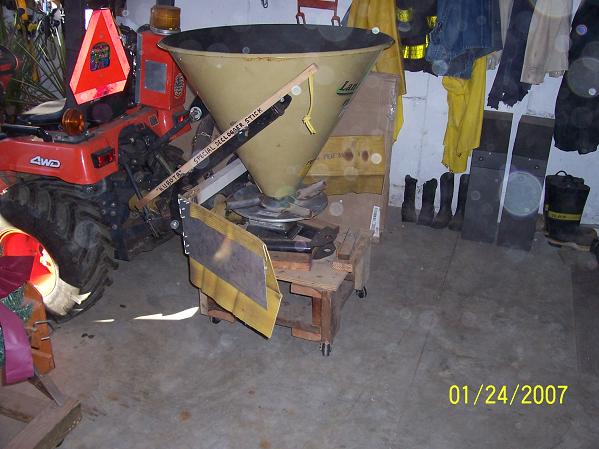

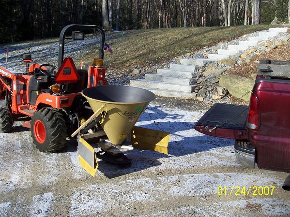

For those of you that use a rotary spreader to sand your driveway, here is the latest brainstorm from my shop.

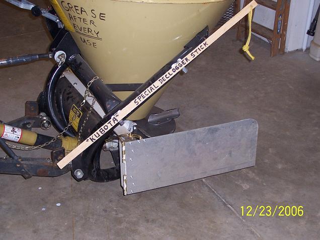

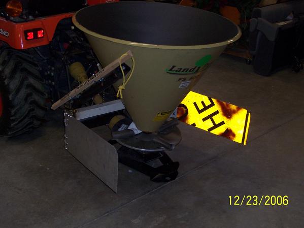

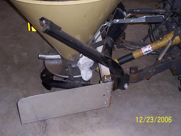

Last winter, I decided that I needed more sand on my driveway, than on my lawn & woods, when using my rotary spreader. I made a crude set of wings to limit the spread with some plywood. They worked O.K. but were not adjustable.
Last week I started to design a more durable and adjustable add-on.
I welded a simple frame out of 2" angle, bolted to the spreader, (removable) to attach the side plates to. I used a couple of old door hinges to attach them to the frame. The wings adjust by using hardware called "lid supports", attached between the frame and side wing. The side wing is a piece of old aluminum traffic sign. As with all these projects, adjust as needed to your spreader. I also added a "unclogger " stick to the side of the spreader, with spring type broom handle holders.
With this set-up, by moving the side wing, you can control the sand spread width.
A side note on spreading sand. If your public works dept. has a public sand pile for your use, it usually has salt mixed in. This will help keep the sand from freezing into a solid pile. The salt will also help with the sand flowing from your hopper to the spreader.
I bought 6 yds of regular sand, delivered two years ago for my use, that froze into a 6 yd. lump. I ended up driving to P/W to get unfrozen sand anyways.
No snow yet...Merry Christmas.

Good job. I like the kubota stick, how much was that? And those flaps made from an old roadsign, priceless. Recycling at it's best.

Sand is gonna wear through that aluminum plate pretty quickly, and it's probably gonna be noisy. A sacrificial wear plate made of plywood, or even better, UHMWPE from McMaster Carr would solve both probs.
   / SANDER/SPREADER ADD-ON'S

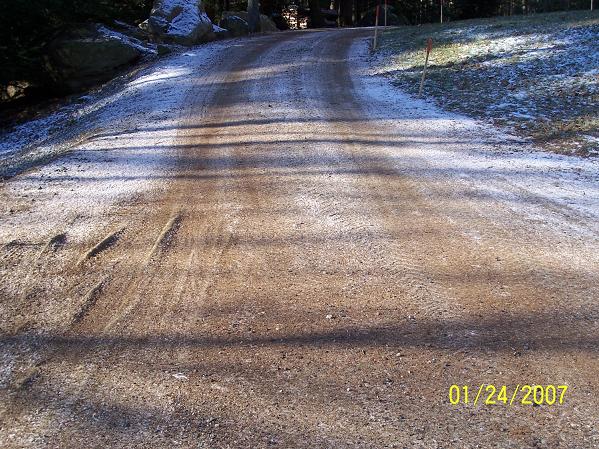

While still waiting for winter to arrive, NW CT. finally got about a 1/2" of snow earlier this past week. I could wait no longer to use the tractor, so I sanded the icy spots of my driveway this morning. I took Danno1's suggestion, and added some rubber wear shields to the aluminum wings. It is old 5" firehose that was discarded from work, from my large junk collection of stuff that I know will be useful some day.

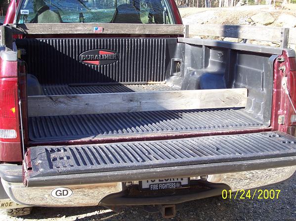

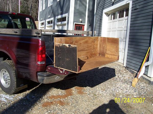

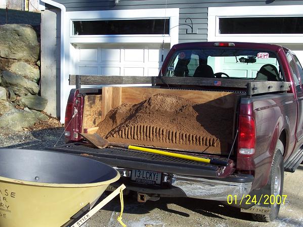

Also posted is a sandbox that I made of scrap plywood for my truck, to keep the bed clean.
Finally is the dolly that the sander rests on when off the tractor, but used when sand is stored in the sander, ready for its next use.
While the some members of TBN might not understand those of us in the north, snow & ice is just another opportunity to do some tractoring. Still no storms in the near forecast....
