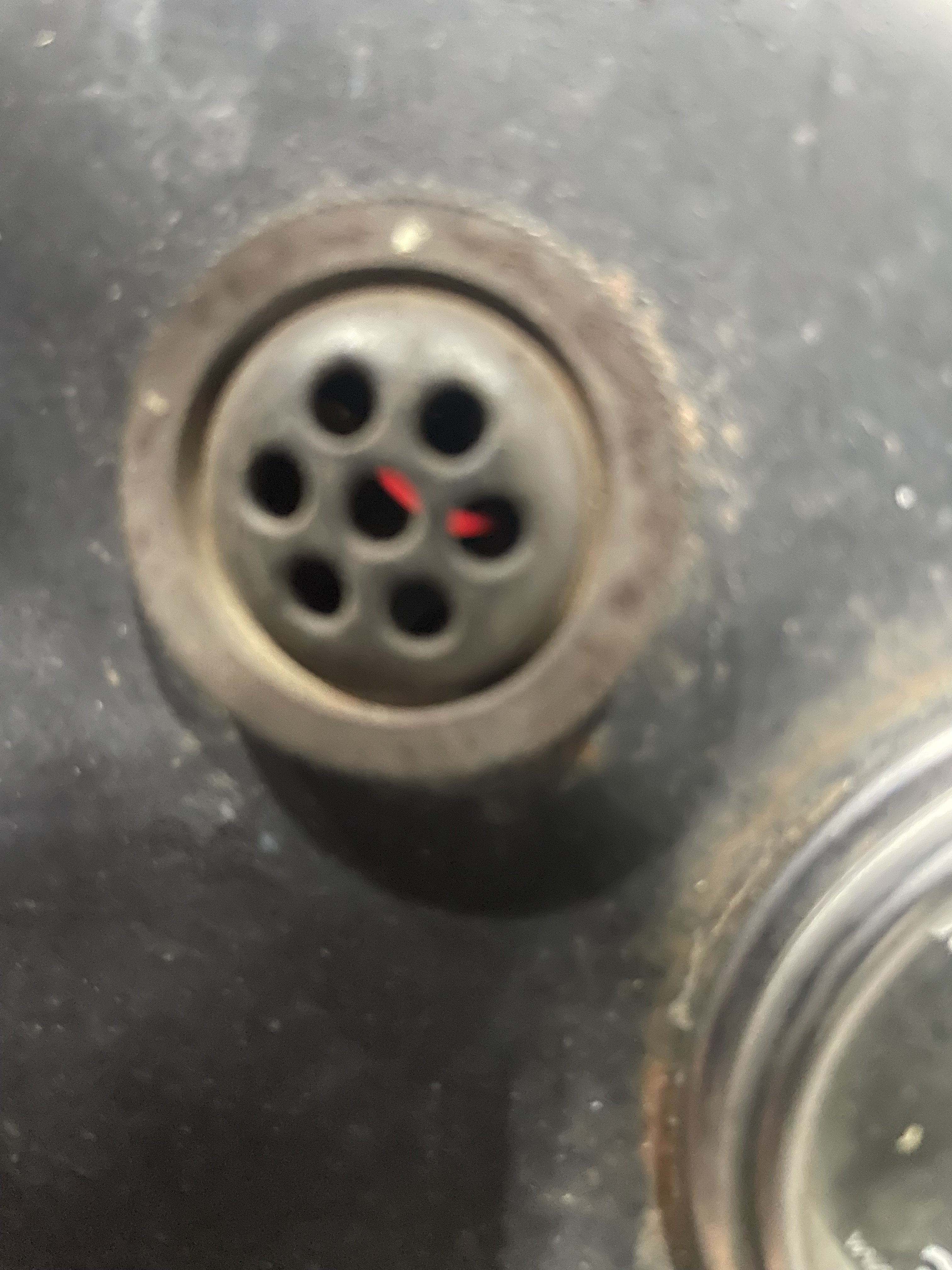

It will crank and is sounding normal when starting. Will not turn over. I have verified fuel is getting to injectors. Put new battery to it. And verified glow plugs are working properly. My next step is injectors but I’m hesitant to pull those out…any ideas? Will not turn over with starter fluid either. Video of it in link below.

Make sure the air filter is clean and the air path is clear. HOW did you verify the glow plugs are working correctly? Did you verify they're getting power? Frequently the connections at the glow indicator on the dash corrode and you get no power to the glow plugs.

I disconnected intake to bypass filter to make sure it had clear air flow. Yea the indicators on dash been busted for years..I Took them out of block ran a ground to them and watched em smoke and get hot while not in block. I didn’t test them for very long just saw smoke and knew they were heating up and put them back in block after verifying that.
Glow indicator is good.
