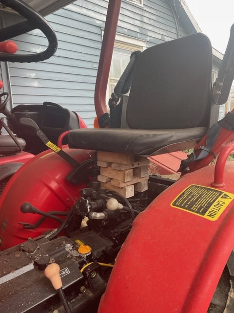

I would appreciate that a lot. The YM147 seat is setting on a set of homemade Lincoln logs, no kidding. Apparently, it had a very portly owner two owners prior who made the modifications. The picture isn't good, but you might be able to see his modifications. Needless to say, the original brackets are not there any longer.

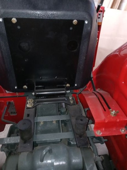

I swapped out my Ym2310 seat which is basically the same as your 276. Picked up a generic seat and just re-drilled the existing mount to accept the new one. I'll look up the seat when I get back to the house later.

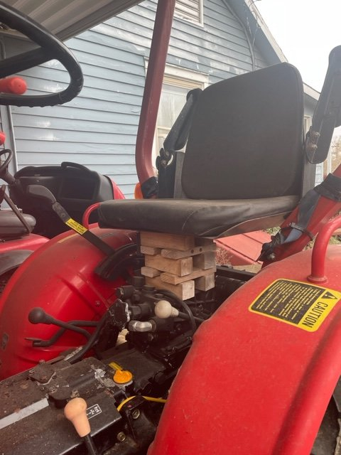

Here are a few better pictures of the Lincoln log methodology applied to the YM147D seat.
Your YM147D looks quite different than the Lincoln log YM147D.

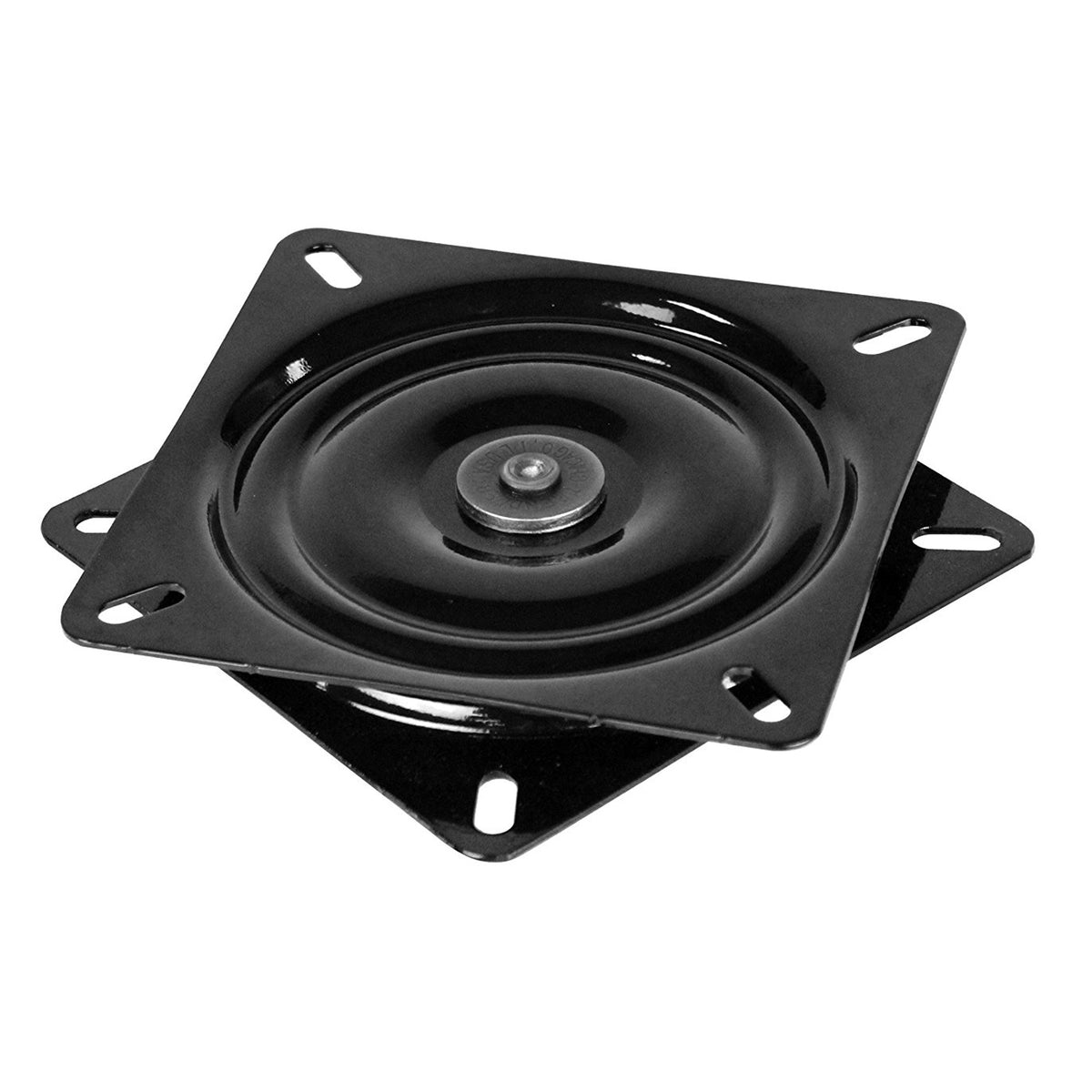

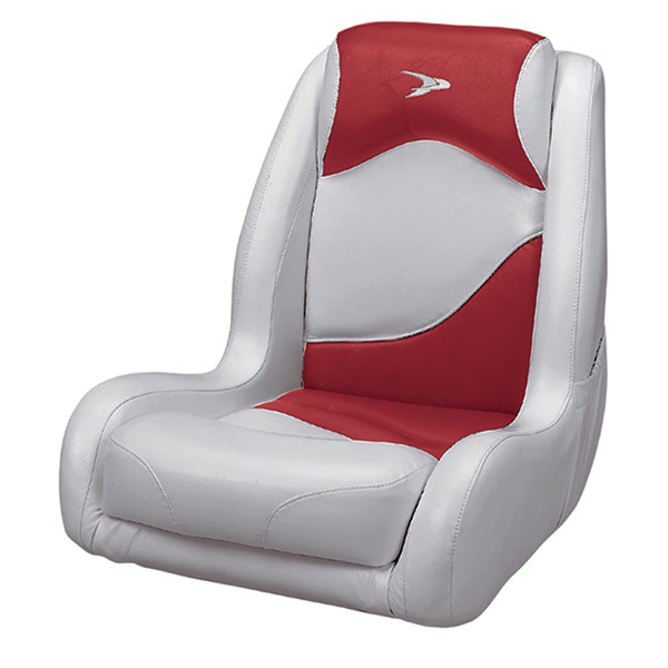

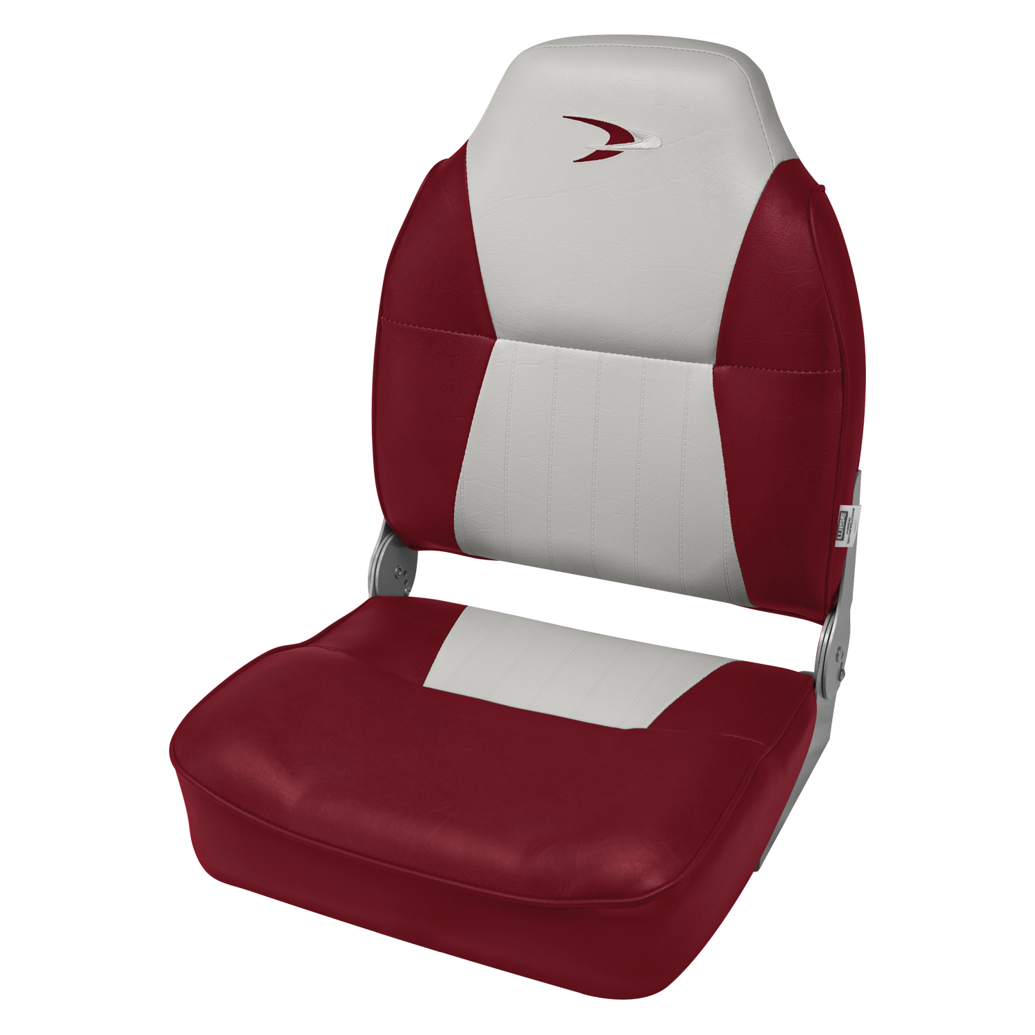

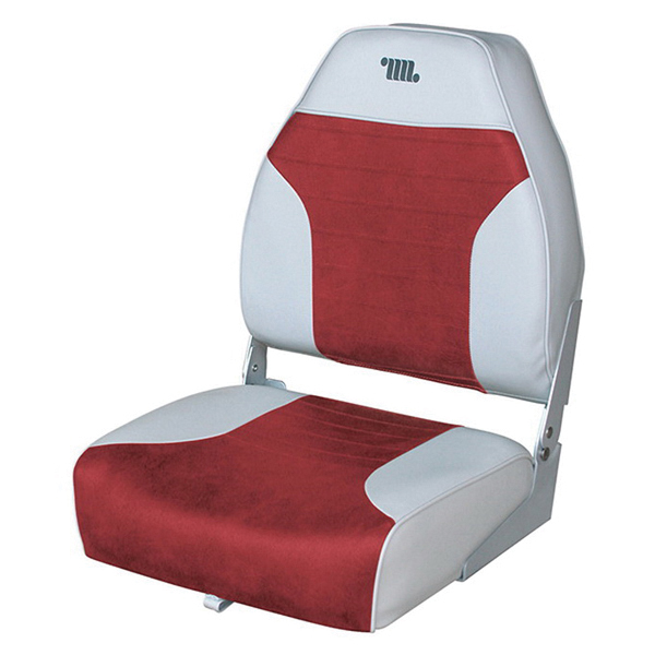

Back in 2016 seat prices were reasonable for a high back at $49. Today it's over $100.
My new seat went badly outside of warranty. Reason, UV rays. I began looking at seats and noticed not many at all had UV protection except the Marine seats.
Wise makes several that would work and are extremely comfortable. I chose red because of Yanmar. They have black, gray, green for JD, and other colors too.
And just like the Yanmar option for many of the YM2xxx models, you can get the seat to swivel to help get in and out of the machine or to help turn somewhat backwards to look behind. The YM2310 was the first listed model with the option.
