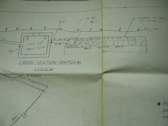

I took some picts of my 1973, approved septic design. This one is a
X section of the system.

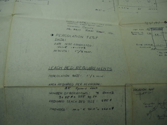

This one is the size requirement.

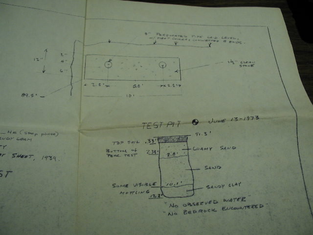

This is of the test pit
