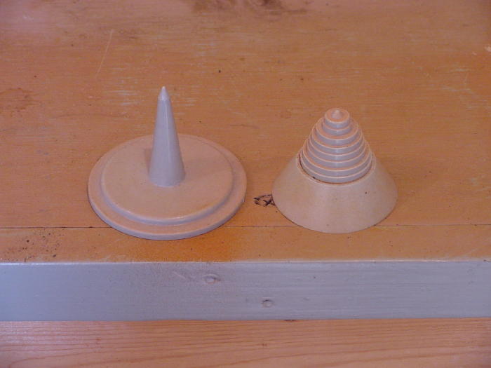

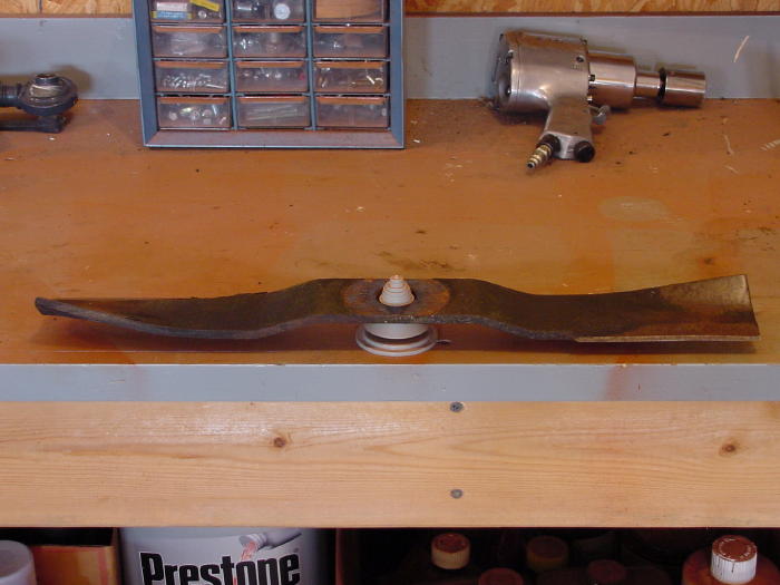

Steelfan,I use a very Hi-Tech blade balancing system myself.Couple of pieces of plastic that will cost you close to 2 bucks at about any Hardware Store.
The sides of the cone are graduated to accept about any sized blade,it will quickly show you which side of the blade needs to be fine tuned.
Before sharpening I always try to take the grass "build-up" off the blades with a bench grinder equipped with a wire brush.Also use a hand file too really put that finished edge on the blades after hitting them with a 4" hand held.
