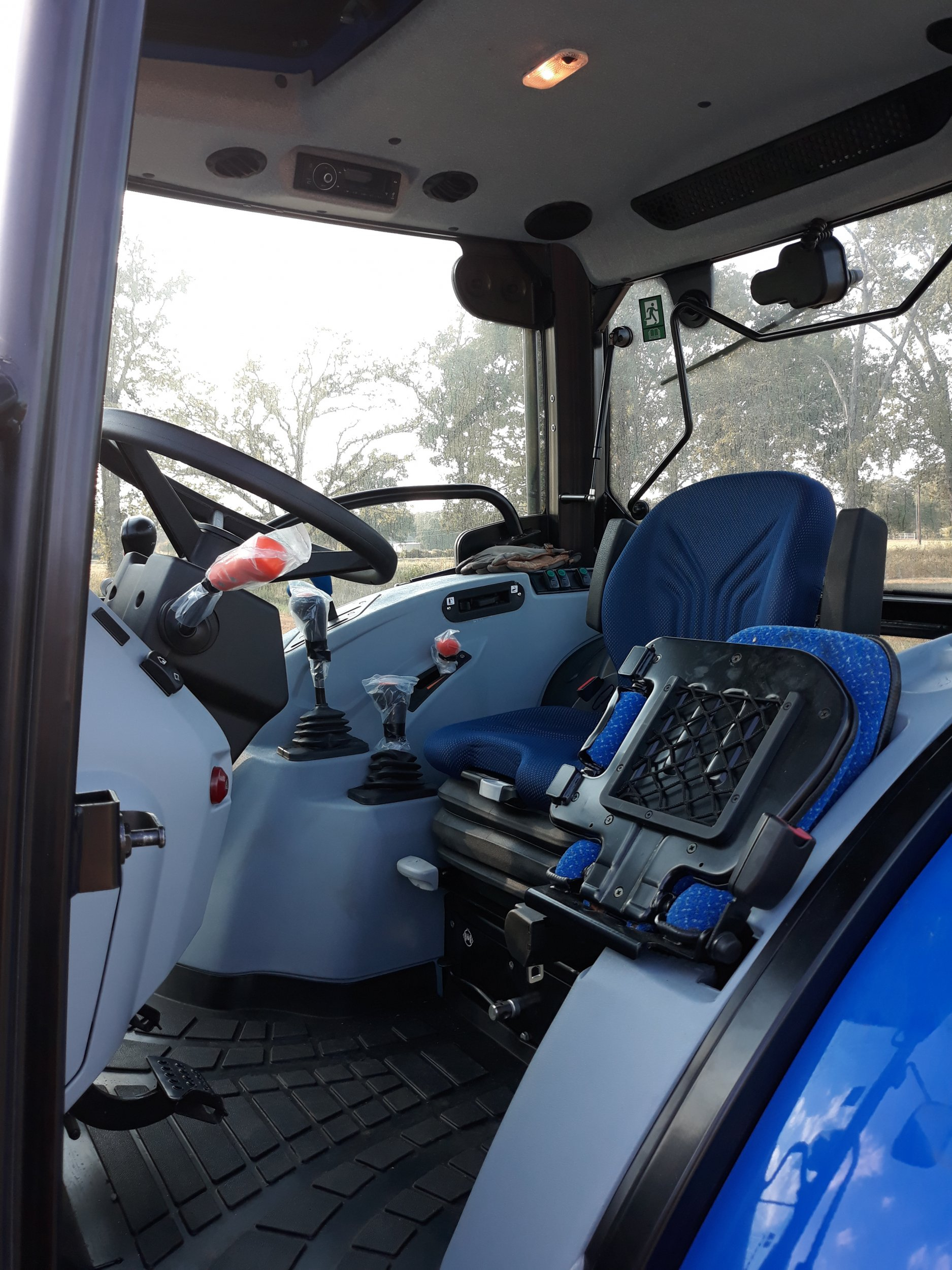

Here is what the buddy seat looks like in my WM75. When folded down it has an extension on the right side that folds down to make it a few inches wider. It is OK for a child, it doesn't do well with adults.

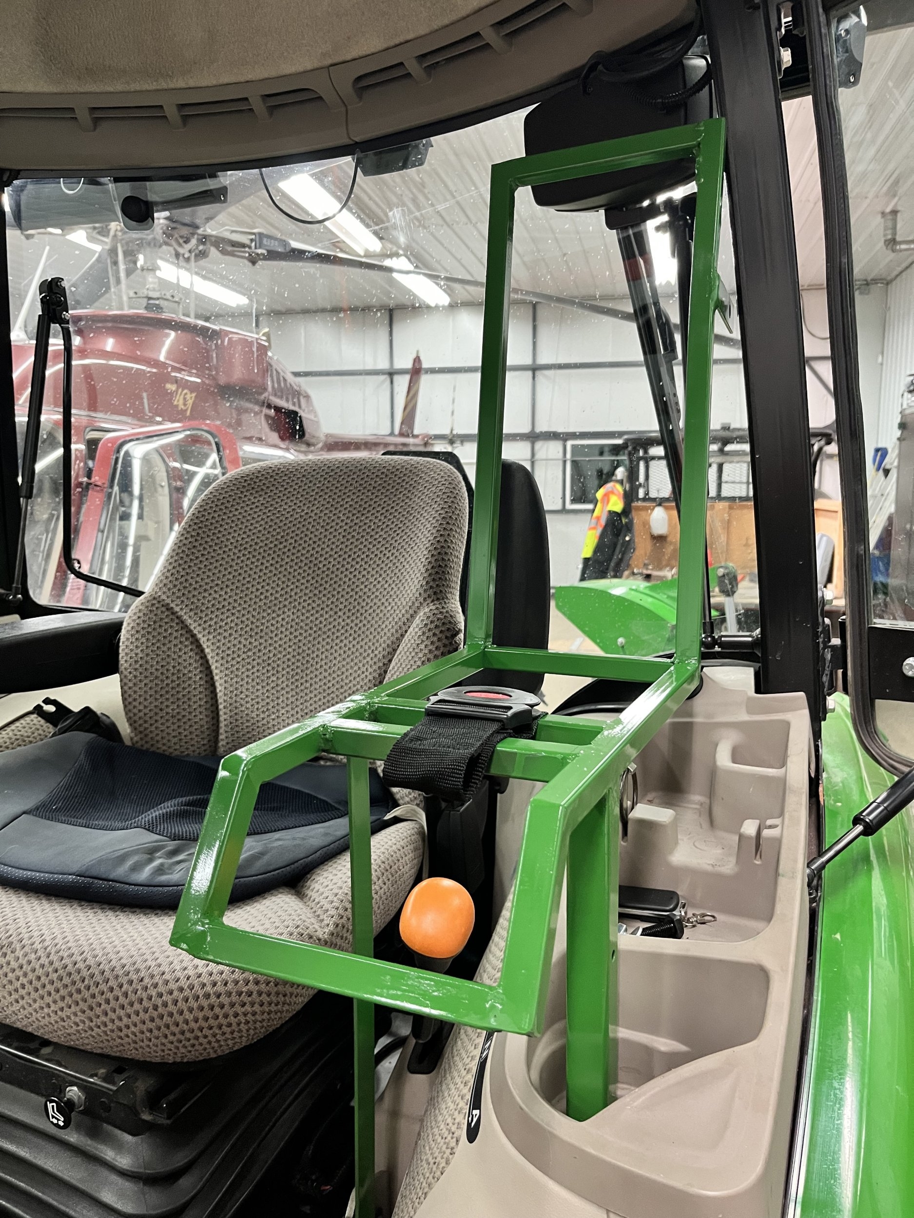

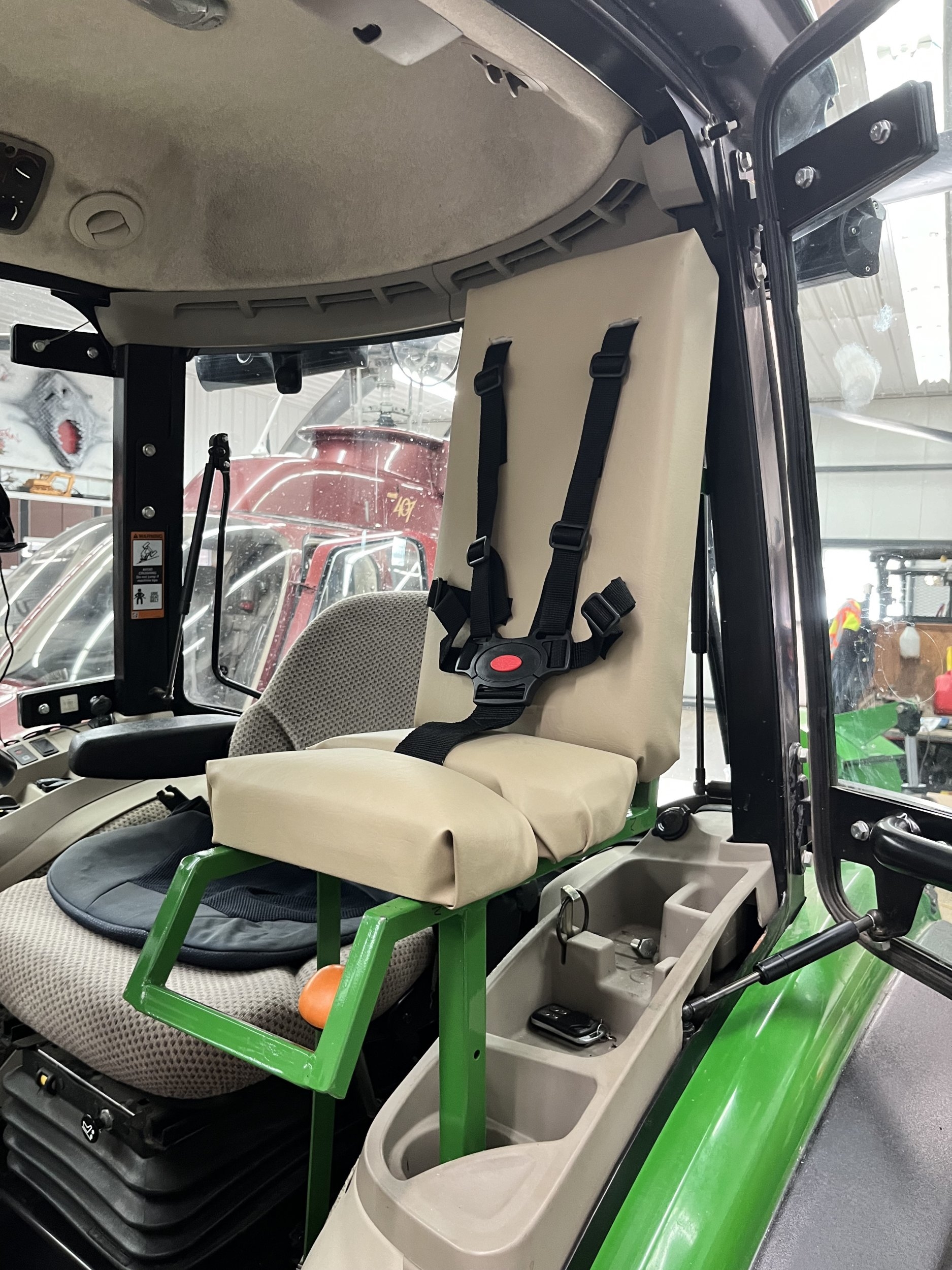

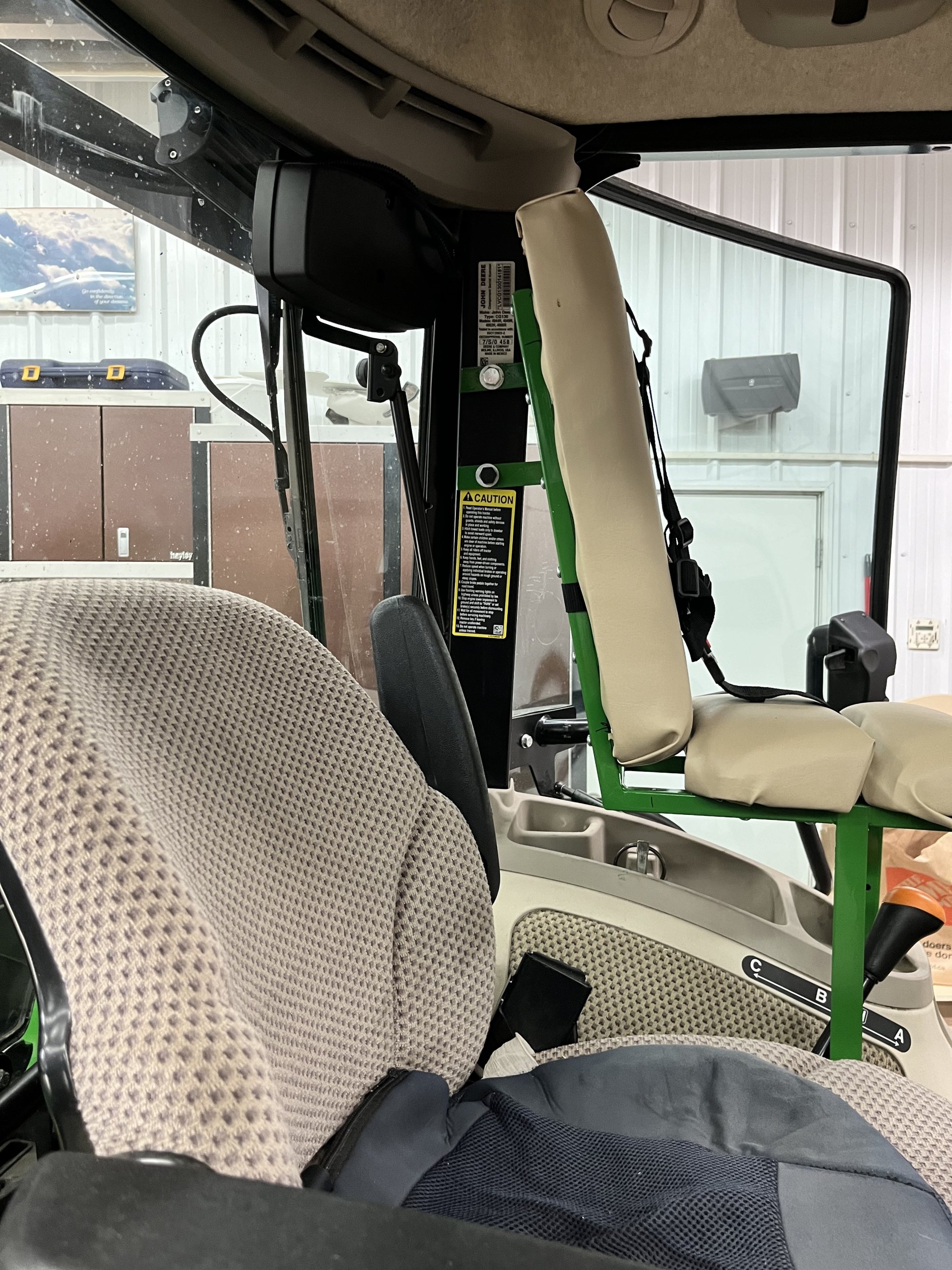

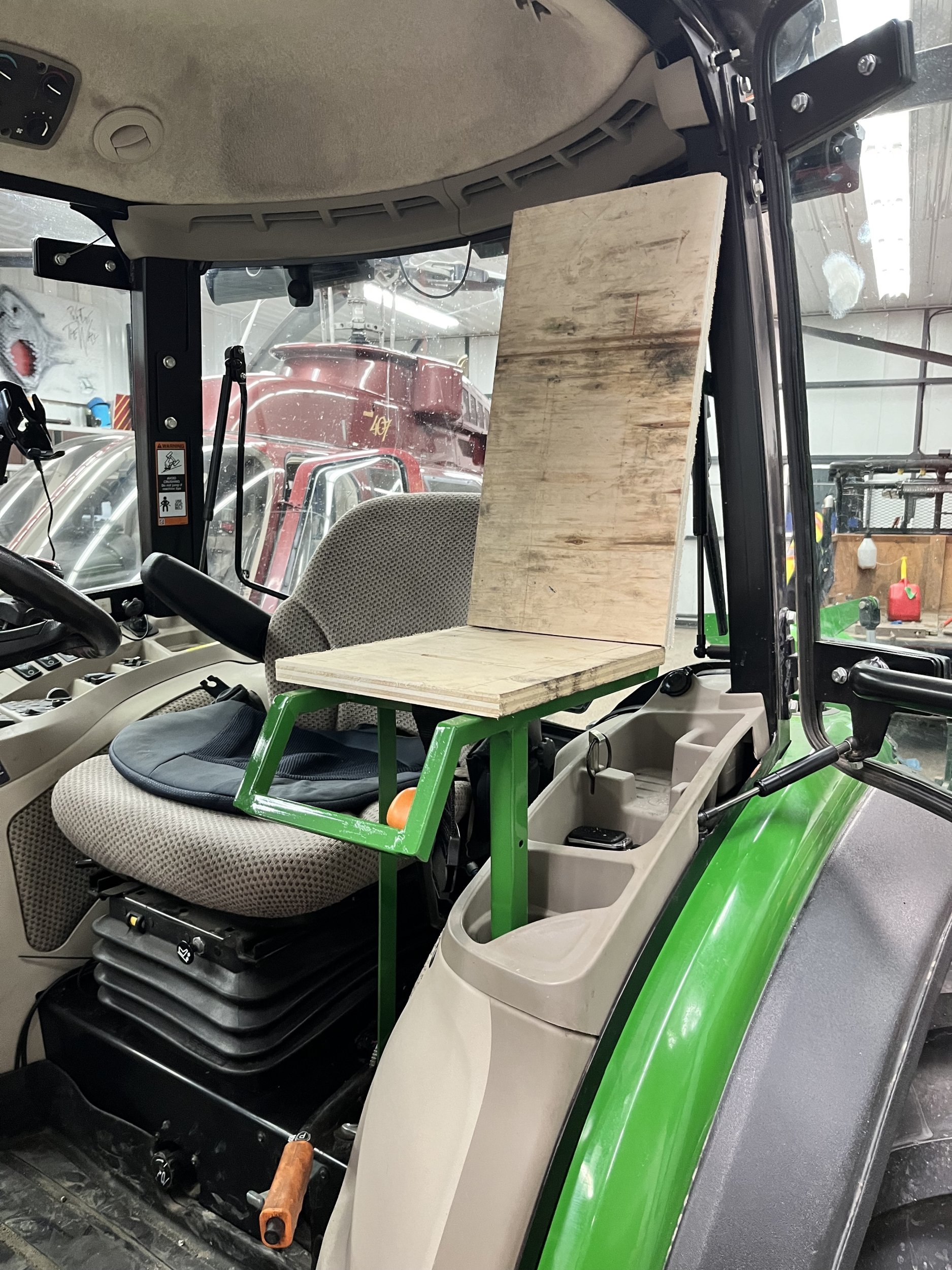

Over the Christmas holidays I began pondering making a buddy seat in my Deere 4066R. I had seen one on an earlier post (I think it was by "bavarian", but I couldn't find that thread again). I thought I would give it a go! I started with some 3/4" square tubing and began fitting it in place, securing it with the two existing threaded holes in the left rear ROPS. I'm not much of an upholstery guy......they don't ask me to wrap Christmas gifts here either. I haven't had the chance to try it with the granddaughter, but it looks pretty sweet. The 5-point seat belt was bought on Amazon and is secured to the square tubing. I'm a fairly big guy, but I can handle the little bit of restriction this gives me.
This is fantastic!! Great job! (y)
Did you make it semi-quick install? If it's secured into threaded holes, might be a good idea to use thumb screws to secure it. That way when the kid isn't riding, you can easily and quickly remove it, to win back that precious space and visibility.
   / Show Me Your Buddy Seat #7
I only have the two 10mm bolts to remove, so their isn't too much effort to install or remove.
