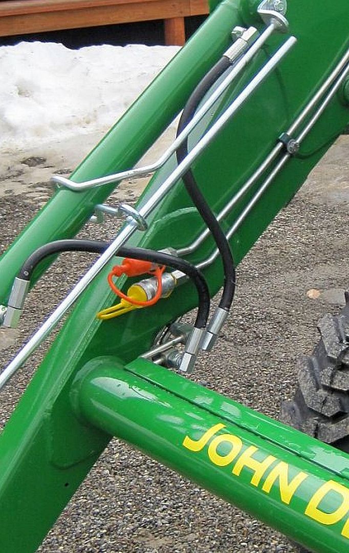

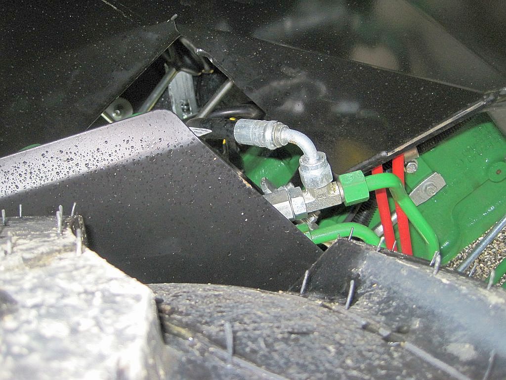

Maybe I used the wrong terminology in trying to describe what I am trying to do with my tractor front and rear couplings. So, I've posted a few photos to better explain and describe my setup.
I asked my dealer to create a coupling connection for my Grapple.
And this is what they did:
"I just laid this hydraulic diagram out with one of my techs and the best way is to add the bw16414 line kit and connect it to the blv10763 (which you already bought). We would create a tee to allow the oil to go to the back as originally planned or to the front if you had a grapple hooked up. The only limitation to this is you can't have something plugged into the back 3rd port and the front 3rd port at the same time (which you wouldn't anyway)."
Tee Connection (Front to Rear Couplings)
Tee Connection (2nd view of Front to Rear Couplings))
So this is what I have for my Grapple.
Dual Couplings for Grapple Hookup (3rd SCV)

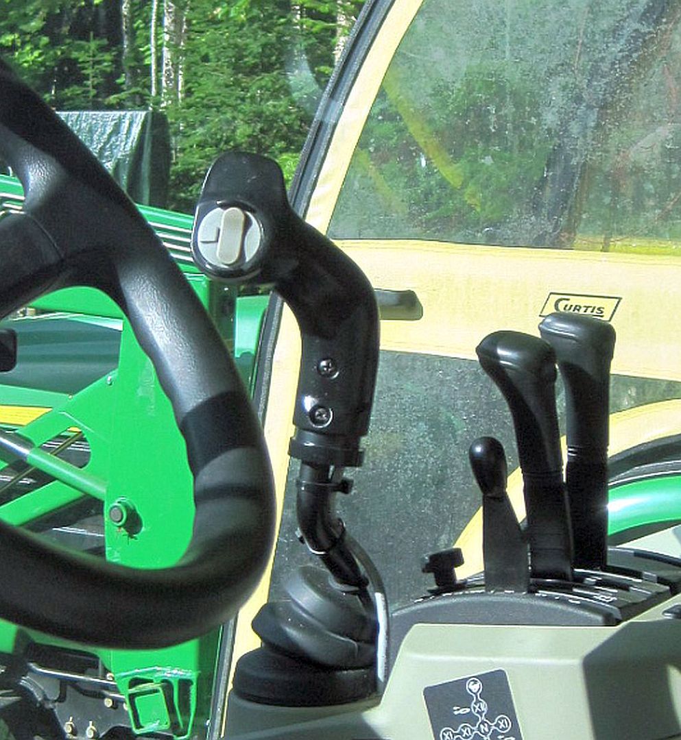

I can work the Grapple using my Joystick and switch on the Joystick.
Joystick and Switch for Grapple

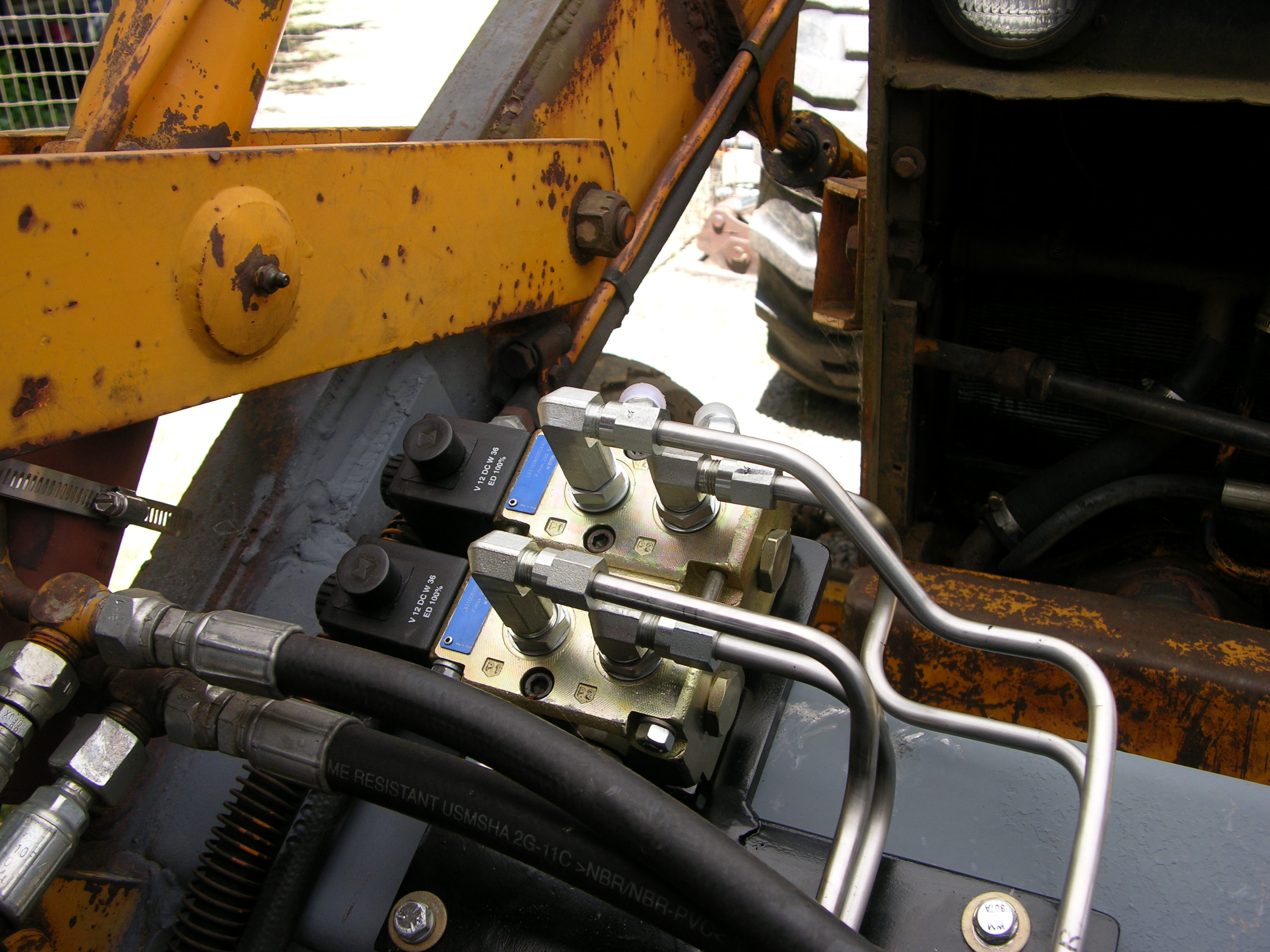

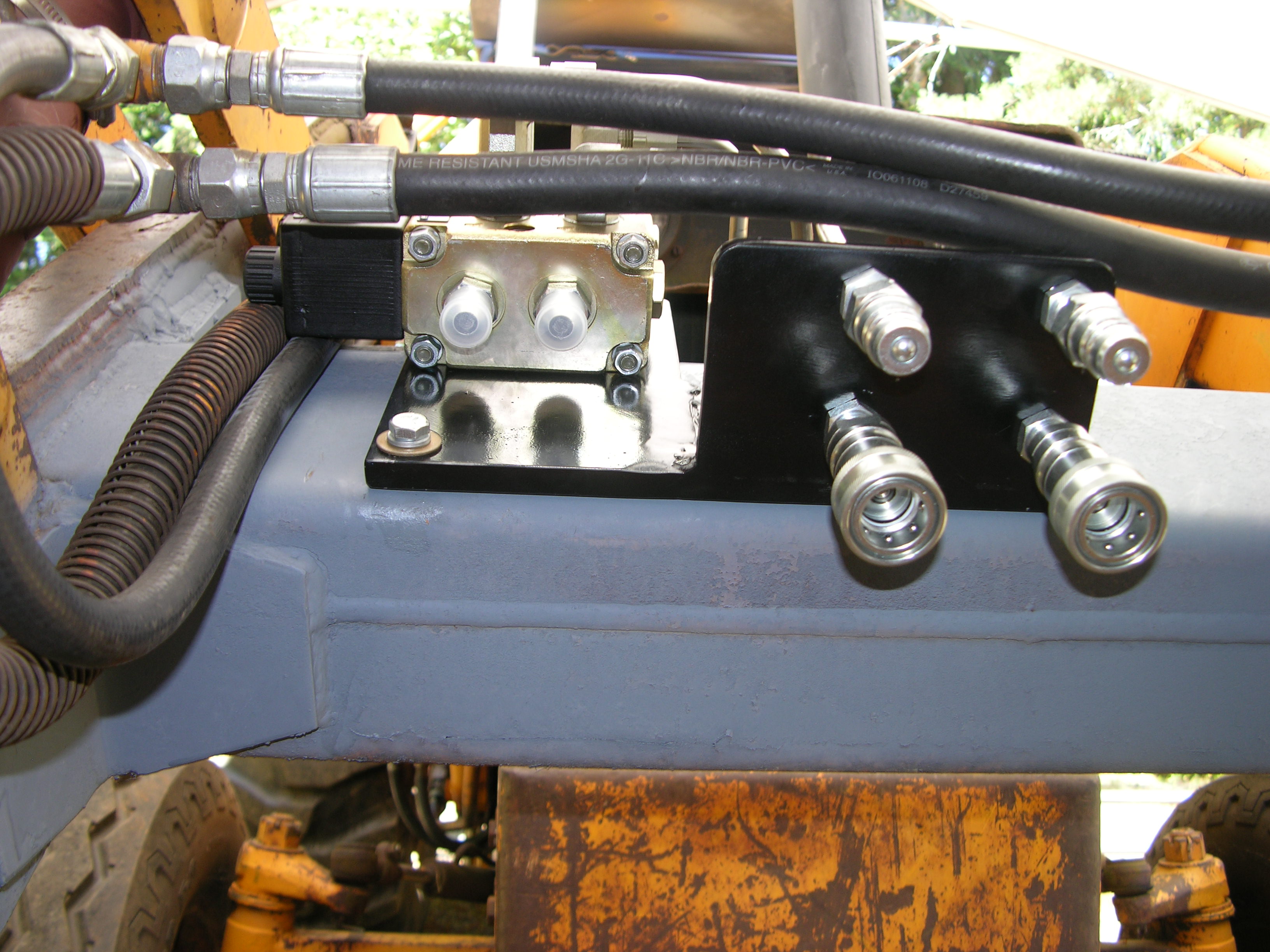

I agree with Aaron's suggestion (AND Erics); that's a very good price on that type valve. At first I thought they couldn't be "stacked" due to the offset on the ports, but if you look at BOTH sides the mating surfaces have the OPPOSITE offset on the other side, so the ports would be aligned when stacked. You should ask surplus center before "assuming" tho, looks can be deceiving. the valves I have use sae ports for single use and O rings between valve sections when stacked...
"stacking" allows you to add even MORE paths just by adding another valve and switch. It looks like this
There are switches available that are built into loader grips, so you don't even have to move your hand away from the joystick to change functions. Try googling "scorpion control grip" for one example.
Looks like surplus center does NOT carry the connectors, but no biggie -
Amazon.com: Deutsch DT 4-pin Pigtail Kit 14AWG Pure Copper GPT Wire, Made in USA: Automotive
Amazon.com: Deutsch DT 4-pin male: Automotive
HTH... Steve
BTW, those "L" connectors on the valves are 6801 and 6801LL, here
SAE Straight Thread (ORB)
Those will allow "over-under" mounts as seen in the pic; regular and medium length will NOT.
