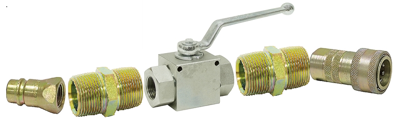

It can be done, if you want to have something that "quick connects" inline here is what you need:
8x: 1/2" NPT Male x 3/8" NPT Male Straight 544-8-6 Adapter | NPT Male to NPT Male - Hex Nipple | NPT to NPT | Hydraulic Adapters & Fittings | Hydraulics | www.surpluscenter.com
4x: 3/8" NPT Carbon Steel 725 PSI Ball Valve | Ball Valves | Hydraulic Valves | Hydraulics | www.surpluscenter.com
OR 4x: 3/8 NPT 8 GPM Prince WNV-6 Needle Valve | Flow Control Valves | Hydraulic Valves | Hydraulics | www.surpluscenter.com
4x: 1/2" NPT Quick Coupler F/F Safeway S2-4 | Quick Coupler Pairs | Hydraulic Quick Couplers | Hydraulics | www.surpluscenter.com
Total $180-$210 plus shipping and taxes
You would assemble four sets like this:

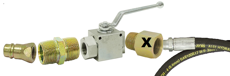

If you are ok with taking apart the hose going to the grapple and the toplink at the quick connect and adding in a inline valve, you can do it for about $100 (plus taxes and shipping) using:
4x: 1/2" NPT Male x 3/8" NPT Male Straight 544-8-6 Adapter | NPT Male to NPT Male - Hex Nipple | NPT to NPT | Hydraulic Adapters & Fittings | Hydraulics | www.surpluscenter.com
4x: https://www.surpluscenter.com/Hydra...le-Straight-5405-06-08-Adapter-9-5405-6-8.axd (this might not be needed depending on how your hoses are setup, this is the piece with the X on it in the picture below).
You would assemble four sets like this (the hose is the hose currently going to your grapple or toplink, the male quick connect is the one currently installed on the hose):
643533d1583105852-shut-off-valve-my-3rd-shutoff2-png
You would need basic hand tools (wrenches) and pipe sealant (such as: https://www.amazon.com/CMPND-GRTWHT1OZ-OATEY-MfrPartNo-31229/dp/B00KHIJ0BA ) to seal the threaded joints.
If you were close to me, I would offer to help you through putting it together. It shouldn't take more than an hour or two.
Aaron Z

   / Shut Off Valve for my 3rd SCV??? #26
Exactly - and I'm even further away or I would also help - if all you want to accomplish is NOT having to unhook front to use back, and vice versa, Aaron's plan will get you there.

You do not need a double valve that shuts off both lines at each set of quick couplers, just add ONE hydraulic ball valve for one hose of your top link cylinder and one hose of your grapple before the male quick coupler. You can use either hose from the top link cylinder and either hose from the grapple. You do NOT have to use the same hose (extend or retract) of each. just use which ever hose is easiest to add the valve to. The valve can be at either end of the hose too.
You only need to shut off ONE hydraulic line to the grapple or top link cylinder, it does not matter which line, and it (the top link cylinder or grapple) will not work. Your hydraulic circuits are a simple loop; fluid into a cylinder and path for fluid to exit the opposite side of the cylinder. Put ONE valve anywhere in the loop and you can stop the operation of that attachment.
I would get SAE rather than NPT threads on the ball valve. I would size to match the hoses for your attachment. If your grapple has 3/8" hose, 3/8" valve. If your top link cylinder has 1/4" hose, a 1/4" valve.
Two valves, fittings as required, done.

I would disagree on the threads, if you are matching the size, match the threads, one less fitting that way.
I suggested 3/8 for a reduced size valve (less likely to get in the way).
