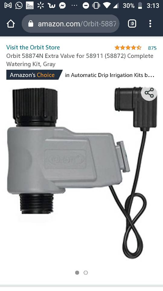

I'm guessing they wouldn't work if flooded. They're meant to be mounted on a hose bib.

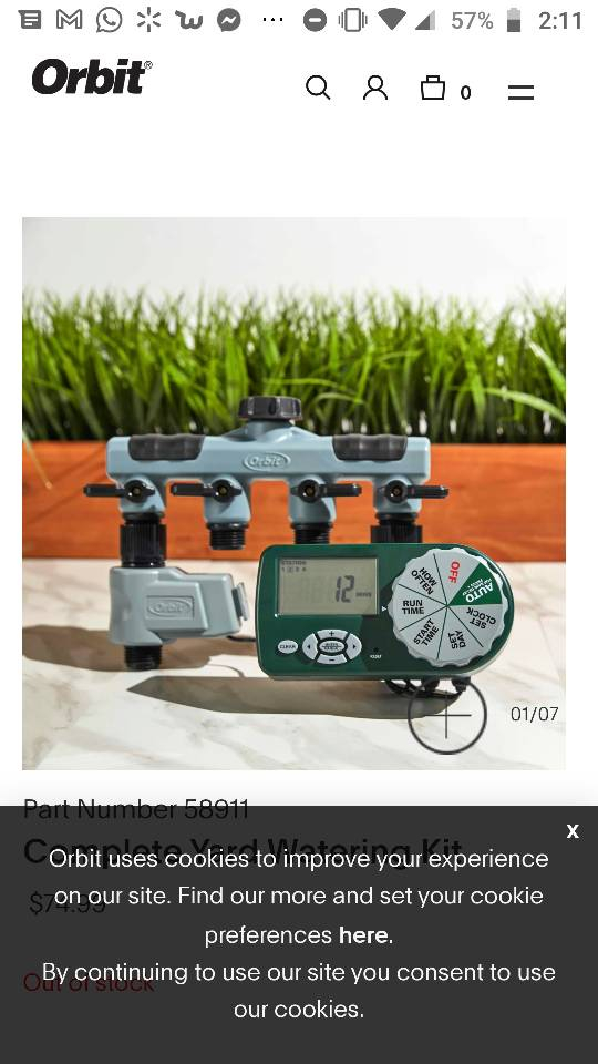

No reason you couldn't put several of the controllers in a space off of a Y or multiple Y's or T's. The clocks are very accurate. I've had mine set to go 5 minutes before I leave for work. It's kept time for years.
Another bonus of battery operated:
It's not affected by power outages.
I think they might be okay, but they shouldn't be too difficult to water proof if there was some need to go this route vs "real" irrigation valves. (They make DC irrigation controllers and DC irrigation valves. Real valves intended to be hard piped) One of my hobbies has been RC vehicles for many years. Most of it is waterproof these days, but it didn't use to be. I had lots of practice waterproofing various sensitive electronics. I'd almost be willing to take one for the team and submerge one of my orbit solenoid valves and see what happens to it.
I also don't see why you couldn't have them mounted above ground with a cover to hide them.
Mine's been mounted on my hose bid every spring, summer and fall for years. Completely exposed to the weather. However, I would not put it in a pit that could fill up with water.
   / Shuttle Valve For Lawn Sprinkler System? #24
I don't think the timer would like it, but I really think the valves would be fine.
Remember the one I'm advocating for is modular and separated. If you could lengthen the wires enough to mount your timer in one location but the valves in a box I think it would be fine.
But again, at that point, I'm not sure why one wouldn't just be using DC valves and controllers made to be used in that manner. Unless it's being done with water hoses.
