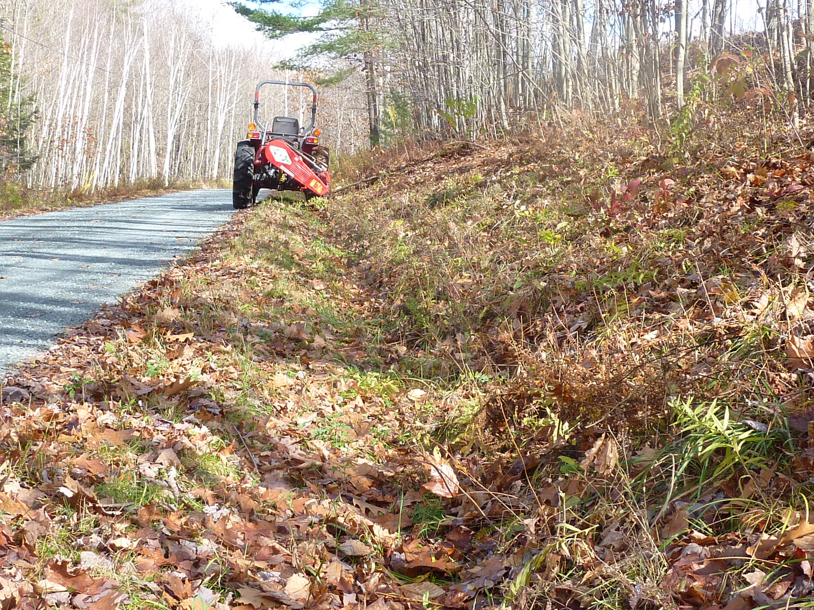

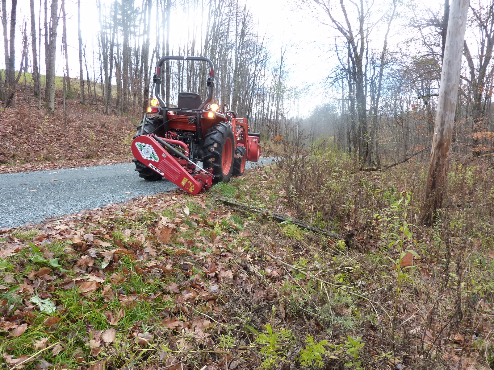

I have one of these on my L3010. Call Ken Sweet with any questions he is a super helpful guy and he has parts in stock. I see the price has more than doubled since I bought mine 15 years ago. Made in Italy but very good quality.
New 394-7 Ft Superior Double Action Sickle Mower.Zone.3
gg
   / Sickle mower for Kubota L 3200 #4
Welcome to TBN
gg
Gordon, that is a really nice looking unit.. I have one stretch of road, I would sure like to have that to use. Maybe I could just come up to vermont and borrow that for a bit in the fall?:D
