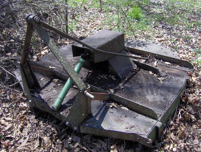

I use an old /dull 5' JD on my JD 790 (27 HP), works fine for heavy grass & weeds, haven't had it in "brush" yet. I need to do some work on it & sharpen it up before next year. It was $00, BTW! ~~ grnspot110
And that's 24 PTO HP...ran a 60" cutter behind my 790 for 5 or 6 years....worked fine.
Before I got the 790, I had a 16.5 PTO HP tractor...that same 60" cutter worked good with that tractor too, although I'd take partial width passes on the really thick brush.
