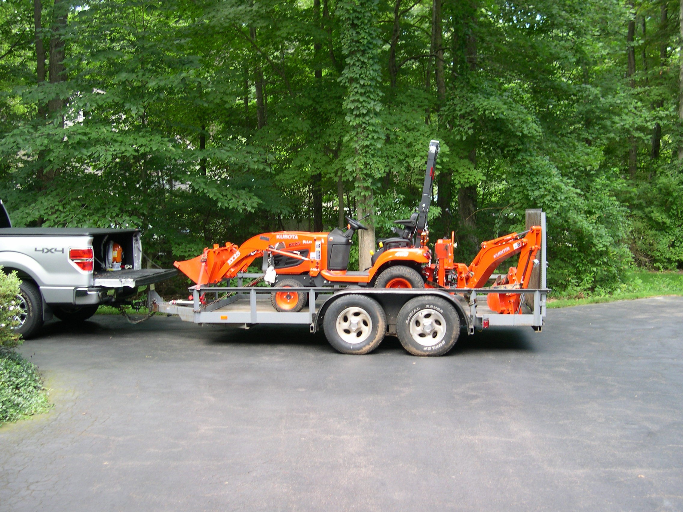

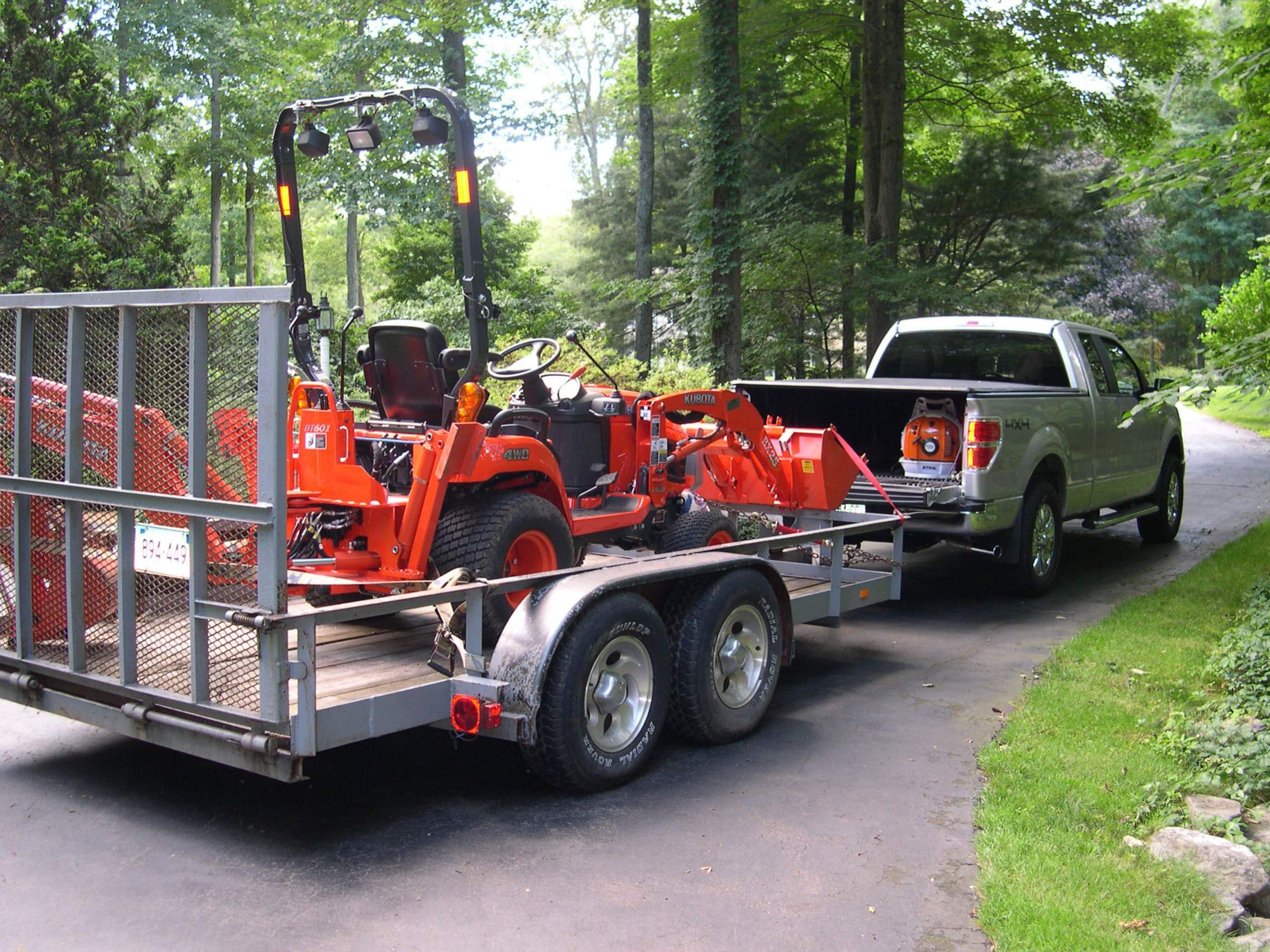

Here's mine on a tandem axle 14' trailer. Bought it when I owned a BX1860. It works, but I'd recommend a 16 footer or bigger for sure. Won't have to hang the bucket off the front end and maybe can load another implement in front or back if you need to.

Many thanks guys. Really appreciate the pics and suggestions
