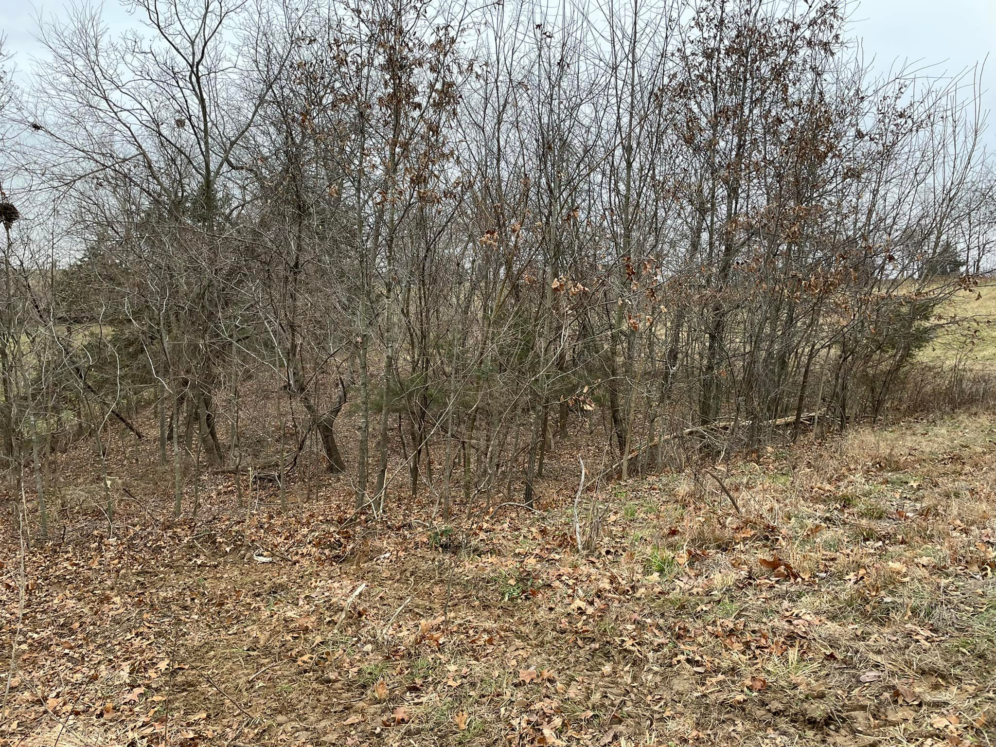

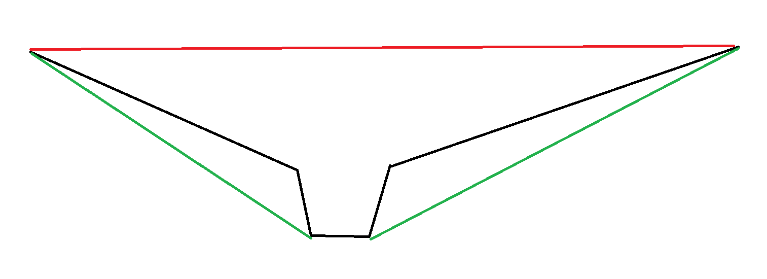

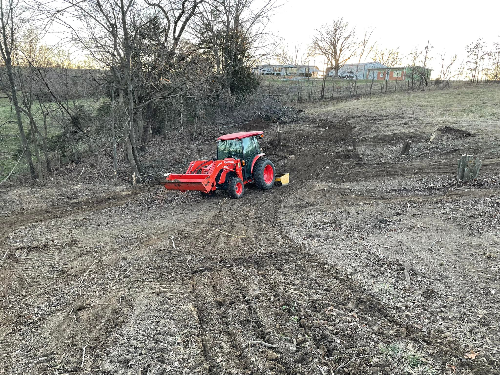

I have a small pasture that I want to build a small pond in so I don't have to run 200ft of hose to fill up a stock tank all the time. I've cleared out the area pretty well that I'm to the point I'm ready to start actually moving dirt. My question is that there's a ditch running through there at the moment that I can't cross with the tractor. In the image below the black line is a representation cross section of the current ground level and the red line is where the dam will be. Is it ok for me to fill the ditch in and build the dam on top of that or should I dig the area around the ditch down to the green line to get to "ditch level" before I start building the dam? The ditch is 4' wide and 3' deep. It would be a lot easier to just fill it in but I'm wondering if that will just create a weak spot in the dam for water to leak through. This will only be a 1/4 acre or so in size. Just want something to hold water for cattle.
   / Small Pond Build #2
Typically need to core the dam below the current ground level then compact back in with good clay to prevent leakage where the new earth meets existing.
   / Small Pond Build #3
A 1/4 acre is not a small pond, if it's more than a few feet deep. What's down stream if your dam were to fail? If nothing, why not take the easy route and see if it's good enough, (simply damming up the existing ditch).
   / Small Pond Build #4
I agree with jk96, and clay core is needed.
   / Small Pond Build #5
Because it it fails you can't fix it with a tractor.

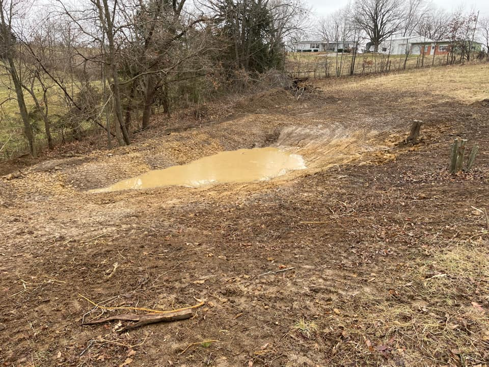

Update: It won't be near a 1/4 acre in size but I think it will serve its purpose in holding water for some cows to drink in the summer. Dug down fairly deep to get into the clay and packed it all down as best as I could with my tractor. Got some rain the other day and it's already holding over a 12" of water.
   / Small Pond Build #8
You might get lucky and it holds water! I made one of similar size and fashion trying to do my best working with the clay I encountered, and it always has some water in it, and will fill up and overflow in very wet conditions...but steadily drains several feet down over the course of a couple weeks. The summer dry period will be it's test? If nothing else, mine functions as a silt collection point/wetland area prior to it turning into the creek.
   / Small Pond Build #9
Years ago a fellow I worked with had a pretty big pond built. It would fill quickly but would also drain quickly. His solution, one that was recommended to him, was to scatter bentonite on the surface. He bought a lot of bentonite in bags, the same stuff well drillers use to seal around well casings here in the PNW. He then went out in a row boat and scattered the stuff on the surface. It sank and sealed the bottom. It worked well, his pond retained water much longer.
