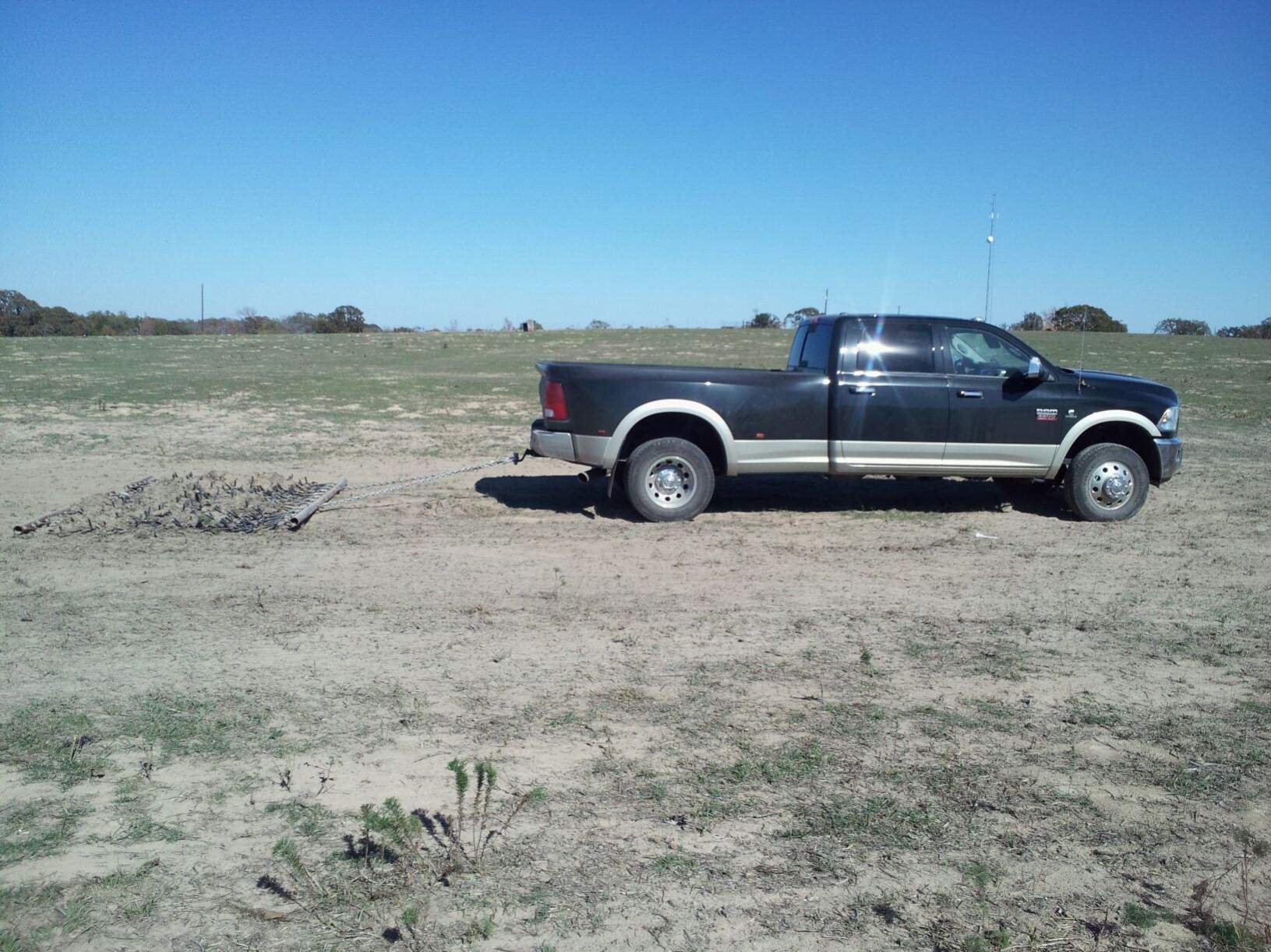

I use a heavy 12ft drag you can turn it over several different ways to get a more aggressive side or less. I have had wild hog problems and found if I run the 74in Tiller across the fast and not deep to bust up the grass clods the drag is able to bust it up alot better. This photo is last year when we hadnt had any rain for over 100 days I went in with just the drag on the hog roots and gopher mounds on the flat side of drag...
You sure got a funny looking tractor.
   / Smoothing out my rough pasture #12
Yeah all I had there at the time was the open cab tractor and it was way to dusty out there,so the dodge filled in:D
