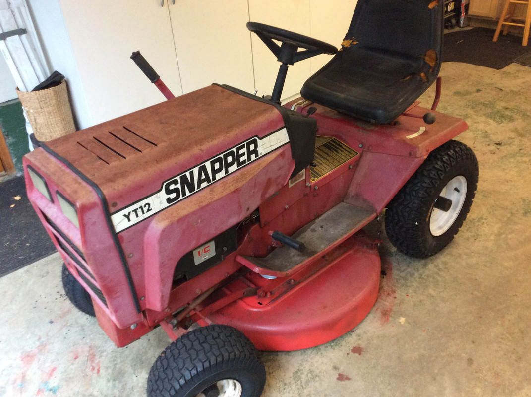

Can anyone help me locate a part for my yt12 tractor? I need the button that fits in the middle of the drive disc. If I can’t get that, I guess the next higher assembly is the entire drive disc. Looked online, and all I can find is the rubber lined driven disc, not the drive disc that is spun by the engine.
Drive Disc, Rear Axle Components - Snapper LT12 Parts Manual [Page 6]
Try and post a link to the manual here. I need #26. If I can’t get that, I guess #23.
Thank you everyone.
   / Snapper YT12 can稚 find parts #2
Briggs 7051418YP may be correct. Now to find it.

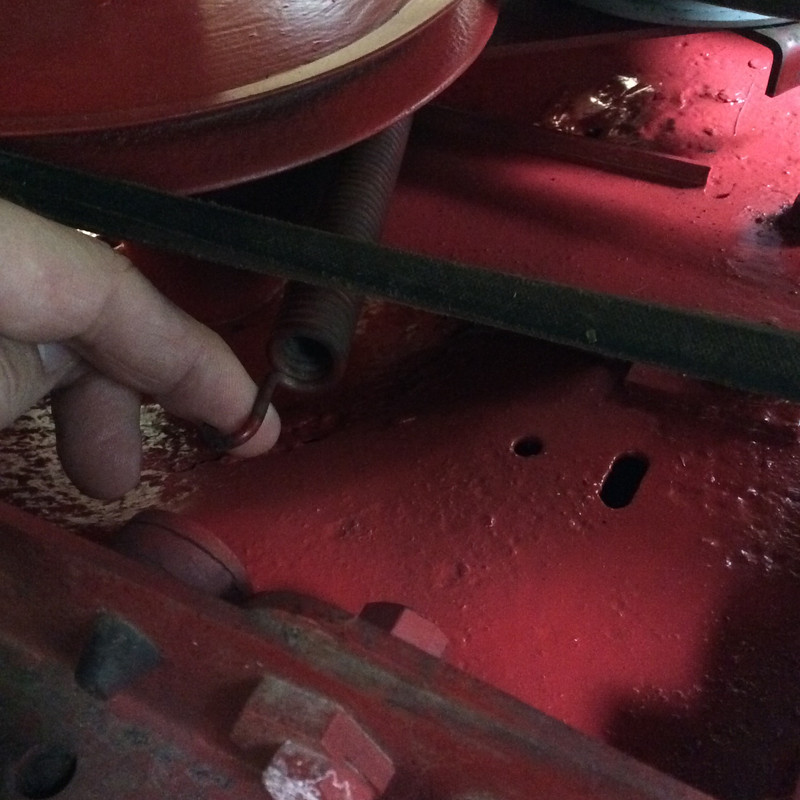

I am getting this snapper yt12 back together and can’t figure out where the mower deck belt tensioner hooks up. This is a 33” deck.
I have it hooked to bracket on the tensioner correctly I think, but I don’t know where on the deck the other end hooks to provide the correct tension.
