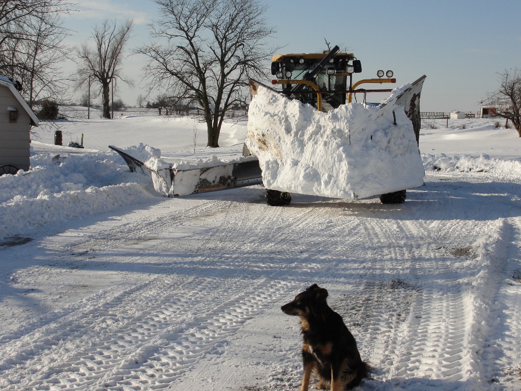

I'm with ya Pilgrim. I run a Road Grader. I've tried everything, including pouring water on the Plow to create a layer of ice that the snow would slide off of. Yeah right....

<img src="http://www.tractorbynet.com/forums/attachment.php?attachmentid=410953"/>
Looks like your layer of ice is too thick :)
