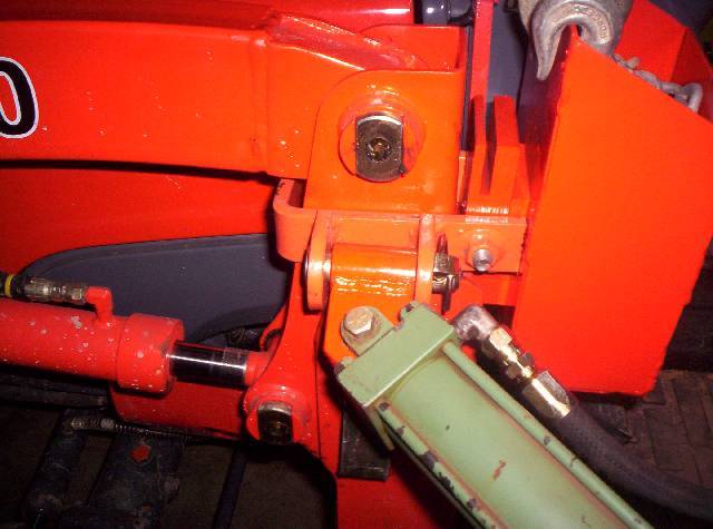

I built this four or five years ago after I had my old B7200 in the ditch three times trying to get the snow back from the edge of the driveway. Ive just adapted it to my new tractor. It never cost me a cent, I scrounged all the parts and pieces from old junk at work.
Steve

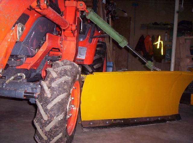

   / Snow wing
#2
Another view

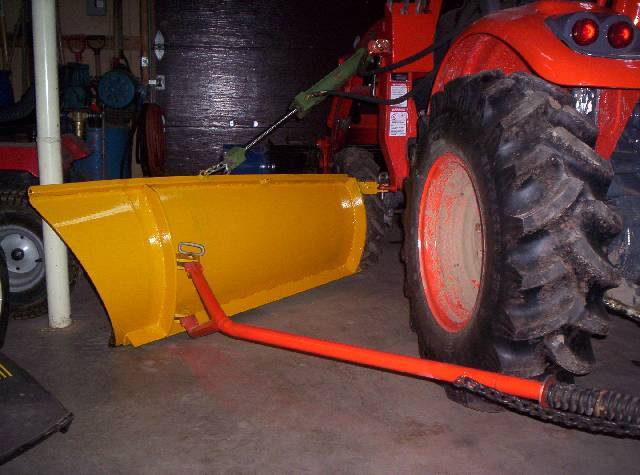

   / Snow wing
Not sure how this pin will stand up yet. I modified it a bit from the last setup. The springs are out of reclining chairs.
   / Snow wing
This bracket is just a clamp I made. It doubles to hold the chain box as well.

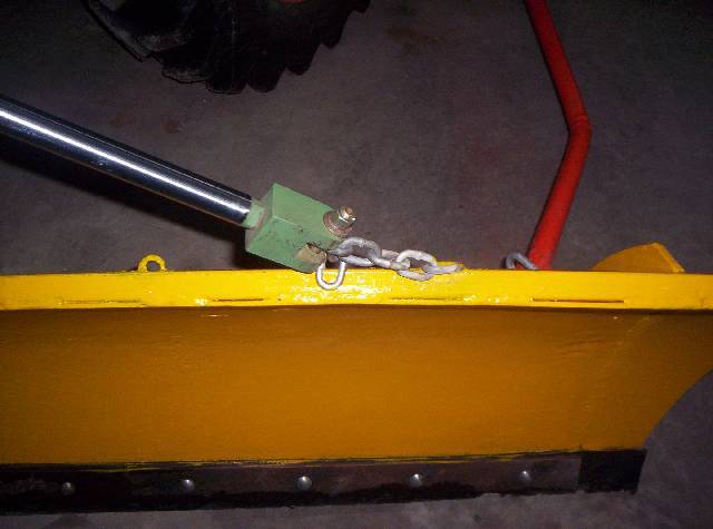

   / Snow wing
I used a piece of chain so that I could have a little bit of float when plowing as there is no float position with the rear remote valve.

Steve, great job!!!! /forums/images/graemlins/smile.gif Please let us know how it works for you, and of course photos! Again, GREAT job!
   / Snow wing
It works great, I've had it on my previous tractor for four or five years.
Steve
   / Snow wing #9
Great Idea!
Do you have a shot of how it hooks to the rear of the tractor? And maybe one with it up in the "stowed" position?

It looks great. /forums/images/graemlins/cool.gif I always enjoy seeing home designed items workout like yours has. I think that the float chain would bother me, but I don't know how I would change it right off. Some engineering would have to be involved it that. /forums/images/graemlins/grin.gif
