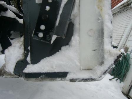

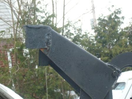

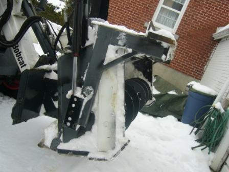

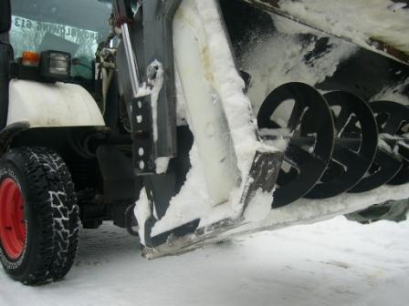

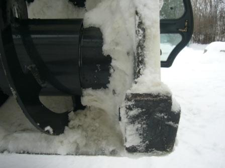

There are several options that i can think of.
Raise your shoes so the blower is just off the ground.
Weld on (i will post pics in a couple of days) shoe on the front edges of the blower. These will help it ride up over obstacles before the cutting edge hits. I did it and it works well.
Install a poly urethane cutting edge. I did this as well. i used 1" urethane for the cutting edge and routered out a 1/4" groove in it so i could use metal plate as a continous washer. It worked ok but did not clean nearing as well as the steel edge. I will post a picture of that when i find it.

Here are a couple of shots. I will clean it off in a few days and take some clearer ones.
