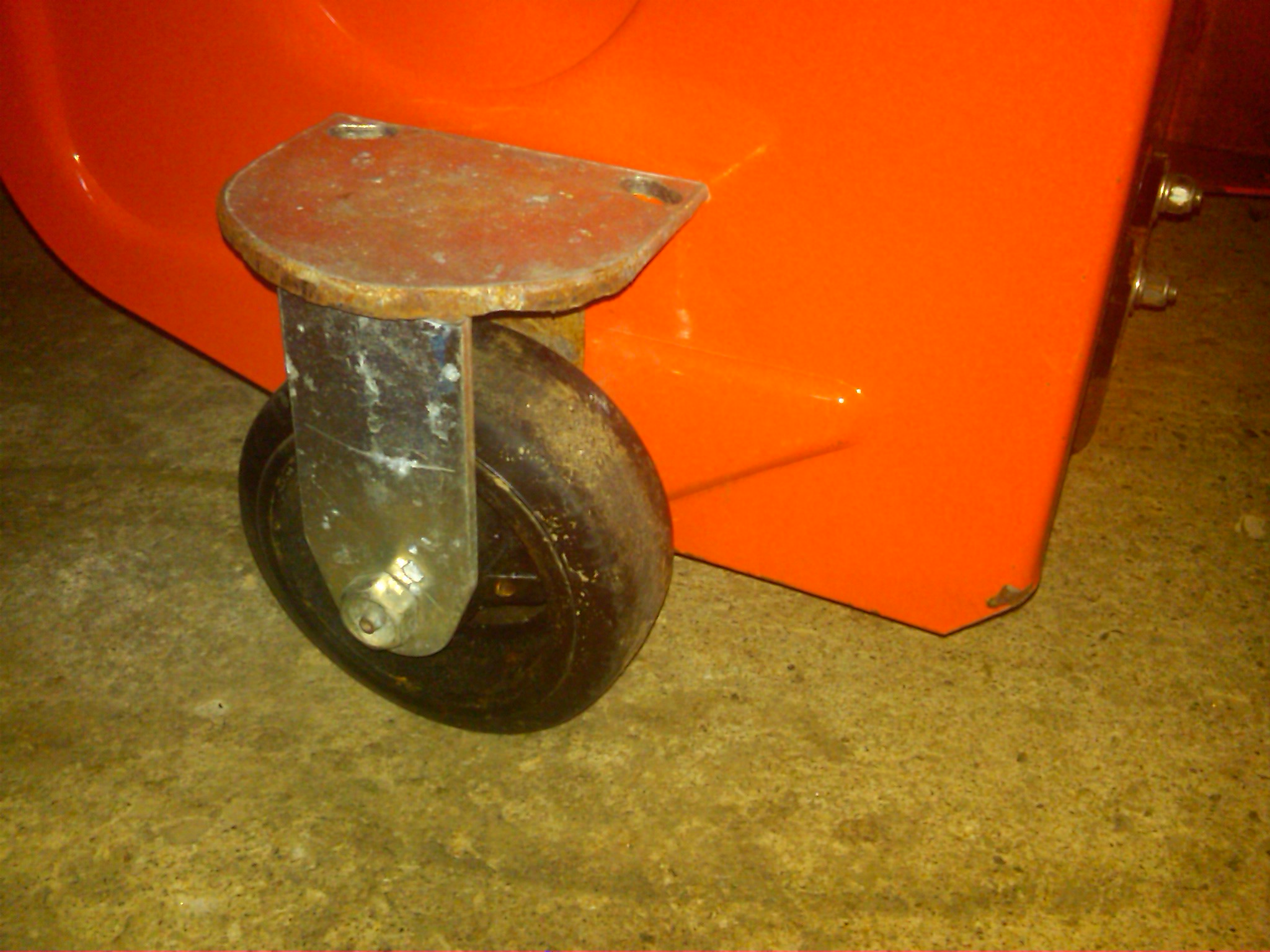

Do you have a pic of the wheels?
You will certainly wear your edge bar on the blower. You should adjust the skid plates so that edge bar is a bit above the surface you are blowing. When it snows, ice etc will also lift the blower above that point. I replaced my skid plates with wheels to get around the marking issue.

   / Snowblower Height #6
I used a set of fixed wheel casters.
