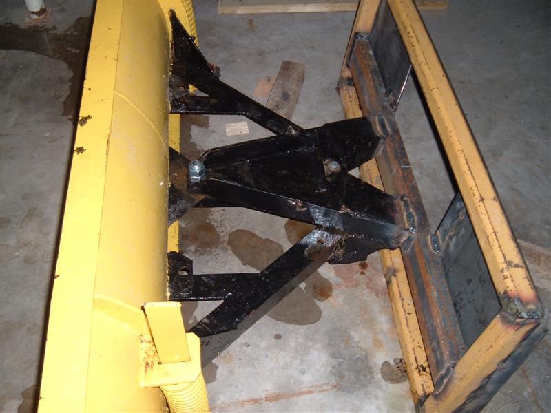

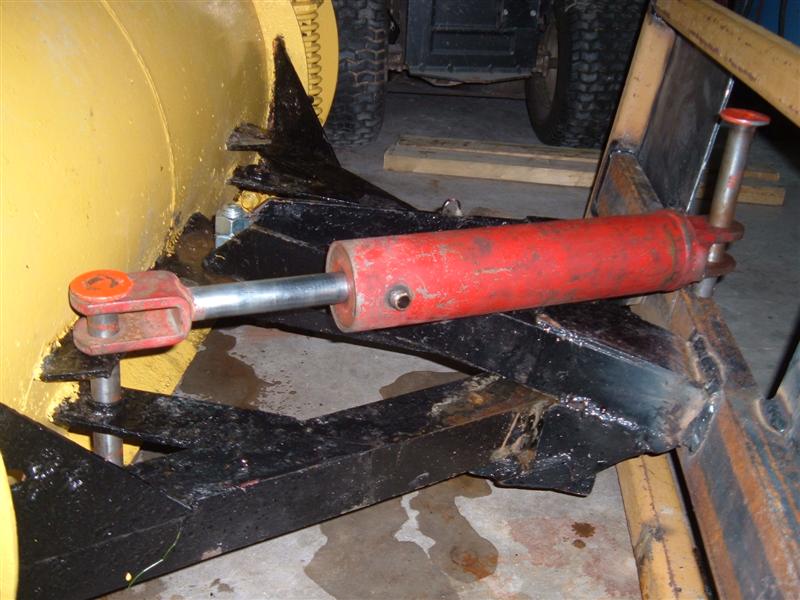

I'm not quite done yet, but here are a couple of shots of how I adapted an old plow to my QA. I think I'm going to add the cylinder as shown. The plow didn't have cylinders on it when I bought it. I had a couple of old cylinders kicking around so I thought I'd use one of them, it's a bit of overkill, but hey, its free.
Steve

It's not clear to me how the plow angles. It looks like the braces are welded to the plow.
jmf
