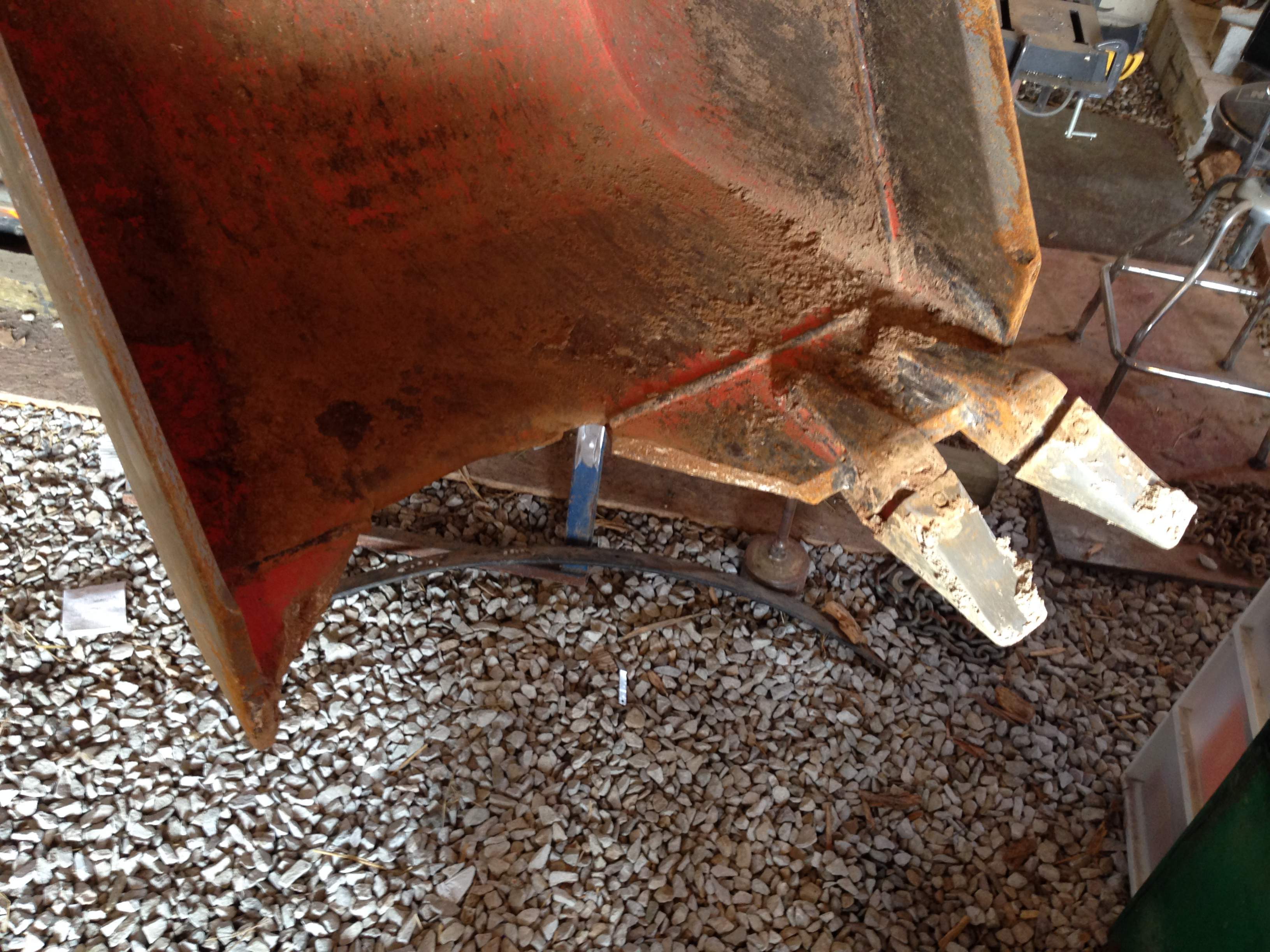

I've welded the crap out of the original bucket. Teeth and cutting edge have broke several times. This last time it broke 3 teeth/shanks off. So I called kubota insurance and they gave me a claim number that I gave my dealer and they ordered a new one. Also, I needed a bucket now so they told me to weld the old one up best I could to get by, but that they needed it for ins adjuster....And said I could get it back when they are done with it, which is good because its lasted digging through the frozen tundra we have.

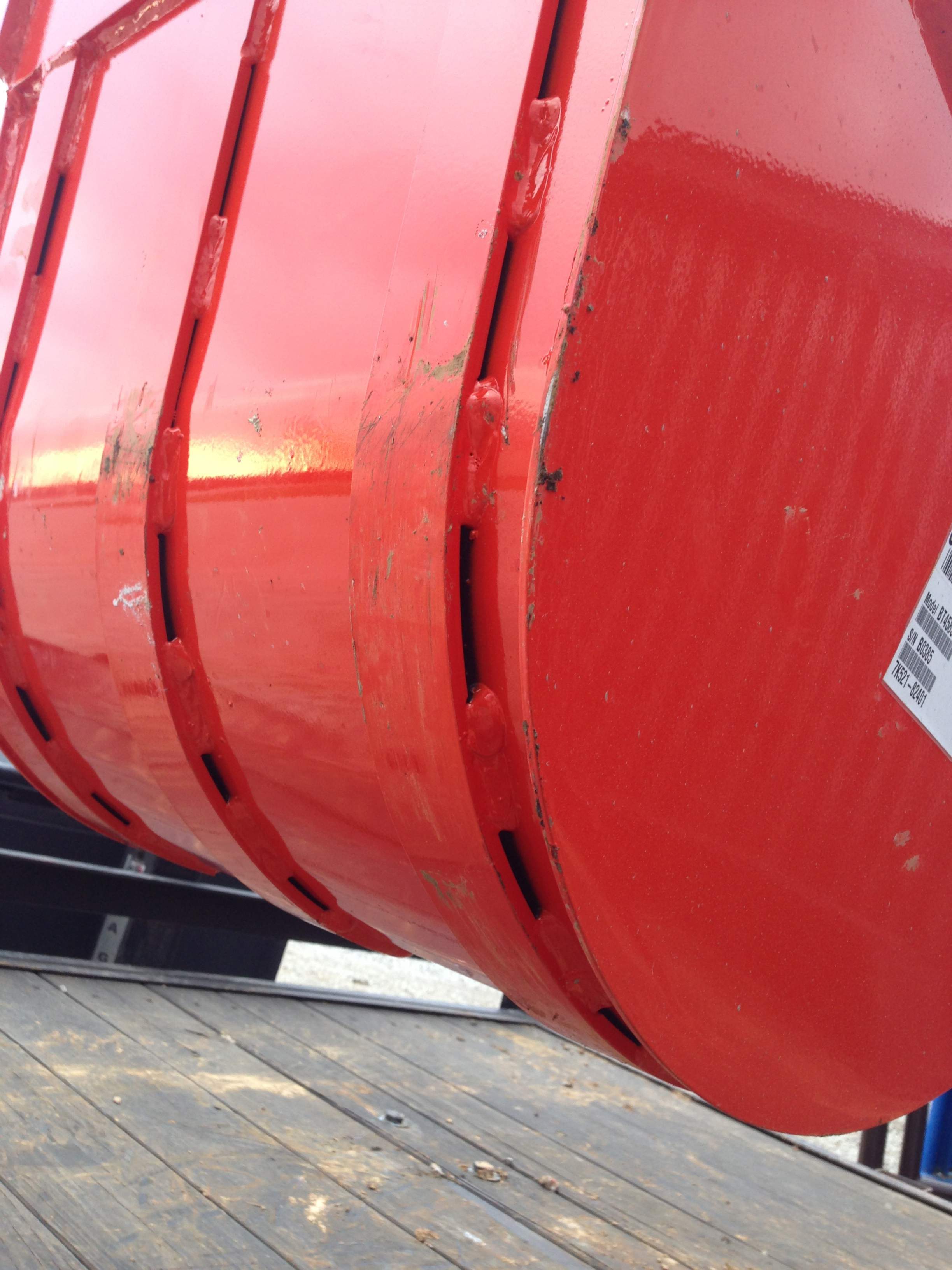

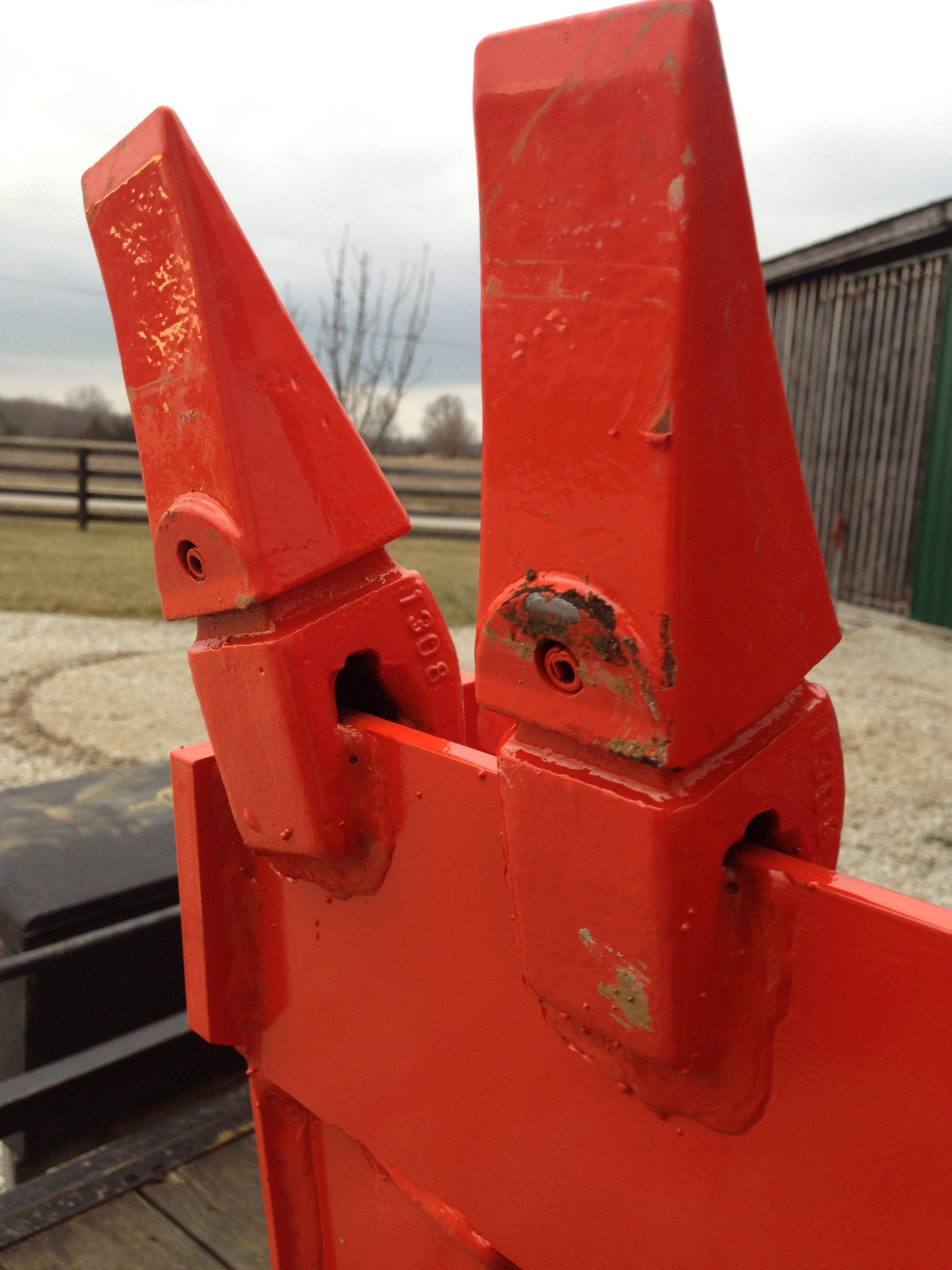

So I need this new one to be stronger. It seems they skimped on the build of it, the shanks are not welded to front of cutting edge, the supports that run the length of bucket are not welded continuously. IMG_0653.jpgIMG_0654.jpgIMG_0589.jpgIMG_0588.jpg

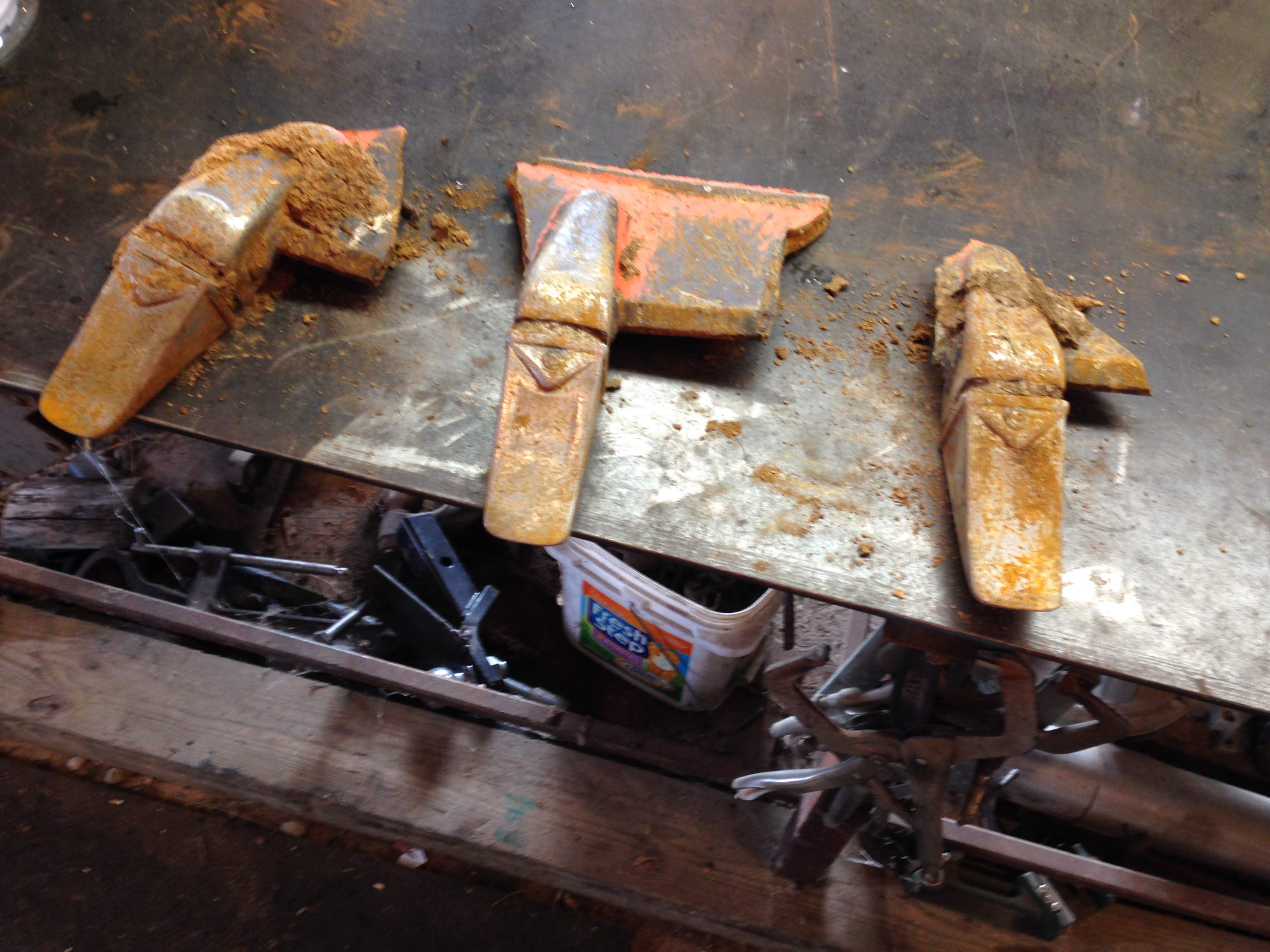

the tooth on the right is the one that broke off first, then the the middle one that broke off again.

The 3 broke teeth I, the operator, broke off was from digging under a rocky footer. I assume the cutting edge had cracks in it already. After patching them back on is when I dug through the tundra with no issue.

I wonder why they didn't set the bucket teeth all the way down on the bucket lip prior to welding. It looks like that would have made them a bit stronger. I have a sneaky feeling that you will be doing some repair work to this bucket also if you keep abusing it with rocks and frozen ground.

Well you got me curious so I just went out and looked at my bucket. I think it's the same 24"? bucket you are showing. Yes, on mine the teeth are set all the way down against the bucket lip and the weld to the bucket lip is continuous...right up and around the tooth mount. Yours don't look right to me. I've used mine for years on lightly frozen ground and on lots of rocks without any problems. The M59 is such a brute for power that it continues to surprise me. We rarely run over 1500/1800 rpm. Even at an idle if I stick the BH bucket teeth under on a rock it will pick up the whole front of the tractor - guess it would rotate the entire kit and caboodle upside-down if I didn't ease up. This week the ground is finally frozen so hard that the crust just seems to explode when the bucket rotates through it. That's a signal for me to quit and do some other chores. Just because it will do it doesn't seem reason enough to stress things.
About the support strap welding - they aren't necessarily skimping; an interrupted weld is the proper way to weld two formed parts like that together. However, on mine the welds are slightly longer than on the one in your picture.
