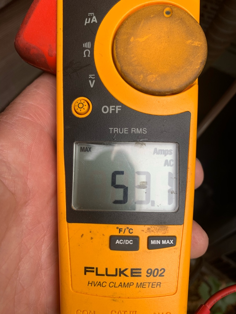

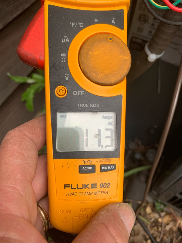

Here’s a recap of my post on the other thread. I just installed a Hyper Engineering “Sure Start” soft start device on a Goodman 3-1/2 ton heat pump. I had previously installed a 521 Hard Start kit. Here are the peak measurements from each as captured on my Fluke clamp on. I have to say that I was surprised and impressed with the outcome. I would say that the soft start is worth the $275 price tag.
To be clear, the first measurement was with the hard start kit installed.
