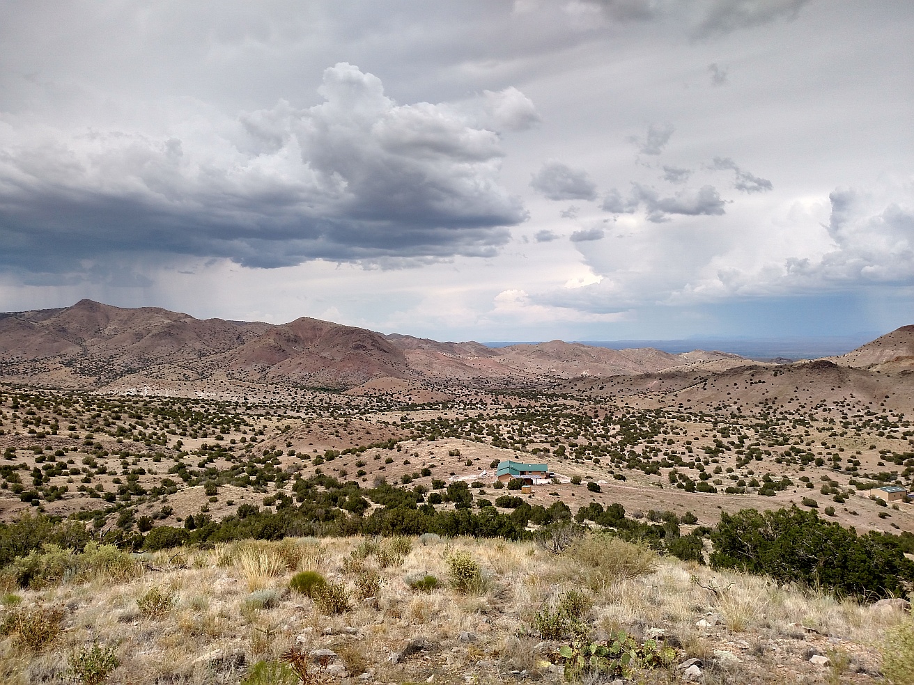

A few years ago we bought some property out in the sticks here in central New Mexico. It's ~16 miles by dirt road to the site and there are no utilities so a well, propane tank and solar was the only way to have a normal house. Nothing too difficult or interesting about putting in a well or propane tank so this is about the solar system.
My wife is an electrical engineer and I am a software developer. We love our gadgets, 24/7 internet access and watching our favorite TV shows on the big screen. This wasn't going to be minimal impact eco house. The goal was that, as best we could, life inside the house would be much like being back in civilization.

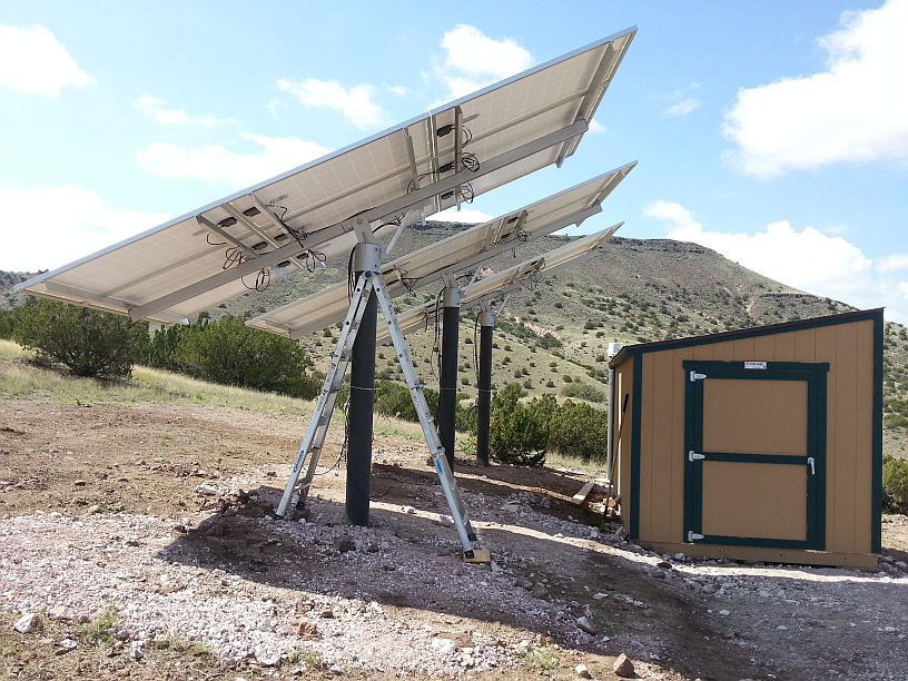

We are using 255 watt panels. There are 27 panels mounted on three poles. Total potential power from the panels is 6.9 kW. The panels are connected as 9 groups of 3 panels in series (~92V @ 8.3A) to feed the charge controllers. Power from solar systems is typcially calculated based on 6 hours of usable sunlight per day. So at winter solstice we get about 41.3 kWh a day. Just a couple years later now and the 300 watt panels are about the same price.
Panel Mounting
This is open grazing land, so we have cows wandering around, and have deer, elk, javelina and other wildlife as well so ground mounting wasn't an option. Mounting them on the roof wasn't really desired as adjusting tilt is more difficult and would require more roof penetrations. As mentioned above the panels are on poles (8" SCH40) which are buried 4' with 1.5 yards of concrete and stand 8' above ground. The DPW mount allows for 15 to 65 degree tilt.

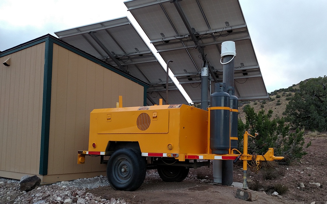

Backup Power
We have an older Kohler 7.6C61 water-cooled, four cylinder 7.5 kW generator for backup when the sun goes missing. Wasn't keep track of usage this past winter but I know it ran for 3-4 hours on 4 or 5 days. Ran it again for 4 hours a few days ago when we had heavy overcast and rain for most of the day.
Solar Power Shed
We wanted to minimize the length of the DC current runs so a we had a shed built right under the poles to hold the batteries, inverters and charge controllers. This allowed us to run a normal AC feed to the house panel via a 75' trench and conduit.
