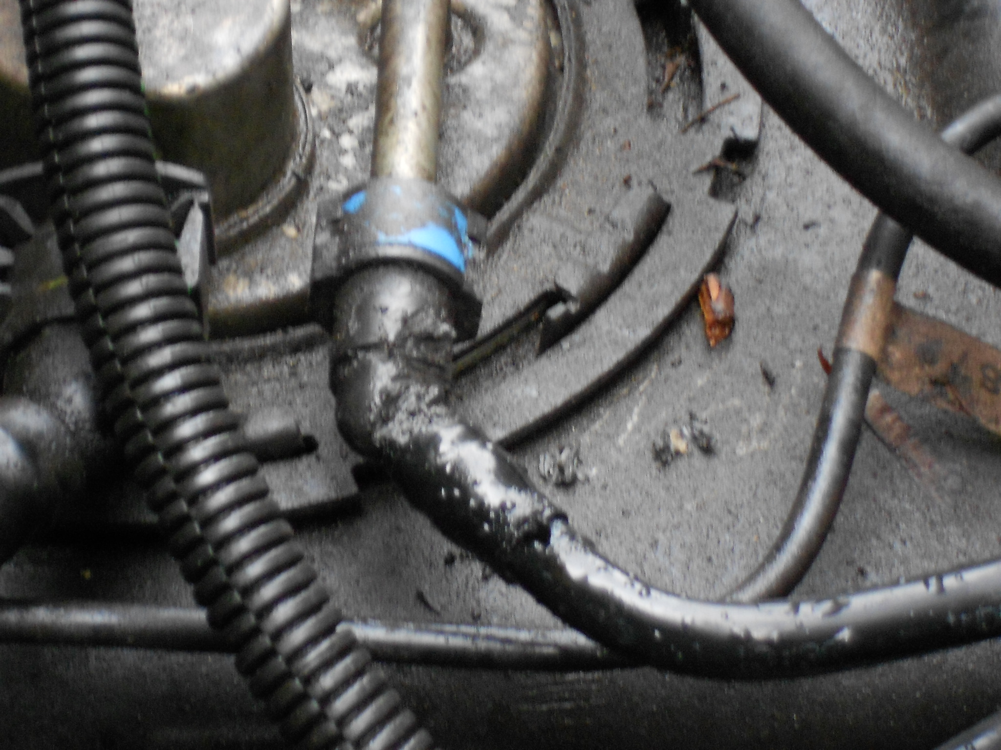

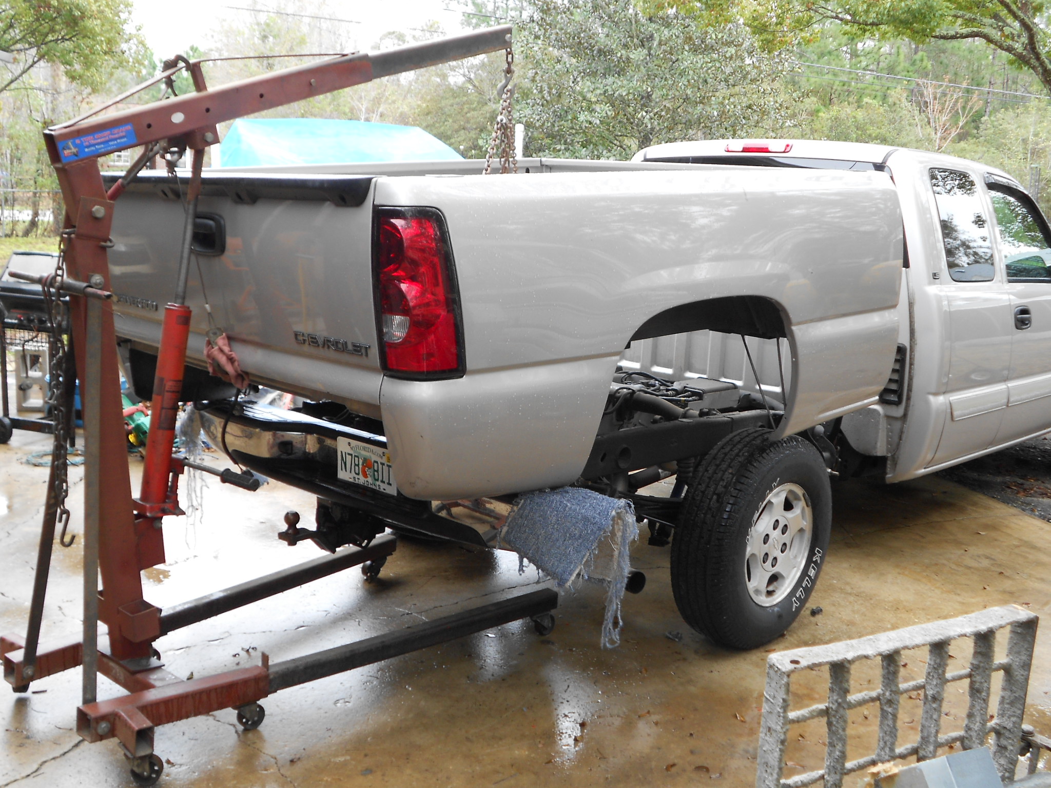

   / !@#$%^ Squirrels! #6
Had one chew the fuel line on my PU at the tank!
I was leaving my property and stopped to close a gate and smelled gas.
When I looked it was spraying onto the muffler/tail pipe.
Will shoot them on site!
