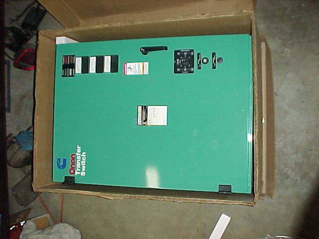

Generator and Xfer Switch (see Pic)
I guess I did overkill. I purchased a Cummins / Onan 35KW unit that runs on propane. It is a 6 cylinder 300 Cu In Ford industrial engine. I do have a 3500 sq ft house ALL Electric. I have seen my house pull just under 140 amps with heat strips on in both heat pump units and water heater going. This will never happen again as the house will never get that cold again after being without power for 7 days. This was when the generator was new and sitting on a pallet on my patio. It is now installed on slab with Auto Transfer switch. I will test it again this winter in cold weather just to see how many amps it takes to maintain.
I do have a deal for you JoeW. I have a NEW IN THE BOX Cummins / Onan Auto Transfer Switch, 225 amp, 3 pole, single phase, battery charger, exercise cycle timer, gauge package. In other words, loaded. I have 300 amp utility service which required a bigger switch. I bought the generator and 225 amp switch as a package. My dealer said his COST on the switch was $2600.00. I will take $1300.00 for it + shipping. This is a steal if you or anyone else needs one. Check out the picture!
